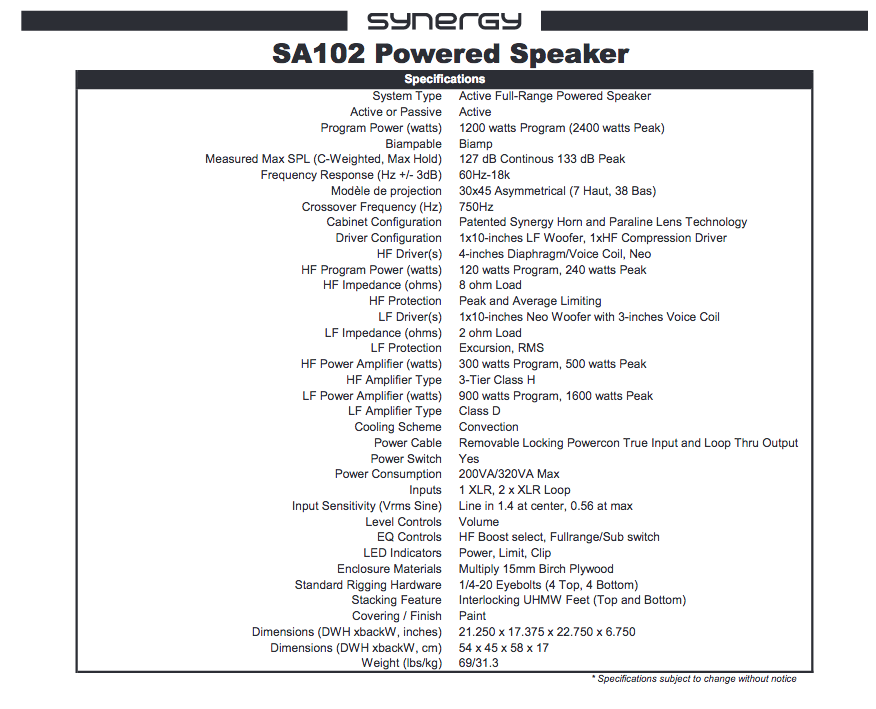

Hi all,
I see the Yorkville SA-102 is has just 1x10-inches LF Woofer, 1xHF Compression Driver.
I am interested in a Synergy horn of this type, that uses 2 transducers.
How are the drivers loaded in this type of synergy?
What are the characteristics of this type of synergy?
What are the merits and downfalls?
Please point me to a DIY synergy post of this type,
Thank you,

The Yorkville SA-102 multiple entry horn (MEH) uses a 3” voice coil 10” woofer offset horn loaded through two small ports with two additional bass reflex ports, and a 4” diaphragm HF driver on a Paraline device both loaded to a single conical expansion horn.
Driver loading is shown in their video:
Synergy Array Series - SA102 & SA115S - YouTube
The Paraline throat adaptor helps create a very defined 30 degree HF horizontal coverage pattern, and improves the low frequency response of the HF driver on the vertically asymmetrical conical horn (7 degree up, 38 degree down), allowing a lower HF crossover than a conical horn of the same dimensions would support.
The Paraline does also create more ragged narrow peaks and dips in frequency response than a standard conical horn would have.
As the dispersion pattern requires three units to cover the typical 90 degrees pattern most venues require, and Paraline devices are rather difficult to build and have rough response, you probably won’t find similar MEH DIY projects, though my lower output 90x40 two-way SynTripP

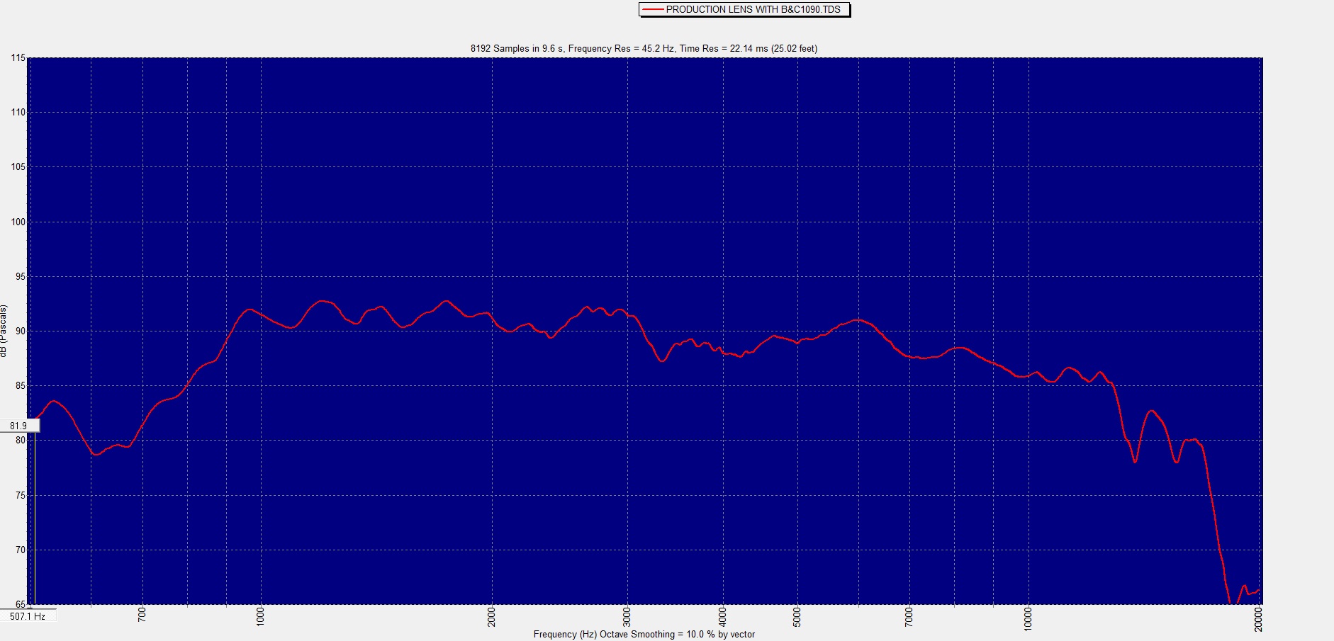

Hi Mrscy
Art has done a good job of describing the SA102, the video images he posted are actually of the 3-way SA153 cabinet but they are close enough to describe the arrangement of the components. Marketing just used the same animation in both videos. The one comment I will add that was made by Art, and I have seen mentioned by several other people, is the "rough" response of a Para-line lens. These devices are very tricky to design and manufacture. One is dealing with very high tolerances due to the very small wavelengths involved. I have seen a lot of DIY lens hacked out of plywood with a jigsaw and slapped together and then comments made of how badly they measure. These devices demand accuracy and attention to detail. And just like anything there are tricks to getting them to measure/perform better that are not going to be openly discussed on public forums for everyone to see. I've been designing these devices for more years than I can remember ever since Tom drew me a rough sketch of his idea on a napkin one night while we were having wings and beer. It's has been a constantly improving process of the design and manufacturing process and the results can be just as "smooth" as a standard conical horn. Attached is the RAW SPL response of the lens in the new SA102. It has a couple new features that the lens in the SA153 doesn't have. As you can see it's very smooth for a high output device. There are PDF's on line of our VTC products which use paraline lens as well that show similar results. I'm by no means trying to discourage you from trying to make your own I'm just saying you've picked a tough one that demands a lot to get right. All the best and good luck.

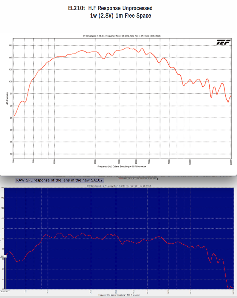

Art has done a good job of describing the SA102, the video images he posted are actually of the 3-way SA153 cabinet but they are close enough to describe the arrangement of the components. Marketing just used the same animation in both videos. Attached is the RAW SPL response of the lens in the new SA102. It has a couple new features that the lens in the SA153 doesn't have. As you can see it's very smooth for a high output device.
Todd,
Thanks for the correction. The location and relative size of the ports and the co-ax HF driver should have tipped me off, but "close enough for rock and roll" 😉
After watching VTC videos, built 10 Paralines for back in 2008, understand the importance of attention to the small details in these devices lacking in many DIY attempts.
It does appear your SA102 has smoother response than the DSL Paralines, and an improvement over the VTC lines, good work!

One interesting thing about the SA102 versus the VTC boxes and the Danley Genesis horns with the early Paraline lens, is that the SA120 appears to use a BMS coaxial. IIRC, some of the Jericho horns use a BMS coax too.
This begs the question: I wonder if the high frequency output is improved by delaying the mid frequency output?
IE, in the BMS coax, there's two diaphragms and one of them leads the other one by a few centimeters. Would be interesting to see if that yields an improvement.
My hunch is that the answer is "yes", since the Paraline lens is basically just a conical horn that's been squashed. And we've seen with the Unity horn, that putting the mids ahead of the tweeter makes everything easier.
Also, what I describe is in the original Paraline patent, but AFAIK, nothing commercial has every implemented that:

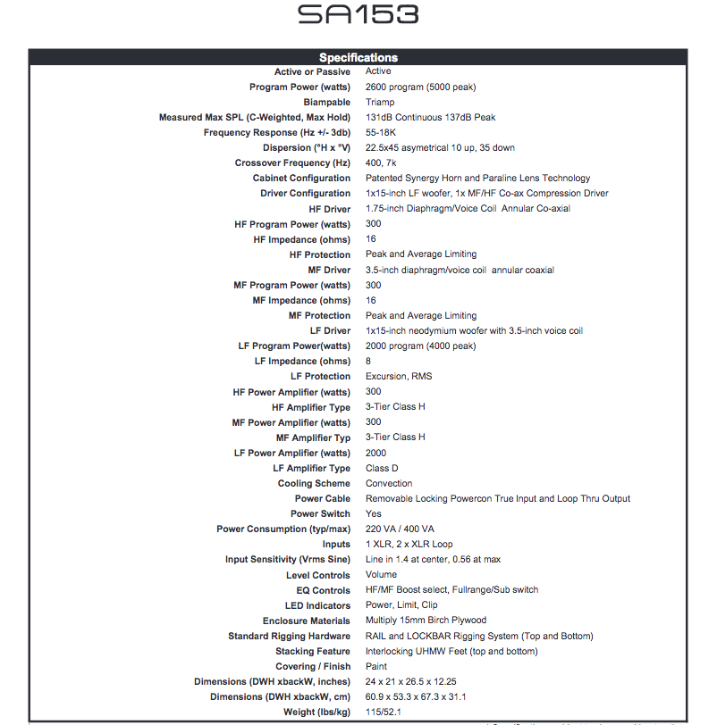

The SA102 uses a 4" diaphragm 1.4" exit B&C DE1090TN.
I had thought the SA102 video depicted the SA102, but as Todd Michael pointed out, the video images I posted were actually of the 3-way SA153, which uses a co-ax mid-high driver.
As the SA153 is tri-amped (400Hz, 7kHz crossover frequencies), I would assume time/phase compensation is used in it's processing to align all three components.
Art
