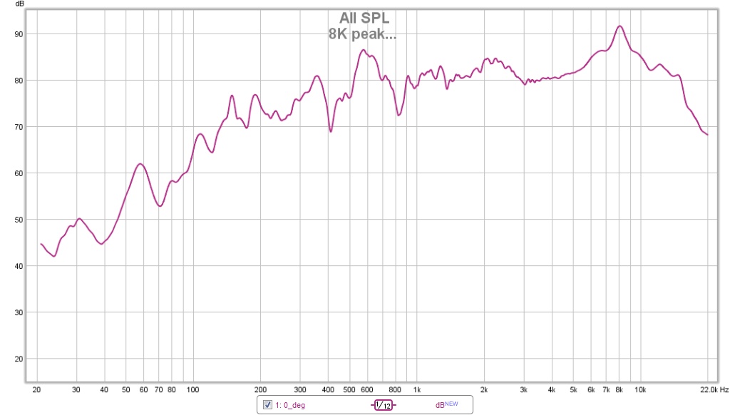

The 4FE32 will have more beaming. If you plan to use it in a FAST/WAW, the 3FE22 is better as there is no need to go below 300Hz where it makes a difference if you have the 4FE32. I do recall Buildmesomething measured the 4FE35 in a Nautaloss and it had a strange 8kHz peak. Certainly, the Nautaloss could not have been the cause of that.
416034d1398946535-nautaloss-ref-monitor-nautaloss_spl-jpg
The Nautaloss Ref Monitor
If the 4FE32 is anything like the 35, watch out for that 8kHz peak. The 3FE22 and 3FE25 are quite flat and sound great. I like both. I have not personally tried any of the 4FExx's yet.

And yes, there is a nasty peak at 8khz. I measured it as well.

I used both drivers and for me there is no doubt...4fe32 is way bettter. 3fe22 gets terrible treble with higher volumes, while 4” stays stable. And the 8k peak is only noticable with 0 deg,,,moving 5 deg off axis driver is flat.

I decided to go for the Neo version of the 3Fe's....the 22's, just to match the 4Fe Neo array. Not sure I can detect any difference. I have certainly not been troubles by an 8khz peak and have these things pointing right at me.
