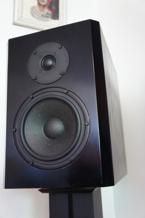

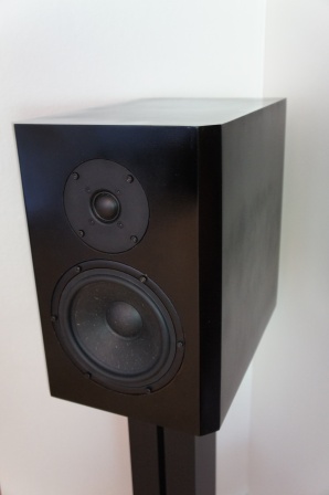

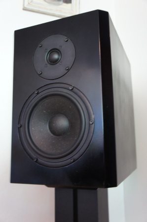

Hi everyone,
I have written a small review on the Zaph Audio ZA-SR71 loudspeaker design. The ZA-SR71 is a popular and a well-regarded design among the DIY community and rightfully so.
The ZA-SR71 is both technically well-designed and a good performer sonically, paired with a high performance/price ratio.
I have personally built and used the ZA-SR71 for some years now and I listen to them from time to time and I still enjoy them. I’ve used the ZA-SR71 as a sort of DIY reference loudspeaker and sometimes used it to benchmark other loudspeaker designs against.
I’ve made a small modification to the original ZA-SR71 regarding the enclosure volume. I found the 14 liter enclosure too small for the Seas ER18RNX mid-woofer and I increased the volume to 18 liters. Besides that, I’ve used exactly the same cross-over and the same cross-over components sold by Madisound in the ZA-SR71 kit.
In my review I’ve measured the driver units individually and the measurements includes, T-S parameters, distortion, impedance and frequency measurements as well as measurements for the finished design.
I’ve also made some cross-over simulation based on my own measurements to show some effect of changing the listening distance to the loudspeaker as well as showing the driver units cross-over slopes and phase behavior etc.
I think John Krutke (Zaph Audio) made a very nice DIY loudspeaker design with the ZA-SR71 and I just want to say that this review is my personal opinion and is based on my own sound preferences, measurements and design views and shouldn’t be consider as criticism to another loudspeaker designers design choices.
Please visit Zaph Audio website for the full ZA-SR71 design documentation regarding cross-over schematics, tuning options and the designer’s comments to the ZA-SR71.
For the full review see:
ZaphAudio ZA-SR71 Review!
SEAS H1456 ER18RNX Measurements!
SEAS H1189 27TDFC Measurements!
Regards
/Göran

Thank you samadhi!
I did try the 14 liter option first and didn't like it. I've seen other people using a 16 liter enclosure for the ZA-SR71, but 18 liter and a lower port-tuning fitted my preferences better.
You can always build the enclosure larger and stuff it with something solid if you want to try a smaller enclosure tuning.
Regards
/Göran

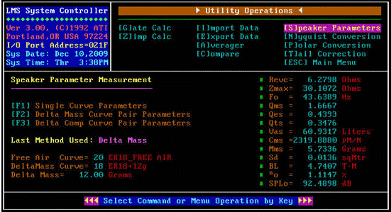

ER18RNX T/S measured with Delta Mass Method.
Hi Michael Chua,
I see that you got a Mms of about 5.7grams, which seems to be very low. The Mms for the ER18 is around 14grams +/- 1gram.
I think you should try to measure them again with a higher "Delta Mass". A "Delta Mass" of 12gram is to small as added weight. It should be at least 125-150% of the actual Mms, sometimes more.

Michael, there is a wide discrepancy between your Vas measurement and everyone else's. Gornir get between ~ 27 - 36; Zaph, 26.3, my new ones were 36L, the data sheet has 32L
Pete, that's what LMS calculated. I was shocked by the discrepancy. VAS of 61 Liters is almost double the manufacturer's specs.
This is not uncommon. I've measured other drivers with vastly different VAS from specs. Maybe the manufacturers decided to make changes (like a more compliant surround) and forgot to redo their measurements.
I usually start with 30 grams but with the ER18, it was too much. With 12 grams, the resonance frq already shifted from 44Hz to 25Hz. LMS recommends a one octave shift for accuracy. 12 grams is slightly more than 100% of 5.7 grams.

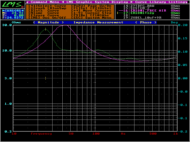

Hi Michael,
I've used both 19gr and 28gr added weight in the different measurements I've done on the ER18 and they both worked fine.
When I look at your impedance plots I can see that when you add the 12gr weight you get a wobbly impedance curve. This often indicates that the added weight has bounced around the cone or/and the driver is placed on a soft surface. Ideally the driver should be clamped to a solid surface, but that's just me guessing since I'm not familiar with your measurement setup.😉
I have not used LMS for T/S measurements, but I’ve used e.g. Clio and SoundEasy but none of them is as accurate as the WT3 tester which is the one I use today. Even though it’s a cheap tool it’s very fast, very accurate and consistent and I’ve measured tons of drivers with it without issues.
Seas 12cm drivers have larger Mms than 5.7gr so I think you should try to re-test them again.

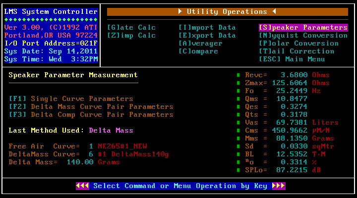

It's pretty straightforward with LMS. No calculation required. Basically, the steps are:
1) Impedance Sweep (Free Air)
2) Impedance Sweep with weight added. Weight should shift Fs about one octave
3) Input Added Weight
4) Input Sd
and LMS will generate T/S.
There's no Input for Mms. All the information is generated by LMS based on the 2 graphs. It'll be interesting to see what comes out when I redo the measurements.

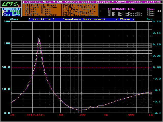

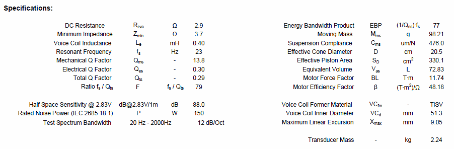

I've attached measurements for the VIFA NE265W-4 for comparison. With this model, my measurements are very close to Vifa's.
The first graph is of the two units (free air). Looks match to me.
Second graph is with 140 grams added.
Third is T/S (LMS)
Fourth is from Vifa datasheet.
