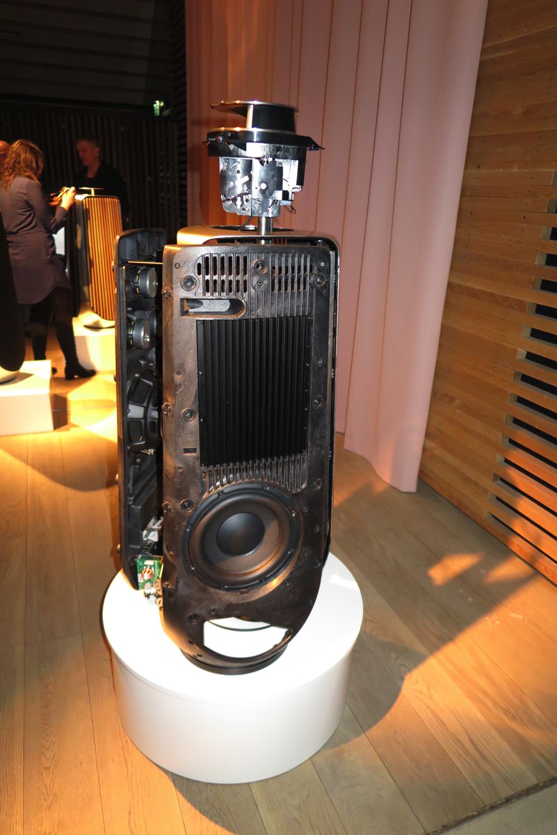

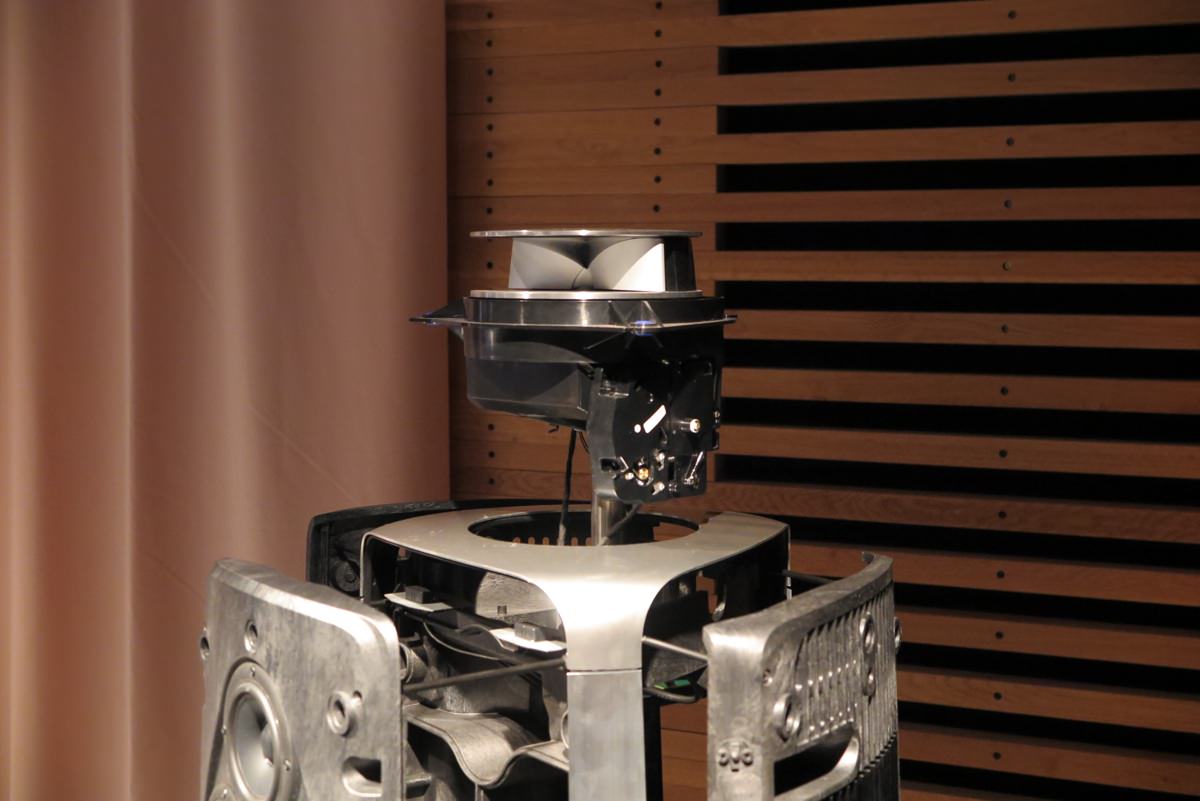

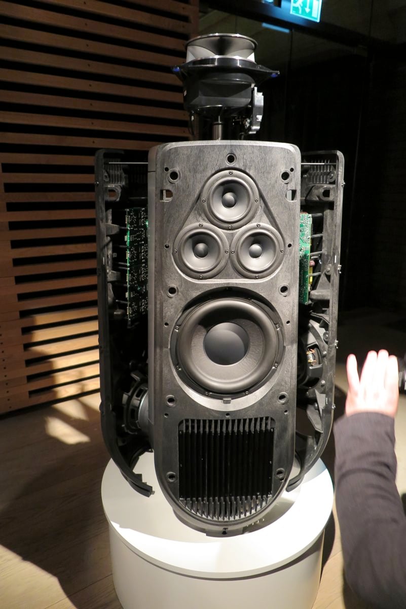

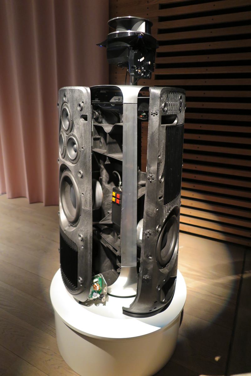

I'm too lazy to read what's been published, but here's some (uninformed) things I notice about the new Beolab 50:
1) bye bye Scanspeak drivers
2) The SAW lens at the top of the speaker appears to control beamwidth mechanically. IE, the walls of the waveguide are motorized. Neat.
3) Like the Beolab 90, it's a three way loudspeaker.
4) To me, the most interesting thing is that it's a mix of three different technologies to control directivity. The high frequencies are obviously controlled by a waveguide. The low frequencies appear to use DSP beam steering. The interesting thing is that the midrange appears to be a resistive cardioid.
As usual, pretty clever engineering from the folks at B&O
.....As usual, pretty clever engineering from the folks at B&O
Agree there 🙂 and after had a look at their whitepaper v2 is impressed they implemented modern monitoring sensors to magnets so DSP filters is temperature dependent (thermal compression compensation), also it looks verse model 90 that this time there is a "HIGH" latency mode setting that probably would improve on transients at the cost of 100mS latency should user situation could live with that delay.
The temperature sensor is a feature that is present in most of the B&O products since 2003.it wasps recording the temperature and it was engaging a limiter. Now in the BL90 and 50 a filter is triggered after a threshold is passed.Agree there 🙂 and after had a look at their whitepaper v2 is impressed they implemented modern monitoring sensors to magnets so DSP filters is temperature dependent (thermal compression compensation), also it looks verse model 90 that this time there is a "HIGH" latency mode setting that probably would improve on transients at the cost of 100mS latency should user situation could live with that delay.
Also, one could also change the latency of the beolab 90 from the beginning, but it took a few software updates to get it really work well
I got to see and hear them on the day they were launched but it was in a shop-in-shop so it was very noisy and a huge space
Thanks clarify radulescu, about latency we don't know anything before they release visual curves or any review site share their data but step response in narrow mode for BL90 at stereophile was not very impressing, therefor personal was positive to read about "HIGH" latency mode when we have all that DSP power available and only want to listen music in stereo.
Thanks but think there must be a big difference sound wise along the way if its say just a thermal limiter for protection or its both a thermal limiter for protection and also a active temperature dependent filters (thermal compression compensation). Some day they probably add even more motion sensors to correct for other smaller distortion too.
