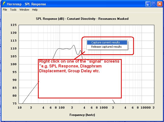

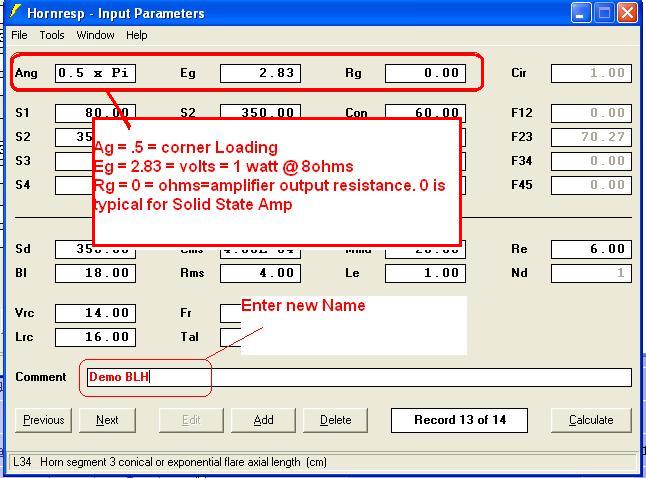

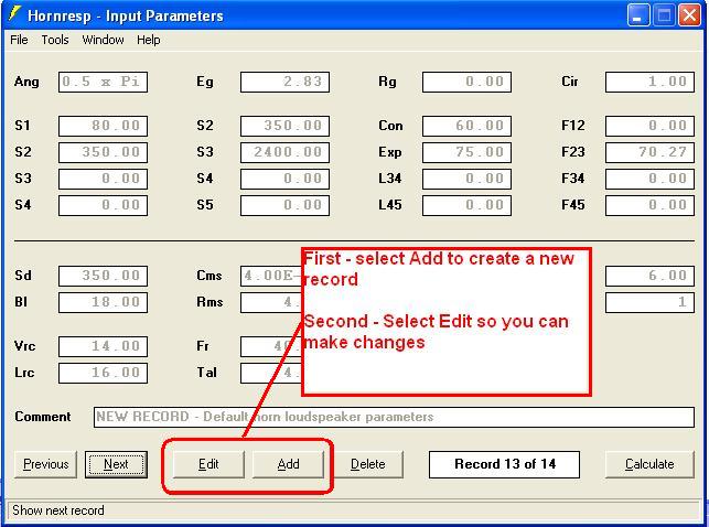

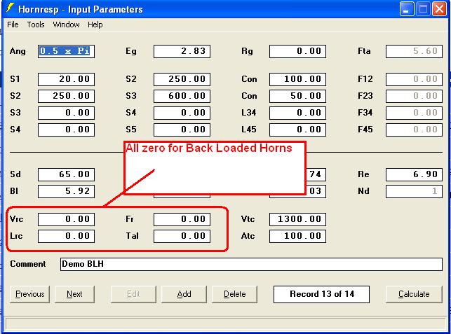

Next: Download Hornresp and started it up. You will start with some uneditable default parameters. Follow the steps in the picture.

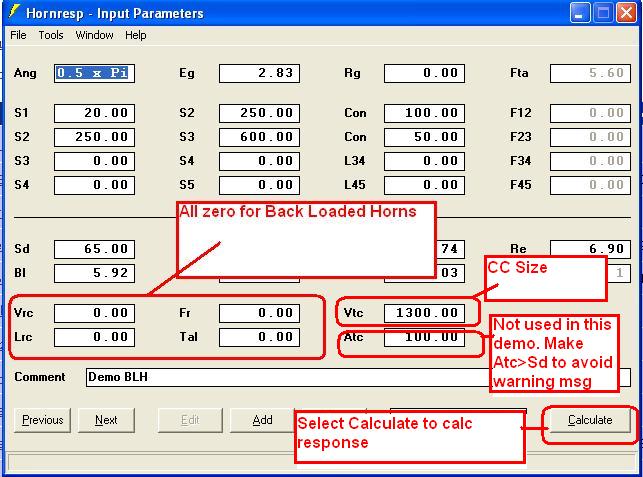

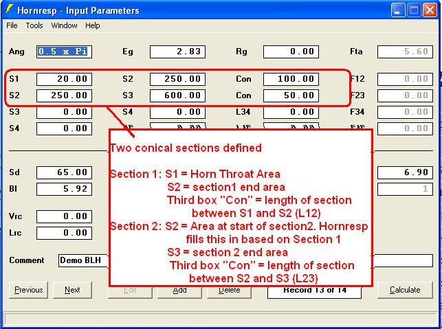

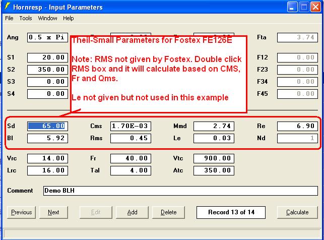

The enter the Fostex FE126E Theil Small Parameters from the data sheet. One note on CMS: There is a typo in the CMS values given by Fostex for every driver. It is 1000 times too small. The picture shows the correct value.

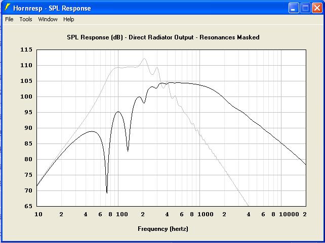

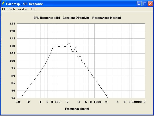

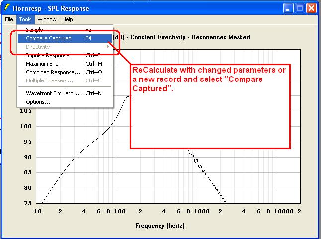

The end result is the latest screen in black and the captured screen in gray.
Note: You don't have to compare the screen you captured but could go to a different "signal screen" (e.g. Diaphragm Displacement) and compare the current and captured result.

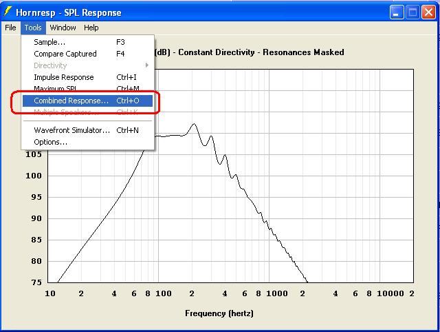

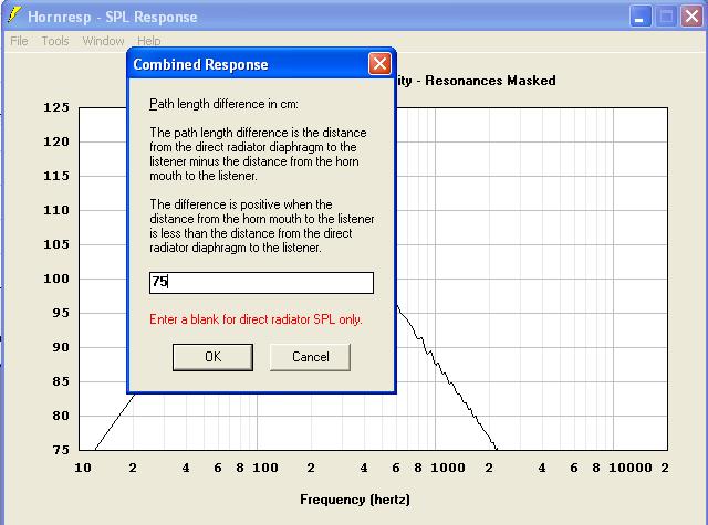

Combined response

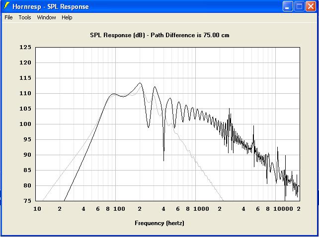

Last one. With a BLH you hear both the front (directly) and th rear (through the horn) of the driver. The Combined Response Tool does what it says.
First; Calculate a simulation as usual.
Second; select the Combined Response Tool
