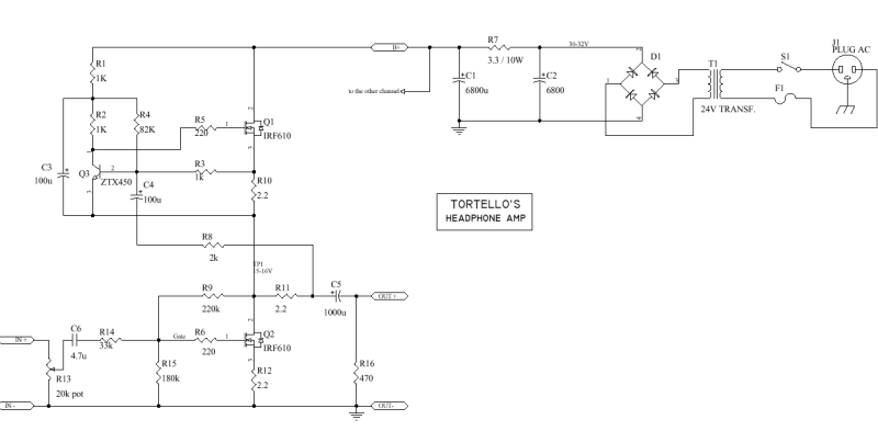

Here is the schematic of my headphone amplifier, a simple circuit based on the Zen idea, with the exploitation of the Pass Labs patent # 5,710,522.
This increases a lot some circuit features, such as distortion and driving capability:thanks again for your open-mind, Nelson!
With the schematic values I obtain over 8Vpp onto a 22Ohm load (!), with about 1% of T.H.D., but what really matters is that with my Grado 325 I obtain a very good sound, far better than with the RA-1.
The gain is 3.2, or about 10dB, the input impedance about 40KOhm, without the volume pot.
Fine settings:
R4 should be set to obtain the requested drain bias current: I chose 300mA;
R15 should be set to obtain about 1/2 B + on TP1;
R8 should be set to obtain i (R10) = i (R12) in dynamic conditions, for example
with a 1KHz sinewave at the input.
The pass [Pass?!:)] -band is about 4Hz-25KHz: if you want to extend this, you should change R9 into 68K, R14 into 10K and R15 into 56K, the input impedance decreases to about 10KHz: the values must be adjusted as above.
Feel free to change values, bias current and P.S. voltage.
I like its sound very much, I'll be very glad if you will build it and tell me what do you think, thanks to all for this!
P.S. The image is not so good, I know...: if anyone wants a better .pdf file, please let me know.
Tortello

a Philips cd723 cd-player , cheap but ok.. modified the ouput stage by a opa2132 .. this gives me so much voltage out (2V rms??) that I use a standart 10K+1K voltage devider infront of the headphone amp.. it is still too loud (grado sr-60).. now I also use a 24bit/196KHz crystal evaluation board for the digital out .. this goes to my second headphone amp .. it has a 12step atenuader... beginning with 10k+1K and then downwards.. I gues a 10K+220Ohm would be a good start...
so you see I need NO voltage gain .. I attenuate by 20dB or more...
A third headphone amp I use as refeence.. some how it always sounds best.. all headphone amps are szekeres .. 2 earlier prototype are dismantled..
I also have two buf634 and two buf04 around.. gonna try them too ...
Dear Paulb
Hum problem....:
the original szekeres does not use a decoupling cap for the MOSFETs bias circuit.. that could very well reduce the hum......
also 200mA DC with 2mA AC though a 0.1 Ohm ground lead causes enough hum to be audible so carefull gronding is nesscery..
you could also put the MOSFET inside you opamp feedback loop... an opa134 could be stable at a gain of 3 .. or use a compensation cap around the feedback loop to give it a 100KHz roll all .. should be more then enough... This is what I want to try if I had just a litle more time for things. :-(

Thanks, tschrama, I've been pretty darn careful with my grounds but I may have messed something up. The hum is too low to see on my scope, but it's audible at zero volume setting. I haven't had a chance to look more closely at it yet, too busy listening to the power amp section.
Just a quick update on my hum problem.
I found that it was the ripple coming in to the cap multiplier that caused the problem. While the multiplier did a very effective job of removing the ripple, the input to it was close enough to the headphone amp board (2 inches or so) that it induced ripple into the amp.
The power supply is in a separate enclosure, so I added a simple RC (4R7, 1000 uF) there. Voila! The ripple was cut down by about a factor of 10, and it softened the edges a bit. The hum is now inaudible.
