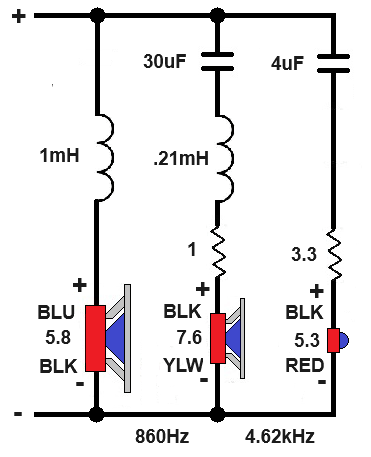

The crossover indeed needed some rework.
Calculationse I've done have proven that.

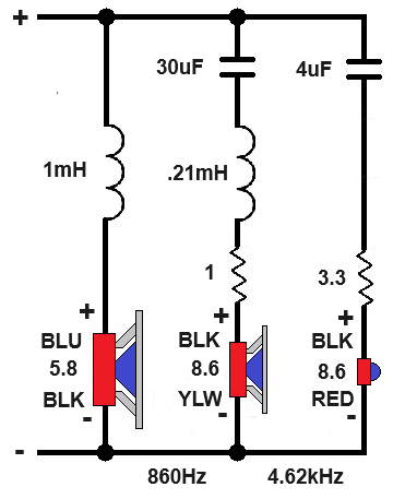

I tried a 3.3 ohm resistor in series with the tweeter, a 1 ohm resistor in series with the midrange and a 15uF cap in parallel with the 14uF midrange cap. I can already hear a drastic improvement in one speaker.
However, if all one listens to is jazz, the speakers would be fine as is.
So taking those impedances I crudely calculated and increasing them by the series resistors I get the following component values.
Tweeter 4.11uF cap
Midrange .21mH inductor 29.29uF cap.
Woofer 1.03mH
Tweeter 4uF will be fine.
Midrange .22mH with some removed to make .21mH will work. 30uF will work
Woofer 1mH will work.
That will give a mid to tweeter crossover of 4.62KHz and a mid to woofer crossover of 860Hz.

The tweeters do still sound slightly loud on some songs, however I'm going to wait until I make the inductors right before deciding if I need to do anything else with the tweeters.
If need be I'll use a series and parallel resistor to make an l-pad that won't alter the impedance.
I'll post a schematic of the updated crossover when I finish drawing it up.

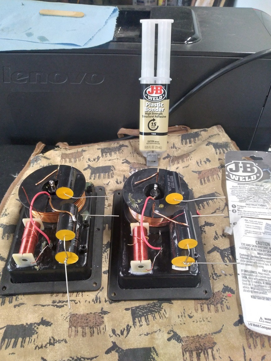

Here's the partially assembled crossovers.

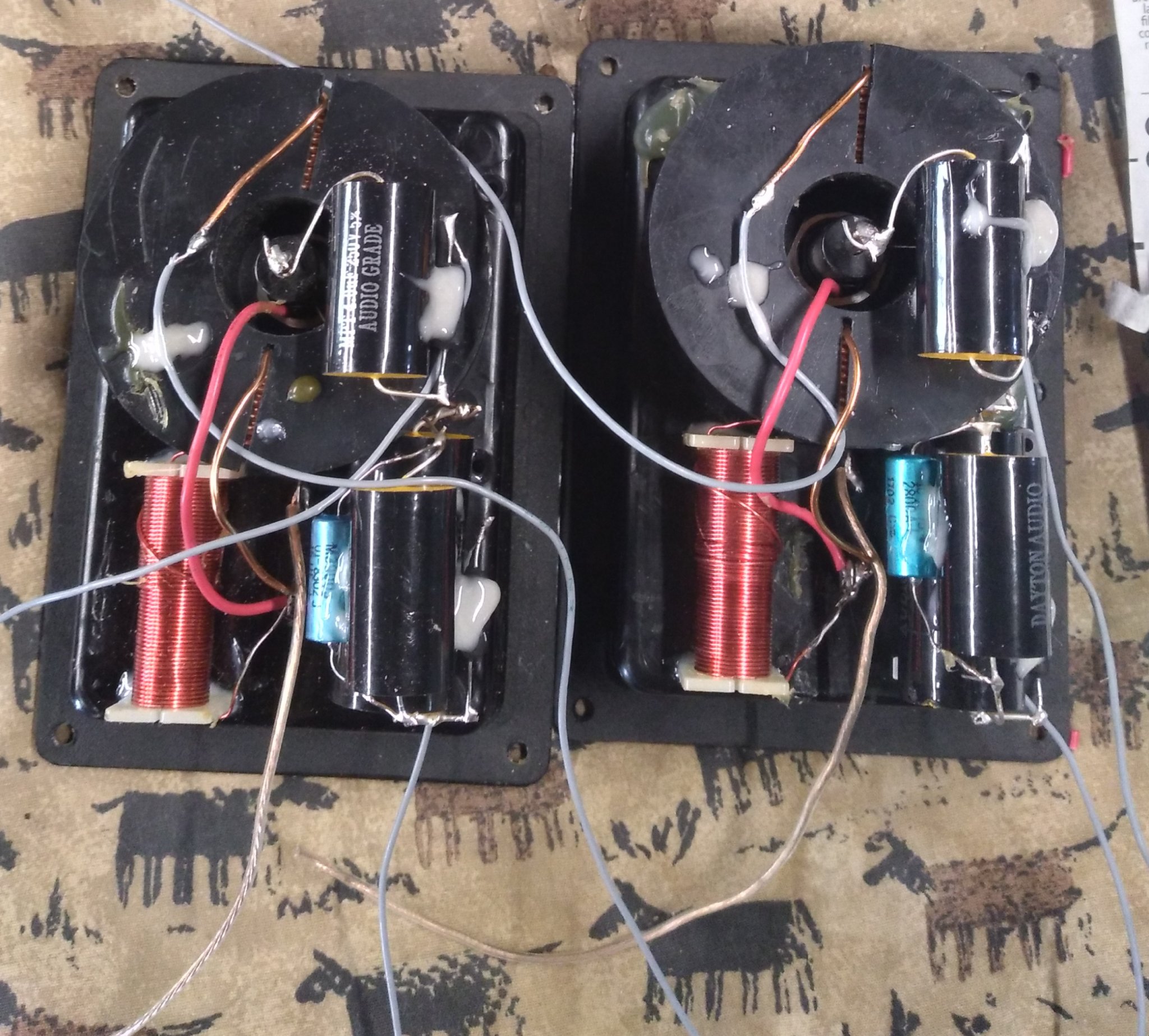

Got the inductors modified last night and secured.
The new caps came in today and I got them glued down. After an hour for the epoxy to cure I'll add the 15uF caps, resistors and solder it all together.
Now a 30uF film cap will not fit so I may leave the 15uF caps in parallel with the 14uF caps.
Once all is soldered, I'll glue the resistors down as well. Then I'll add 3"-4" wires to the connections on the crossover and glue them down. The stock wiring to the crossover is quite short unfortunately.
For the three wires running to the - input terminal I'll just install one wire and connect it to the three wires.
I also used the plastic epoxy to secure the spring loaded terminal assembly back to each terminal cup.
I measured the stock caps and they were within a reasonable tolerance and when I did the mods using the stock caps with the resistors and adding the 15uF cap in parallel with the 14uF cap, the speakers sounded much better. Listened to them pretty much all day Friday at work and was very pleased.
I know the film caps may alter the sound some, but I know they will only make the speakers sound better.

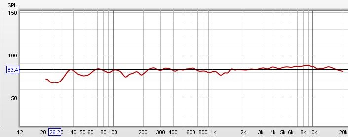

Also someone over on the parts express forum had restored theirs and posted a response graph as well.
If I had to judge mine based on the graph I'd say mine were nowhere close to being anywhere near proper at the crossover frequencies.
I had to reduce the inductor values and increase the cap value on the midrange driver to get them to sound proper.
I also intend to measure the midrange and woofer parameters using a DATS V3 speaker tester so that I can get the component values needed for zobel networks which will further improve the sound.

The zobel keeps the driver impedance more constant as the frequency increases.
Not sure why, but with the crossover stock and wiring stock I simply could not get good sound and forget trying to integrate a sub.
The best way to describe the sound is the tweeter sounded too loud and the midrange was lacking at the lower end with the woofer lacking at the upper end and not loud enough.
Reversing the midrange and tweeter polarity helped.
I then used a 3.3 ohm series resistor with the tweeter to make the crossover frequency close to the published spec of 4.5kHz.
I used a 1 ojm series resistor with the midrange as that would require an easy to get 30uF cap so the midrange would meet its lower listed crossover frequency spec of 900Hz. Now because I had already ordered the caps (10uF and 4uF in parallel) when I discovered the crossover was out of whack I just put a 15uF electrolytic in parallel with the 14uF film cap for now. Plus a 30uF cap would be too large. When I order the zobel components I'll add a couple 1uF film caps to the order and put them in parallel with the 14uF and 15uF caps in parallel with each other to equal 30uF.
The sound improved greatly after those mods.
After making the inductors the value the crossover calculator said, the sound improved even more.
I expect the zobels to improve the sound around the woofer to midrange crossover frequency and the midrange to tweeter crossover frequency.
The jury is still out on whether or not the tweeters are still too loud though. If they are I'll try a fixed l-pad with two resistors before the 3.3 ohm series resistor as to add more series resistance will require a capacitor less than 4uF.

When I first heard these speakers and heard the deficiencies in the sound, I immediately started calculating and found the crossover was way out of whack.
The woofer low pass was one frequency.
The midrange bandpass was one frequency range.
The tweeter high pass was one frequency.
None of the frequencies at the crossover points matched.
I suspect that may be why the tweeter and midrange had to be wired out of phase as it may have made the speaker sound a little better.
That said I am assuming there were no revisions to the crossover during the production life of the speaker.
Also I'm kind of surprised that no one has posted any mods to the crossover. It could be that people didn't think much of this speaker as it's not the typical two way speaker Advent was known for and felt it wasn't worth the time or perhaps many felt that they needed all sorts of measurement equipment to know what changes to make.
All it required was a crossover calculator, time and my ears.
The original owner listened to them late last week and noted the improvement in sound quality so it brings more validity to the changes I made as it isn't just me thinking the sound quality has improved.

I'd like to figure a way to add a SPDT or SPST switch to each crossover so that I can switch the woofer high pass in or out.
Eventually I may do like the person on the parts express forum did which was mount the crossover components on the cabinet bottom and covered the hole where the terminal cup went with a wood board where better terminals were installed. I then would have enough space to add a switch.
One possible option is to remove the fuse holder and find a push on/off switch to fit the hole.
Using the DATS V3 speaker tester to make whatever inductor values I need really makes it easier to build and modify speakers.
I suspect this speaker was a case of engineer spec'd one thing, but the parts used were gotten for a good price or were already used in other speaker models Jensen made and marketing probably said who needs resistors they just add to the cost.
