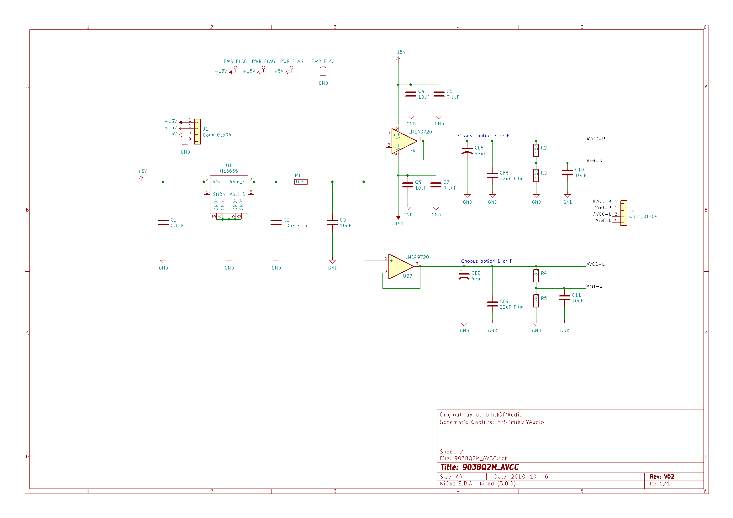

I indeed meant op amps!
Well yes, the VREF doesn't draw much current, but the analog supply needs 50mA MAX according to the data sheet. I figured if I use a two channel op amp I can use one channel for the voltage reference and one channel for the analog supply. That way I have a super low noise analog power supply as well!

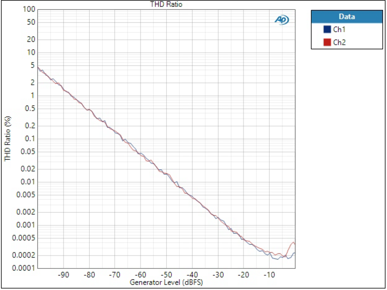

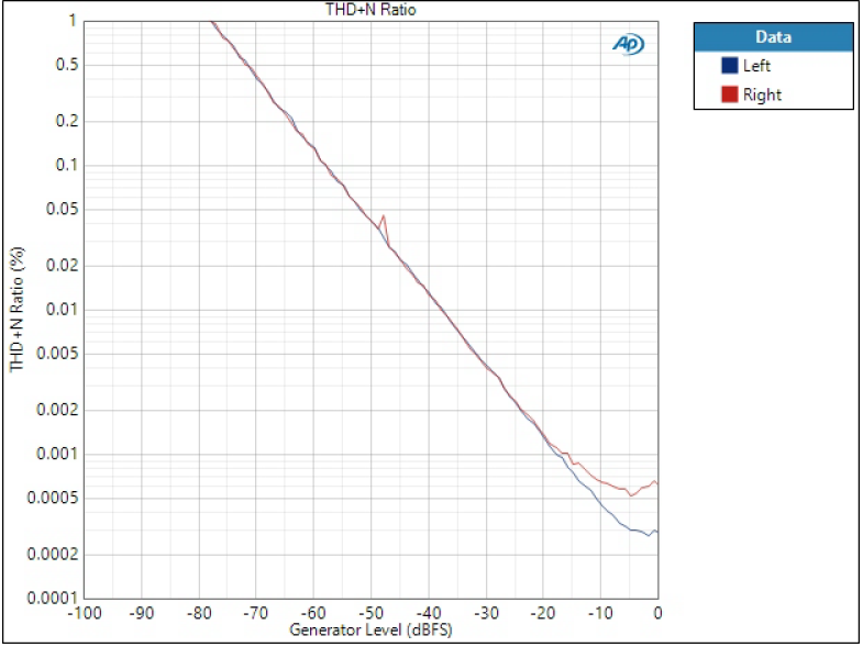

I have some measurements although as said I didn't dig this deeper.
So LM4562 was sourcing VREFR (ch2 in graphs), the positive input had 10u + 1kohm + 10u filter and the opamp as voltage follower. The reference came from ADP7118 regulator that wasn't sourcing anything else at the moment. VREFL (ch1) was sourced by LT3042.
I have attached THD+N and THD graphs. As you see, THD+N increases at higher levels and is -104 dB at 0 dBFS, compared to -111 dB at Left channel. THD graph reveals it is increased noise floor rather than distortion. Adding large 1000u cap on VREFR pushed it to -108 dB. It is probably pushing the noise down, I don't have graphs from that.
I didn't do more tests on that.
edit: But at some point I had a noise floor of around -90 dBV instead of usual -111 dBV when connected just slightly differently on my test board, but in that case 1000u cap pushed it low again. So there was something going on at some point I didn't quite understand or analysed further.

It is forbidden to put a capacitor from the output of a voltage amplifier to ground if you do not want problems.
Good point! I forgot to mention that. It doesn't really seem right to put a massive 1000u cap directly at opamp output even if it seems to work. You do see circuits posted where there is a large cap but it may be different type of amplifier then. I'm not expert in that matter but it is better to test and analyse a bit more if doing so.
With a very large cap the current limitation of the op-amp will limit the voltage excursion to a level that can't generate oscillation but the problem remain and the noise problem that is mentioned above is a good example.
A L-C filter will have an effect in a much wider band than any shunt or LDO regulator.
It depends, there needs to be a stability analysis. A lot of op-amps used in this way will be unstable with a small/moderate capacitive load but will again enter a region of stability with a huge amount.
If you know something more please do a demonstration (mathematically).
