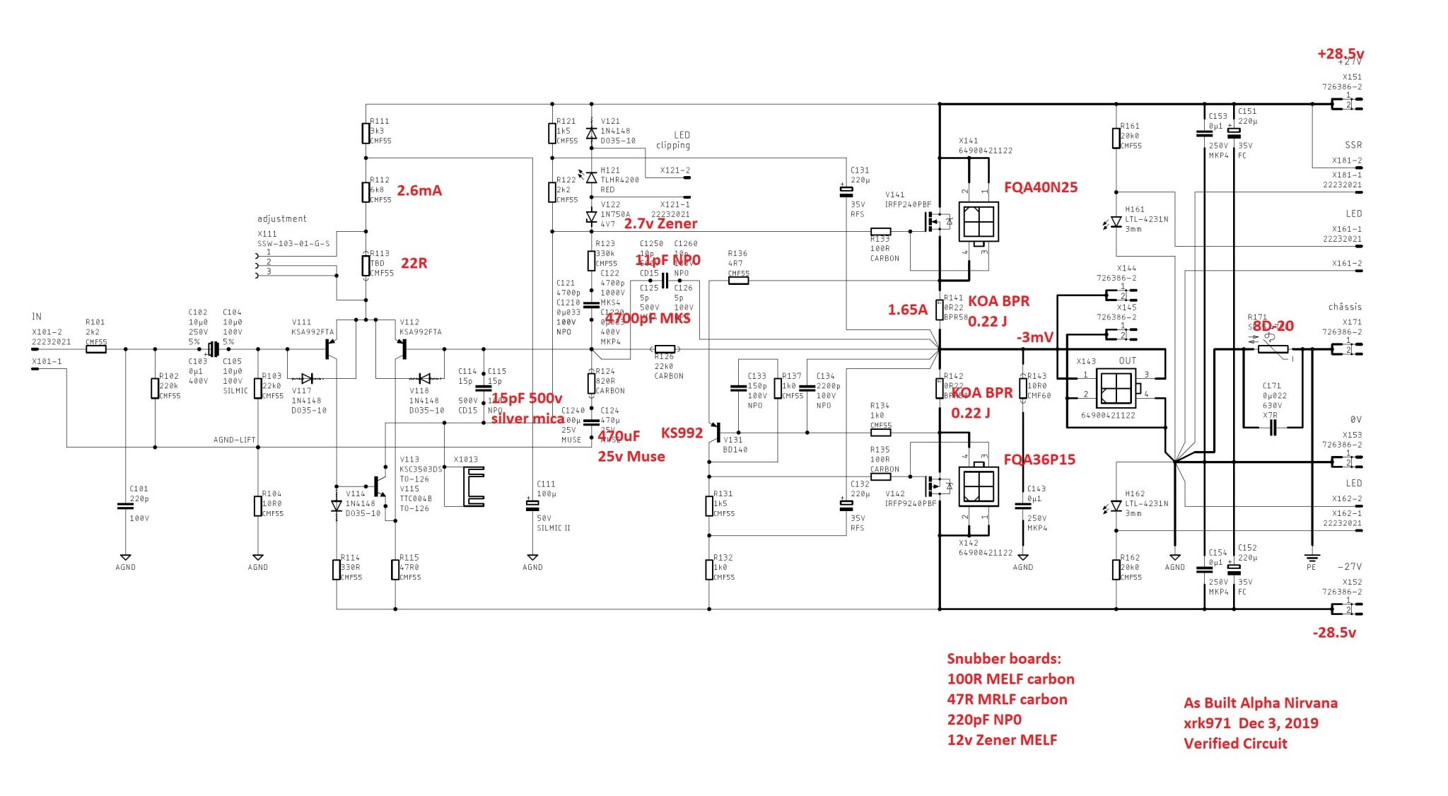

Here is the schematic I worked with. It‘s much easier to answer questions since I haven’t memorized part numbers.
If you look at the Mouser BOM link on the 1st page of the thread, and click on the resistors R124 and R126 you’ll see they are spec’d for 0.5 watts. That’s a minimum number. You can place a 1 watt size there as long as it fits too.
R113 is a potentiometer (try 500 ohms or 1K ohms). You need to adjust it for about 2 mA across R111 or R112 while also observing DC offset on the amplifier outputs. I believe I wrote a cliff notes guide and the link is on the 1st page of this thread. Here is the link. For the H121 LED I just placed it directly on the board, anode is positive and cathode is negative (there is a section that states ‘LED CLIP’). You have the option of also placing it on your front panel with twisted wire leads coming back to the board if you want it as a visual indicator of when the amplifier is clipping. BTW, V121, H121 and V122 are optional. They are not needed for the function of the amplifier. It Is just a cool visual tweak that Hugh provided.

Anand,
Ran into some more confusion today. To be clear, it is either or on c115, c114? Is this the same with c125/0 and c126/0? c124 and c1240. What to do here? these 2 caps go here, correct? What have people been doing? C102-105, I don’t know much about audio caps. Will one big wima cap be good? Or do you have a recommendation?

Once again, please read my cliff notes. It is post 2140 if the link doesn’t work.

Hugh,
I think I figured it out. My confusion was around 125/0 122/0. Whether or not the caps were there to be paralleled or they are optional? From what I gather they are smd optional with thru hole? Ive never had this on an pcb before. So, I used the thru hole options. I am done with the boards and I will start laying out the boards in the chassis.

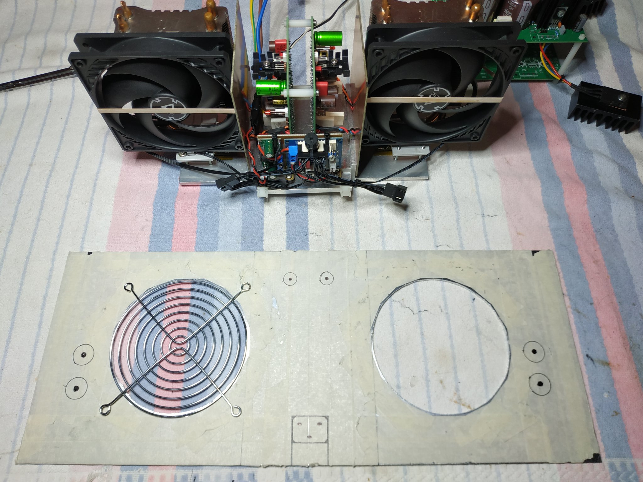

Mr Hugh
My amplifier has been ready for a long time, I don't have any operational problems. Also the cooling in this way for 3.1A is extremely good. 44 C active heatsinks ,52-54 C on body case, of mosfets, temp air 20-21 C . I am preparing the back side of the box where the heat from the active heatsinks will escape....Thank you also for your concern.

Hello NIkos,
I’m going to be running a 12v fan. I assume You using the psu to run them?
Thnx,
BMM
Just something you may not be aware of regarding powering 12v fans from the amp's PS (in my case, SLBs).
The first build of my AN4Rs had the output devices of each channel bolted to a CPU cooler, with a fan blowing through the cooler fins. I used a wirewound resistor to drop the +21v DC rail to about 10v.
Cooling-wise ... everything worked well - however, I found that the fan produced a ripple on the +DC supply (which wasn't there on the -21v DC rail ... which didn't have a fan connected to it).
So I had to add a 'pi filter' to the DC feed to the fan - this removed the ripple! (y)
