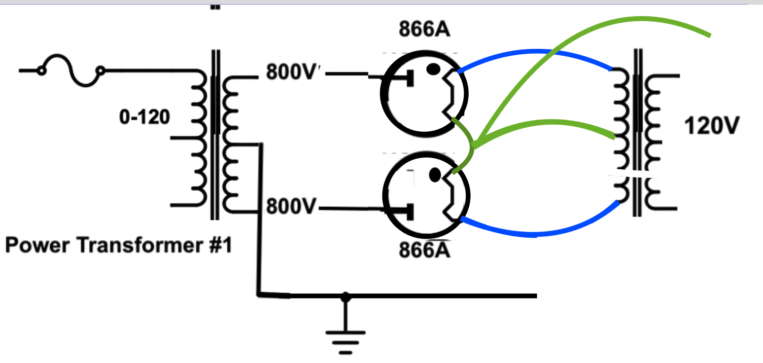

The spud is an EML 30A. 866 rectifiers. The spud is very transparent, rich and full bodied. Only 4W output, so not for everyone. But in my smallish room and 90db efficient speakers, its quite nice on classical music. I rarely max out the amps.
Not to hijack the thread but do you have any info on your amp? I'm especially interested in the 866 rectifier implementation.
TIA
Hope this helps for the 866 implementation. Forget the 800V. I am using 400V with my EML 30A.

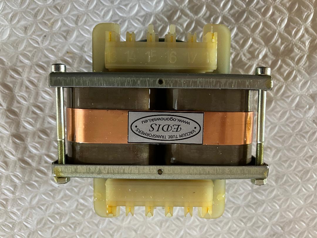

Ongowoski make a M23 Cold Rolled Silicon Steel transformer some call Super or Ultra HiB its a 3kg Double C core monster and had it custom wound , now this is a doozy and am more satisfied with it's sound than most other stuff I have tried other that parafeed Nickel or C core Silver and much cheaper than Audio Note for their offerings .
EI core HiB M23 I also like its a bit warmer in the mids than C cores which I found a tad cold in this department .
