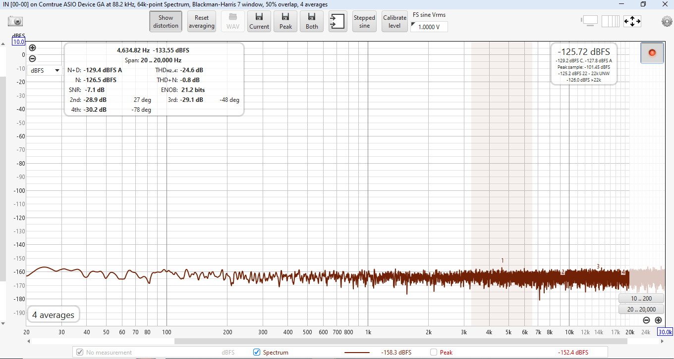

The Java based drivers supplied with REW seem to be really good. The macOS one was already good, but a very smart fellow wrote custom drivers for Windows and Linux use in REW. These allow for exclusive access to the devices, too. I haven't found a single case where the Java solution isn't superior to ASIO with REW. At least with recent versions of REW. But, that's just me.

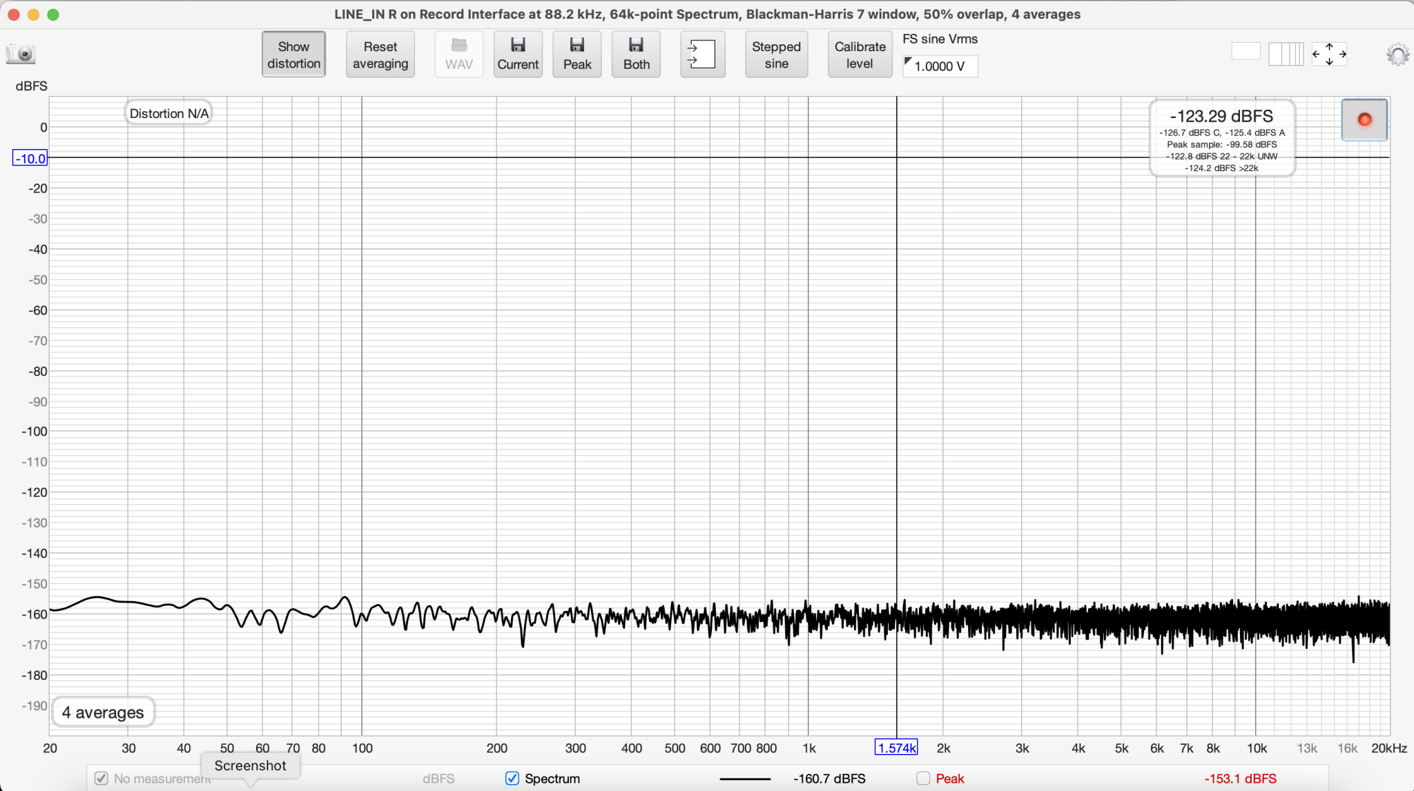

Anyway, I tried running my own Cosmos ADCiso with a MacBook Air M1 just like SylphAudio's and had no problem with the noise floor. (Posted above.) I tried using the same settings as he (she?) did in REW, too. It took me longer to find all the right cables than it did to get it all up and running for the first time.
I suspect that SylphAudio has a bad connection, a subtle setting wrong, or something like that. That's easy to do, and I'm not being critical here. I certainly have experienced all of those.
Excellent point!
This is my Cosmos ADCiso directly into a MacBook Air M1. Based on his most recent posts, I've adjusted the RTA settings to match his. (I hope) He should be able to compare his results directly.

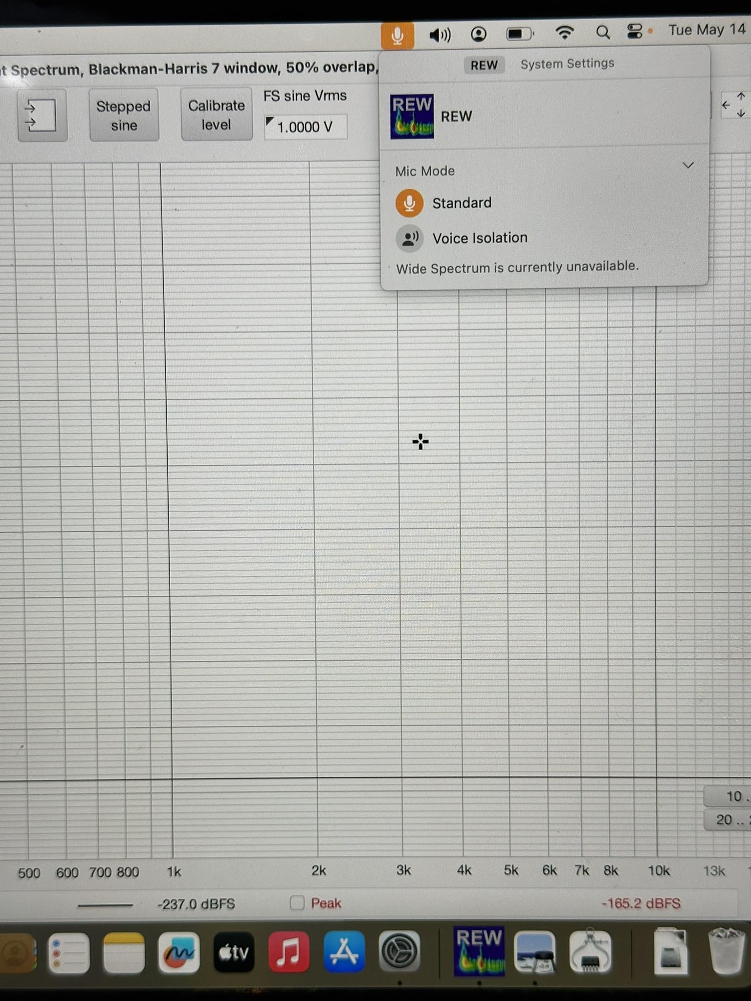

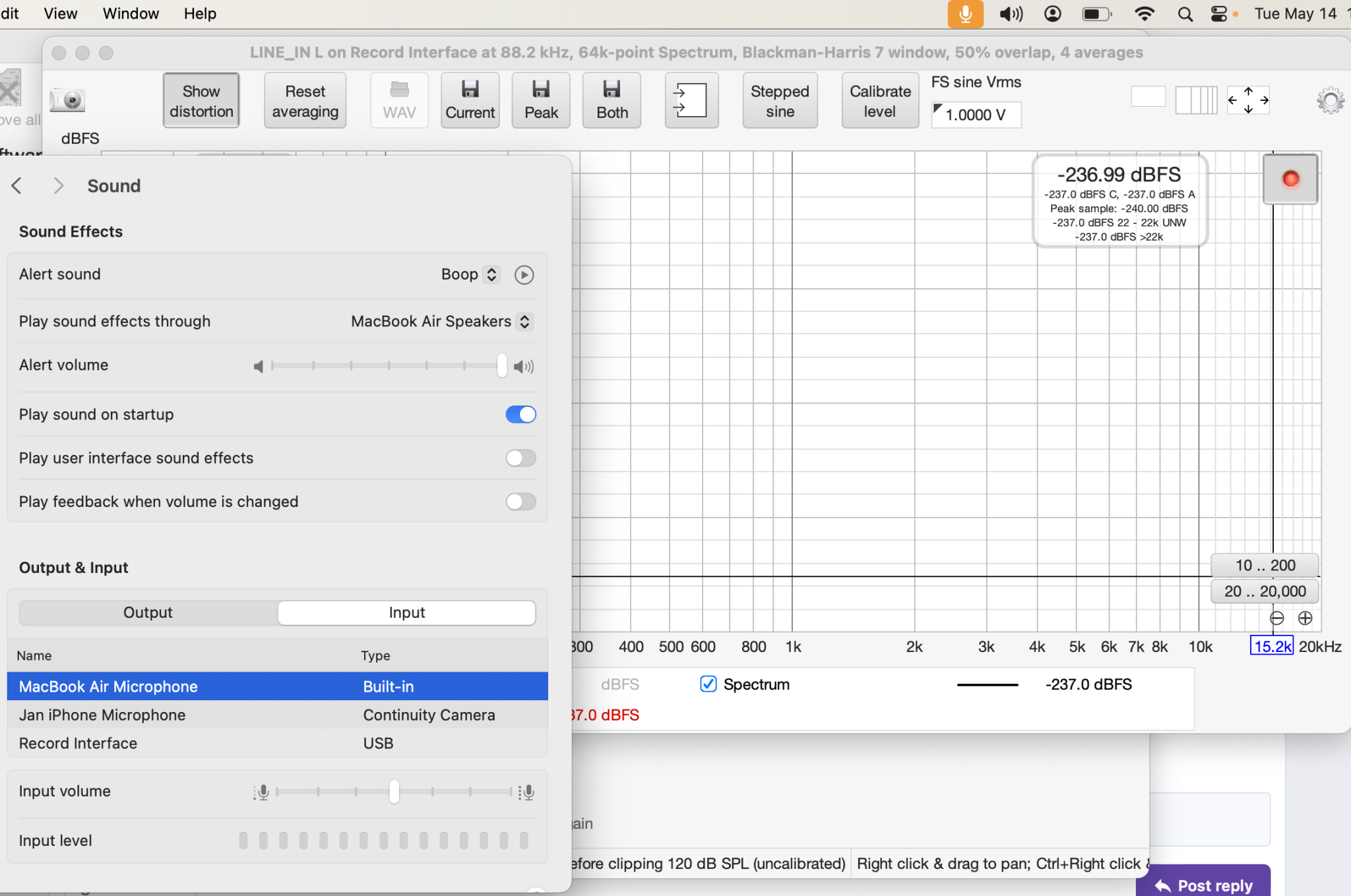

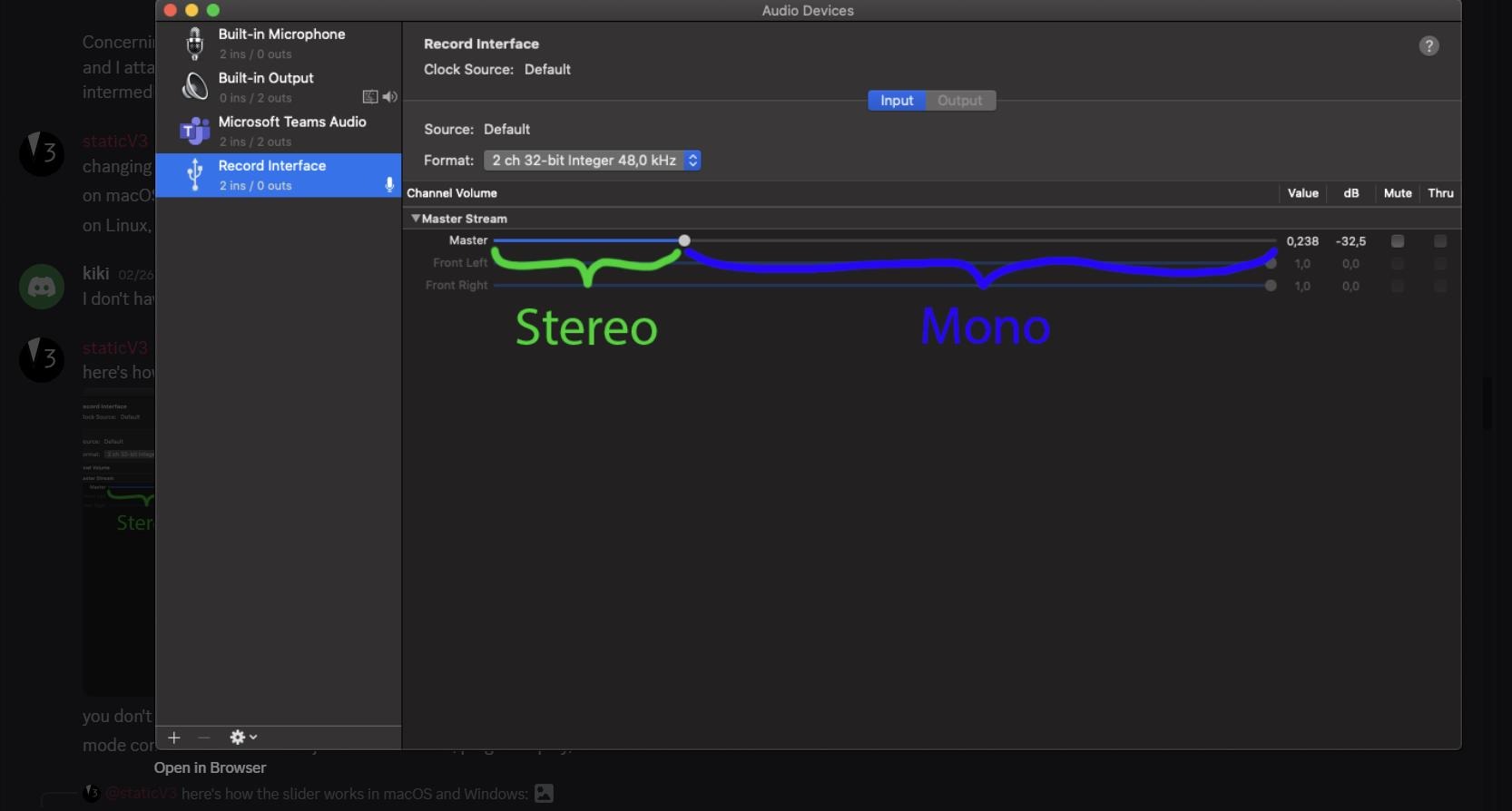

Is your Mac version Sonoma 14.4.1? Looks like REW can't get exclusive control over the ADCiso since the system treats the ADCiso as a microphone input (and it's applying noise cancellation). I already updated to the latest non-beta REW (5.31.1).
REW only displays the RTA graph from ADCiso when there's an input signal. If there's no input signal, then the RTA display is totally blank. (where it should display the ADCiso's noise floor). Like some sort of a noise cancellation.
On windows, it can display the noise floor. This is not possible on my macbook.
Already unselected the ADCiso(record interface) as the system sound's microphone input, but still REW doesn't display the graph when there's no signal input feeding the ADCiso.

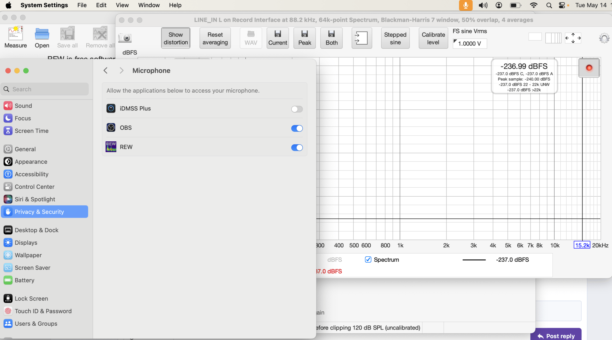

If I remove REW on microphone security and privacy settings, then REW cannot totally access the ADCiso, it can be selected as the input on REWs preferences, but the RTA graph won't display anything. (Even if there's a signal feeding the ADCiso) Obviously this access is required.

Yes, one need to make sure the settings in Audio Midi Setup for the device is what you want.... easy to miss...
Ok my bad, the default on audio midi settings is 16-bit 🤦‍♂️
So even when the sampling rate that's being selected on REW is higher, it's still selecting the specified sampling rate at 16bits.
Solved. Thanks for all your help :)

After some questions and some research, here is my understanding of the situation with REW.
REW is written in Java. Keep that in mind for a minute.
Pavel Hofman wrote some specific drivers for REW that allow for Java to access the lower level interfaces to the audio hardware. They're the ones that have "EXCL" in the name. This provides for Exclusive Access (easy to read about on the web) to the devices, hence the name. This means that unless you disable the possibility of REW grabbing exclusive access to your devices, REW can change sample rates and stuff like that. These drivers are available for Windows and Linux. That's normally not available in Java.
At the moment, there are no equivalent drivers available for macOS. So, REW, written in Java, can't grab Exclusive Access to the Core Audio values and change sample rate settings and stuff like that. (Here's a great opportunity for you programmers out there...) That means that you have to use the Audio MIDI Settings app, which is the (very limited) user interface to Core Audio to set those values. Otherwise, you get sample rate conversions and bit reduction, depending on the settings and all that.

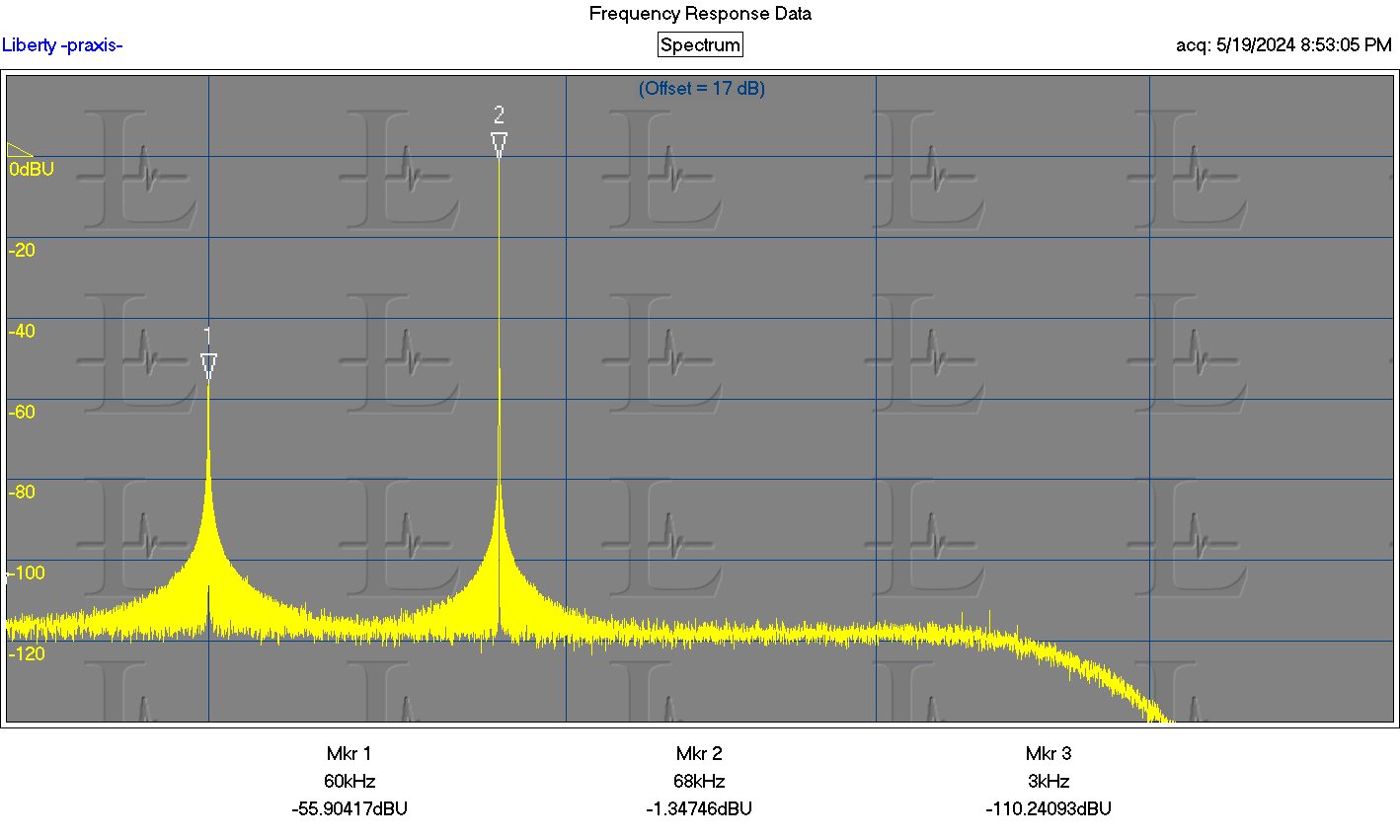

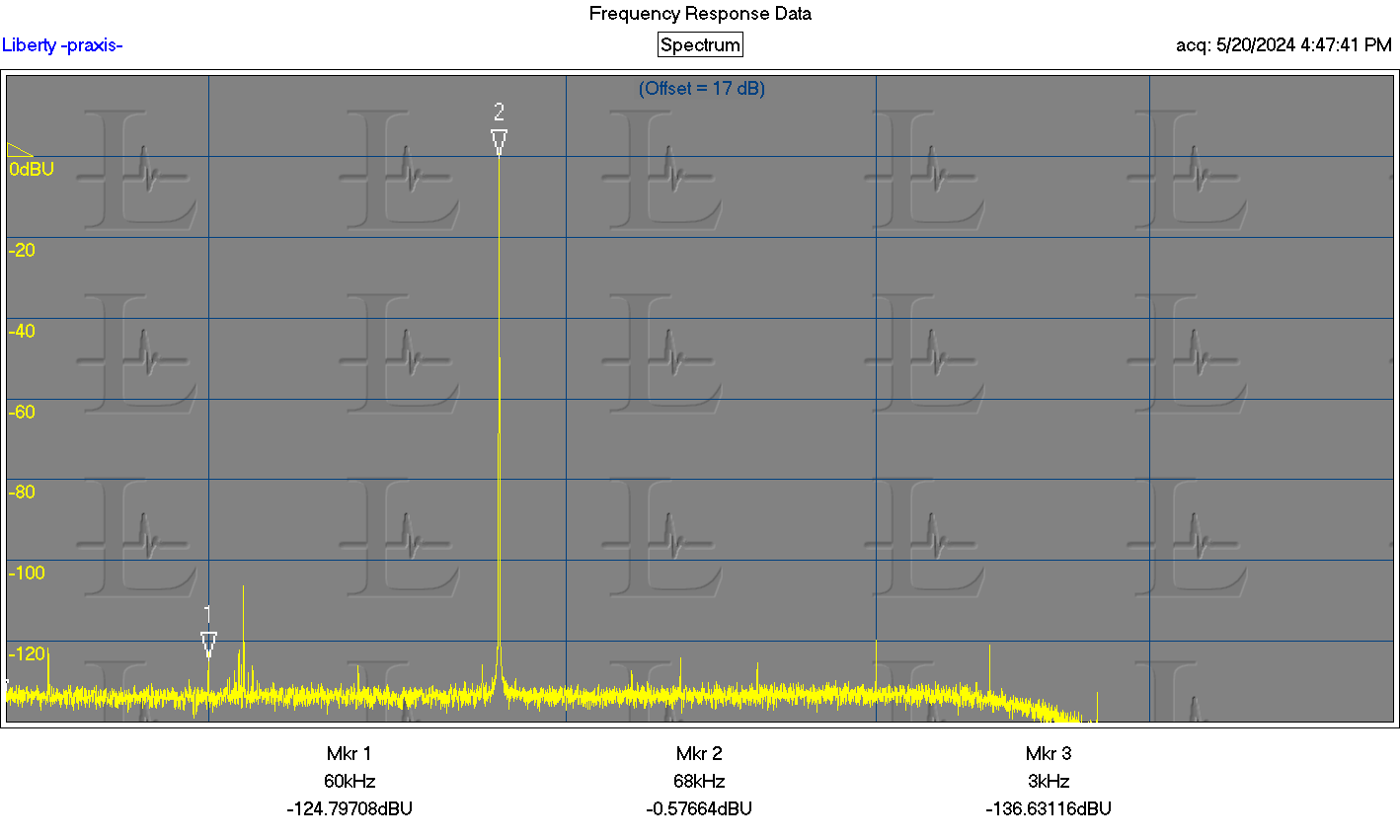

I was prompted to check out the Cosmos ADC with a 384 DAC. I used windows and Praxis (I very familiar with it) and got fine results at 1 KHz. However checking to be sure its really operating at 192K in this case at 68 KHz it was not right. It seems to be the FIIO KA which was making this strange 60 KHz + 68 KHz. So first I switched to the AP for 68 KHz and its clean so not the COSMOS then switch to the Breeze DAC (AKM) which was quite clean. Bill now has a 384KHz capable version of Praxis that I'll be trying tomorrow. It should be interesting.
Has anyone else seen this with ESS DAC chips?
