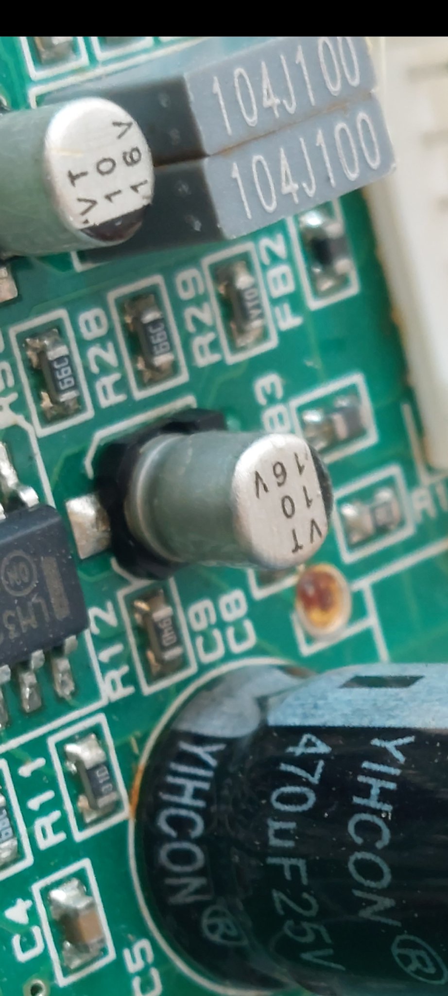

I see many of the same capacitors (VT 10 16V) on the board. If the ones controlling the audio sensing circuit have gone bad (and these are probably the only ones that really result in an obvious issue), wouldn't it be a good idea to replace at least all of the same capacitors? Maybe even other capacitors on the board with some higher quality ones?

I changed some with better ones with the same parameters but they are physically much bigger.
Also very important is that removing the old ones is tricky, because the board is **** and for every changed one you risk damaging the circuits in layed on the boardm be carefully.
Well I should've followed your advice.Also very important is that removing the old ones is tricky, because the board is **** and for every changed one you risk damaging the circuits in layed on the boardm be carefully.

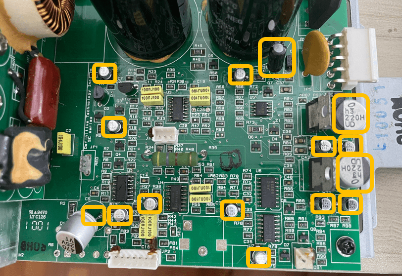

I am not good at soldering so I had someone fix my amps for me. I decided to also replace all the caps (mostly with Nichicons).
One of the amp works fine now, it turns on as soon as there is an audio signal.
The other amp, which before the "repairs" already seemed to have an issue wit the amp cutting in and out (the woofer moves...then stops...then moves etc), is now dead. It is either silent, or produces a constant soft static sound.
Here is what was done (names based on "Bp7006, 7004, 7002.pdf"):
Step 1:
Replaced capacitors (C5, C9, C6, C3, C15, C31, C30, C36, C35, C44, C48, C47, C43, C46, C45)
Step 2:
Swapped U2 between good & bad
Step 3:
Measured voltages at C6, C12, Q3, Input Voltage (M3) for Bad and Good PCB. Measurement values moslty are same.
Step 4:
Resoldered the capacitors.
Step 4
Measured resistances at R12, R99, R28, R29, R13, FB3, FB2, R27, R36, R11, R10, R9, R8, R7, R22, R21, R20, R19, R18, R17, R16, R5. Measurement values moslty are same.
The Vout at JP1 is 0.00V for good PCB, 0.10V for bad PCB. This seems to be the main difference between the two amps.
Can anyone advice what might be the issue?

I also got around to fixing mine. It was a bad cap. Attached a photo.
I just fixed the exact same problem on a Definitive ProSub 800, which appears to use the same amplifier. Yep, bad SMD electro caps, 10uF and 4.7uF variety. One had 50 ohms ESR but read OK on capacity. I replaced all of them on suspicion.
I got the sub for $15, and wanted to do a zero-budget repair on it, so bodged in some regular radial capacitors I had on hand, and gooped them up with silicone so they won't vibrate. Worked great! Great sounding little sub, I'm impressed.
Bchow, I observed, as did previous posters... that the traces on this board are really fragile and easy to damage. I'd be looking for missing connections on the new components. They may have been damaged by vibration.
