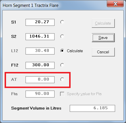

Is it a big problem if it's not exactly 5 degrees?
Hi Rob,
Ideally the angles should be the same, but provided that the difference is not too great I think that you should be okay. If the cutoff frequency of the tractrix horn is increased to 300 Hz and the throat diameter is 2 inches (S1 = 20.27 cm^2) then the half-angle at the throat entry becomes 8 degrees.
Kind regards,
David

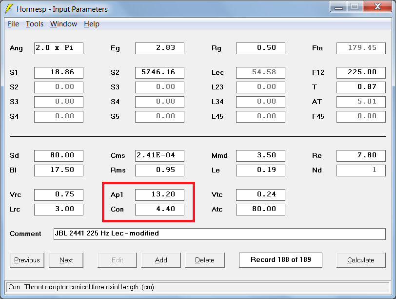

I think that's the opening at the phase plug, after that there's a conical part from 41mm to 49mm and 44mm long.
Hi Rob,
In that case, then perhaps it would be better to include a 44 mm long conical throat adaptor before the horn proper, as shown in the attachment.
Kind regards,
David
EDIT - The "two segment" configuration suggested above does not allow directivity response to be calculated, which may be an issue.

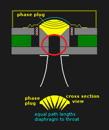

What Rob said, most of the vintage drivers have the W.E. conical horn inside to cover the HF above the horn's gain BW. AKA 'rubber throat' that predates PWK what? 15-20 yrs?
Thanks GM.
It is interesting that if the duct inside the compression driver is intended to act as a 'rubber throat' then it would need to have a flare rate greater than that of the horn to which it is connected, which means that the driver exit angle would be greater than that of the horn throat, so that for this case at least, it would not be possible to match the two angles exactly.
Without thinking about it too deeply previously, I had just assumed that the driver exit angle would always be less than, or at best equal to, the horn throat angle. Certainly not greater than :).
Kind regards,
David
