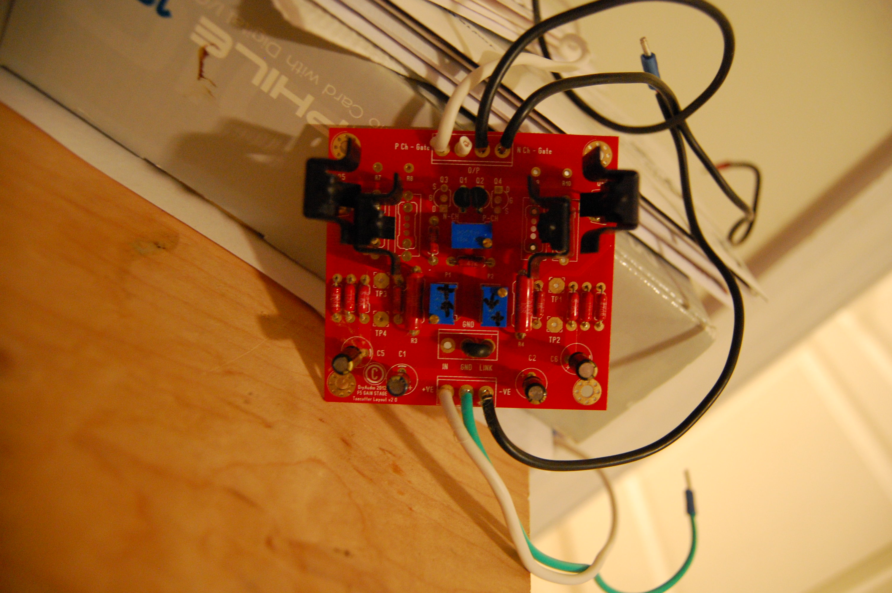

At the top of the amp board, the section with 4 connections marked O/P
I am guessing the most left goes to p-channel board to Gate
The 2nd from the left goes to p-channel board to O/P
The 3rd from the left goes to n-channel board to O/P
And the 4th to n-channel Gate
Does this sound correct?
The +Ve and Ground on the p and n channel boards come from the power board.
Next question: what does the `link` do on the amp board? For F5Tx?
Thanks.
Outer holes are output to gates. inner holes are feedback points from output board. Will only need to use one of feedback holes, as they are connected. Ve+ and Ve- are from PSU board. The wiring gets hairy. Be careful and ask questions.
You must connect link and ground if not using as balanced. If balanced, you would connect link to other boards link. THis i where you would have negative and positive halves of the input signal.

IF you want to be uber careful, you can power up FE boards before attaching output boards. THis way if something is not right, you dont burn anything. With high IDSS Jfets like you have, the outputs will come up hot, so trim the pots down before powering up if you dont go safe or you dont have a variac.
