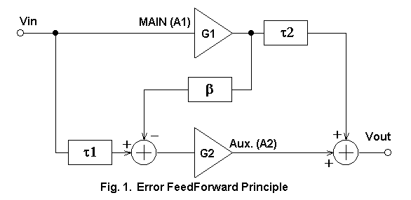

You could argue that differential signals are a form of feed-forward as the common-mode disturbance to the cable is cancelled by the differential receiver, but thats very debatable.
Reactions: 1 user

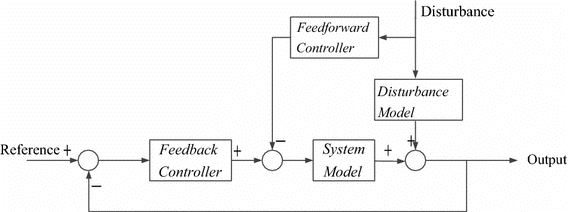

I guess the part that I don't get is: it seems like a lot of things you can do in feedforward you can implement in feedback much easier. Is there any benefit to using a feedforward technique as opposed to a feedback one?
They do different things - feedback can drive integrated error down to zero over time for instance, the classic DC-servo for example. Feed-forward can be added without risk to stability. Feedforward is typically much less accurate than feedback can attain. Feedforward does nnothing about disturbances it doesn't know about, feedback tackles any disturbance.
They can complement each other.
Feedforward can sometimes improve performance, depends. One example is shown in block diagram format:
The point is that it possible to help compensate for errors that you know are going to happen, and the technique may do it without affecting stability. The approach can help reduce how much work a feedback loop has to do, and possibly help performance given the limitations of feedback loop gain and response time.
Depends on what you know about the system/plant (sometimes its referred to as a 'plant' in control literature). If you know some correction will be needed, you can go ahead and give your best estimate to the output processing. Whatever error remains after that is all the feedback loop needs to correct for.
