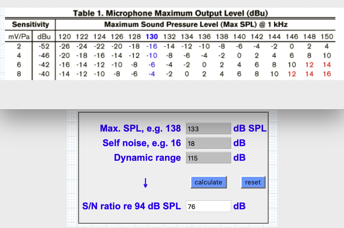

These seem to be the numbers....
0 dBu at 133 dB -> 2,2 V p-p ?

Yes, at its output, your microphone has a noise floor of about 1.26 uV RMS A-weighted and a maximum level of about 0.72 V RMS assuming a single sine wave, so indeed just over 2 V peak-peak. If you don't want to lose more than 1 dB(A) of signal to noise ratio, the noise of the recorder has to be about half the microphone's noise, so the recorder specs will be:
Input referred noise at < 100 ohm source impedance: 630 nV A-weighted
Maximum input signal level: 0.72 V RMS for a sine wave, so about 2.1 V peak-peak
Dynamic range: 121 dB(A)
