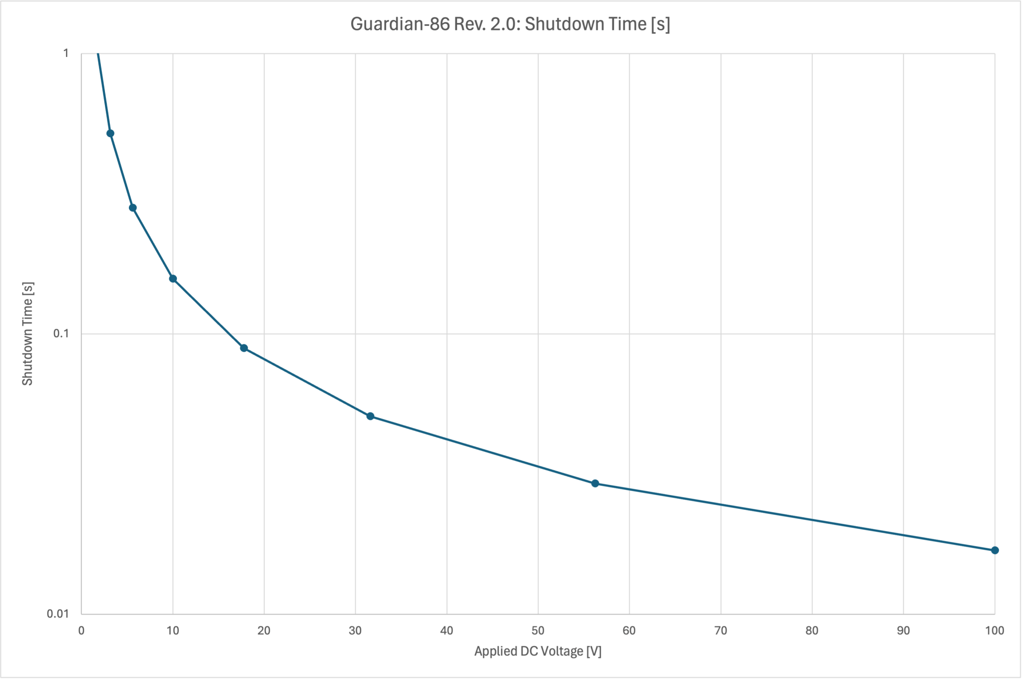

What is the speaker shutdown speed?

Getting back to the Guardian-86, however: There's a clear tradeoff between the reaction time of any protection circuit and the amount of protection offered. It's analogous to fusing. A fuse should blow to prevent your house from burning down. It shouldn't blow because you crank the volume knob past 3 o'clock.
Same with the Guardian-86. It should interrupt current flow to the speaker when "excessive" "DC" is present. The questions are then, what is "excessive" and what is "DC". I think most would find it pretty annoying if the speaker protection circuit turned the music off at each heavy bass thump, so I designed the Guardian-86 to allow for a rail-to-rail 20 Hz signal to pass (assuming ±100 V rails). Some may consider this excessive. I certainly would if I was designing a headphone amp, which is also why I don't recommend the Guardian-86 for headphone amps.
Most importantly, the protection circuit should interrupt the flow of current quickly once it is determined that such action is necessary. MOSFET switches do this nicely. Relays not so much. I'd love to be able to repeat the experiment shown here: https://www.halfgaar.net/dc-protection-with-relays with the Guardian-86. I think that would make a great video. Right now my priorities are to get my brain back in order, search for a replacement car, and prepare for Axpona. Because in a one-man business there's no such thing as slowing down. :)
