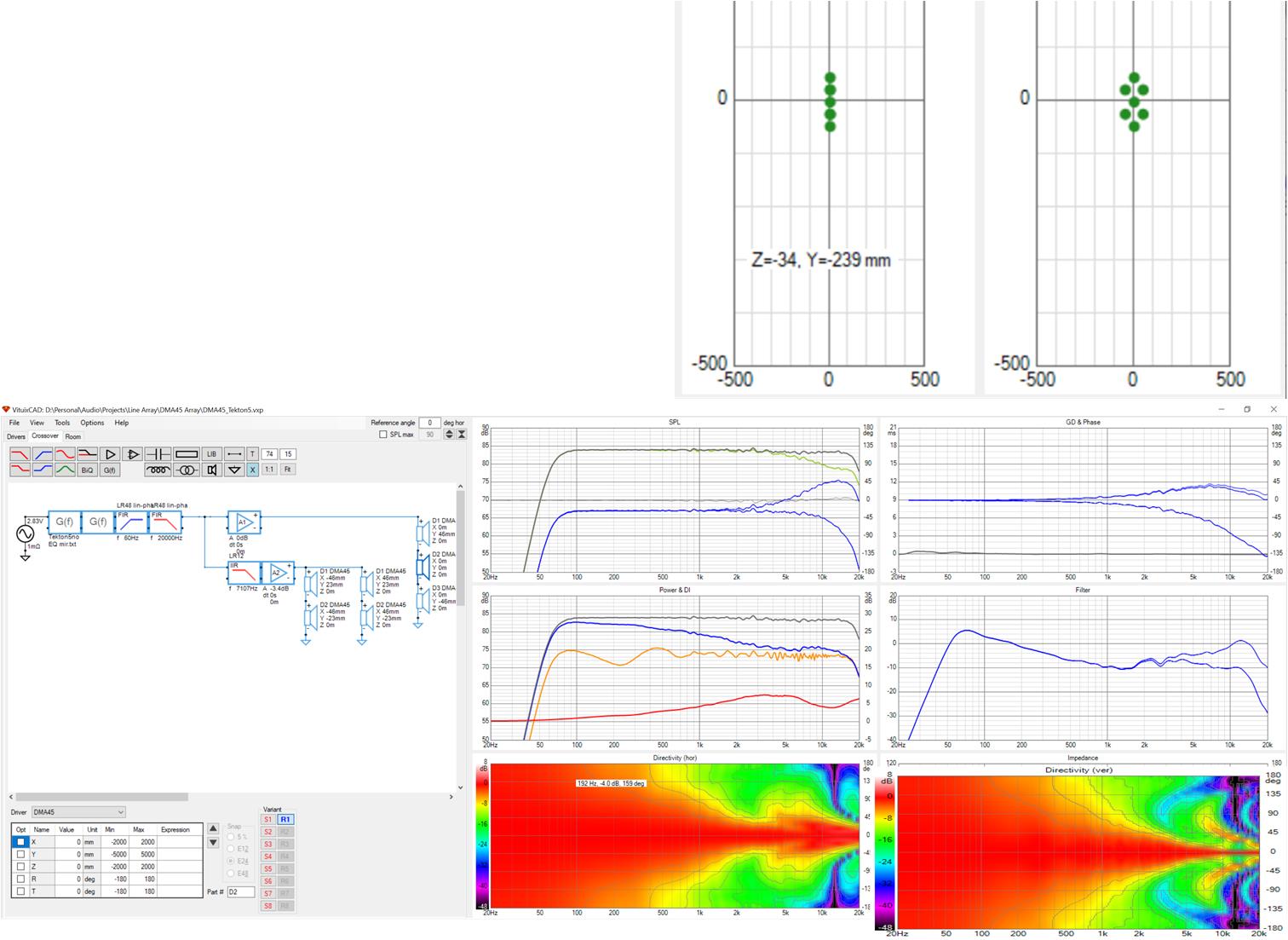

Its fairly easy to model Tekton in Vituix. I put up the array and did a DSP XO, trying to optimize horizontal directivity. Here is a screenshot showing my results
attachment.php
All drivers are DMA45s - 1.5" full range driver. My issue with these drivers is the response is too wide giving too much boundary interaction. I overlap all the drivers, low passing the outer columns and adjusting delay and SPL for best horizontal polars. The response narrows nicely compared to that of a single driver but I think the vertical response is too narrow so I would work on that.

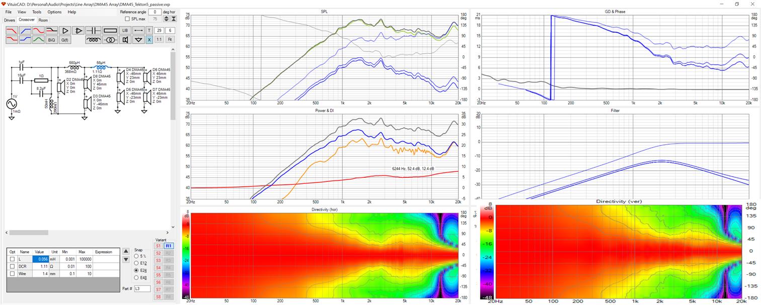

I finally managed to get the XO posted earlier captured and choose inductors for best polar responses. I made no effort to equalize the magnitude response. The DMA45 has a rising response in the HF that makes it good for line arrays but which would definitely require a trap in a passive XO.
The first horizontal inductor, 560 uH determines how high the two drivers above and below the central driver are allowed to play and thus control the vertical directivity to a large extent. The 2nd horizontal inductor controls how high the drivers in the outer columns play and thus controls the horizontal directivity. You can see the filter characteristics in the middle right graph of the screenshot
attachment.php
These are really nice polars to work with for completing the loudspeaker design with vertically flanking midwoofer and woofer pairs. Keeping the horizontal response width to below 45 degrees for much of the range helps eliminate early reflections from adjacent walls. The too narrow vertical directivity of my first post has been corrected, perhaps over corrected...but I think I would need more drivers in the central column to narrow it significantly

I am no XO expert but this is what it looks like to me:

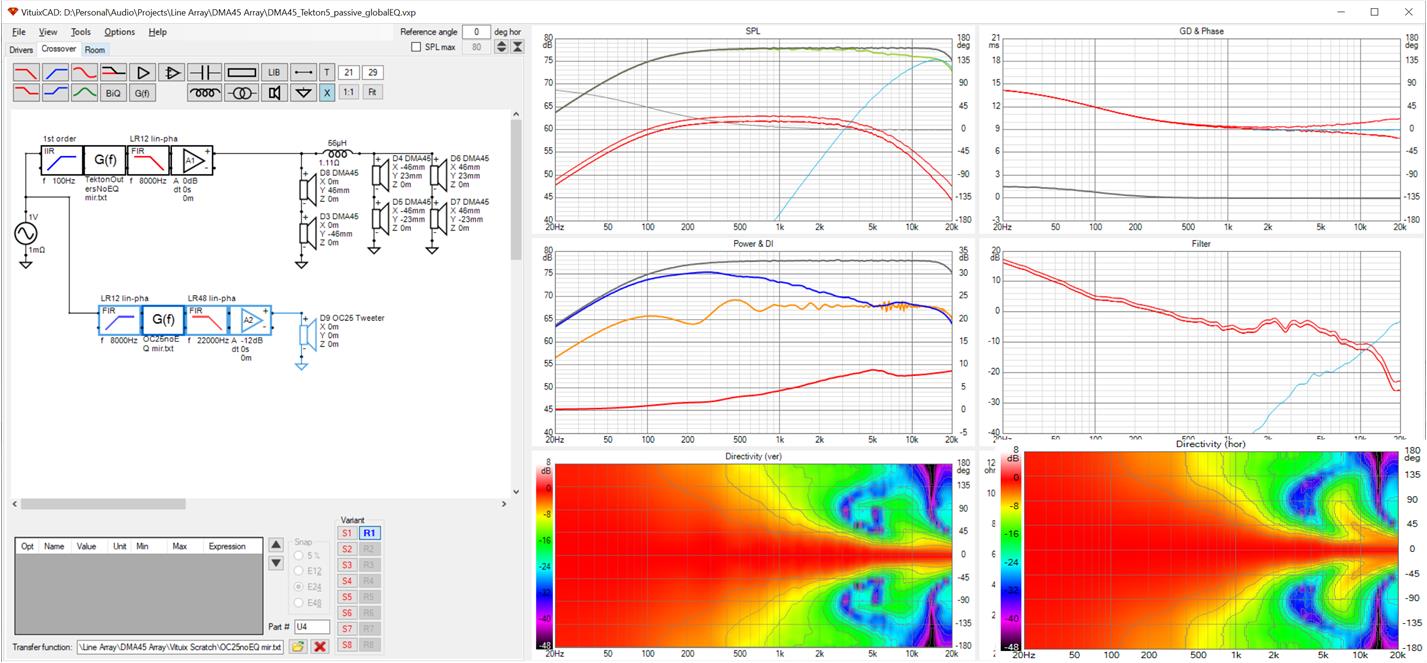

Have you considered replacing the central driver with a tweeter and use the full-rangers as you laid them out?
Actually I have although this time i arrayed TC9s with central tweeter and used DSP in XO
attachment.php
the room response curve in the middle graph (orange) just has wall reflections enabled. Due to directivity and 45 degree toe in, they are very limited. If I had enabled them, you would see a lot of reflection nulls shrinking as frequency rises again due to directivity.
From one point of view, the dispersion of the OC25 tweeter is too wide, its tamed be the array but still widens above the 8 khz XO. The DMA45 didn't have that problem but one probably wants a driver with higher power handling and efficiency to handle the top range by itself
