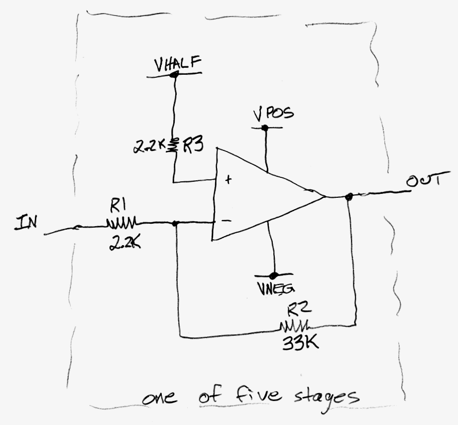

The standard measurement procedure is to connect 5 of them as a ring oscillator and then measure the oscillation frequency, propagation delay, rise time, fall time, and power consumption. From those measured quantities you can derive all the performance specifications you like.

To be pedantic nothing is being turned on and off here. We are amplifying a square wave.
If the intention is to drive something as a logic signal a comparator, not an opamp, is the best way.
If just amplifying a signal that's a 5kHz square wave most opamps have a healthy gain bandwidth in the tens of MHz so will handle this. The clear exception are ultra-low-power opamps and the LM358.

My load is very little
It only feed a Oscilloscope
Your biggest concern is probably the input capacitance of the scope then. If you want good fidelity on the pulse you may also want to use the 50 Ω input impedance setting on the scope (or a 50 Ω terminator if your scope doesn't have built-in 50 Ω termination) which will render that LF353 pretty useless. Then again, for 5 kHz (so maybe 50-100 kHz bandwidth) you could choose not to worry about proper termination or ... <concept> ... use a scope probe.

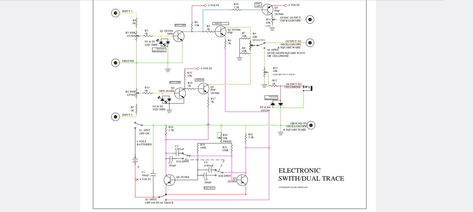

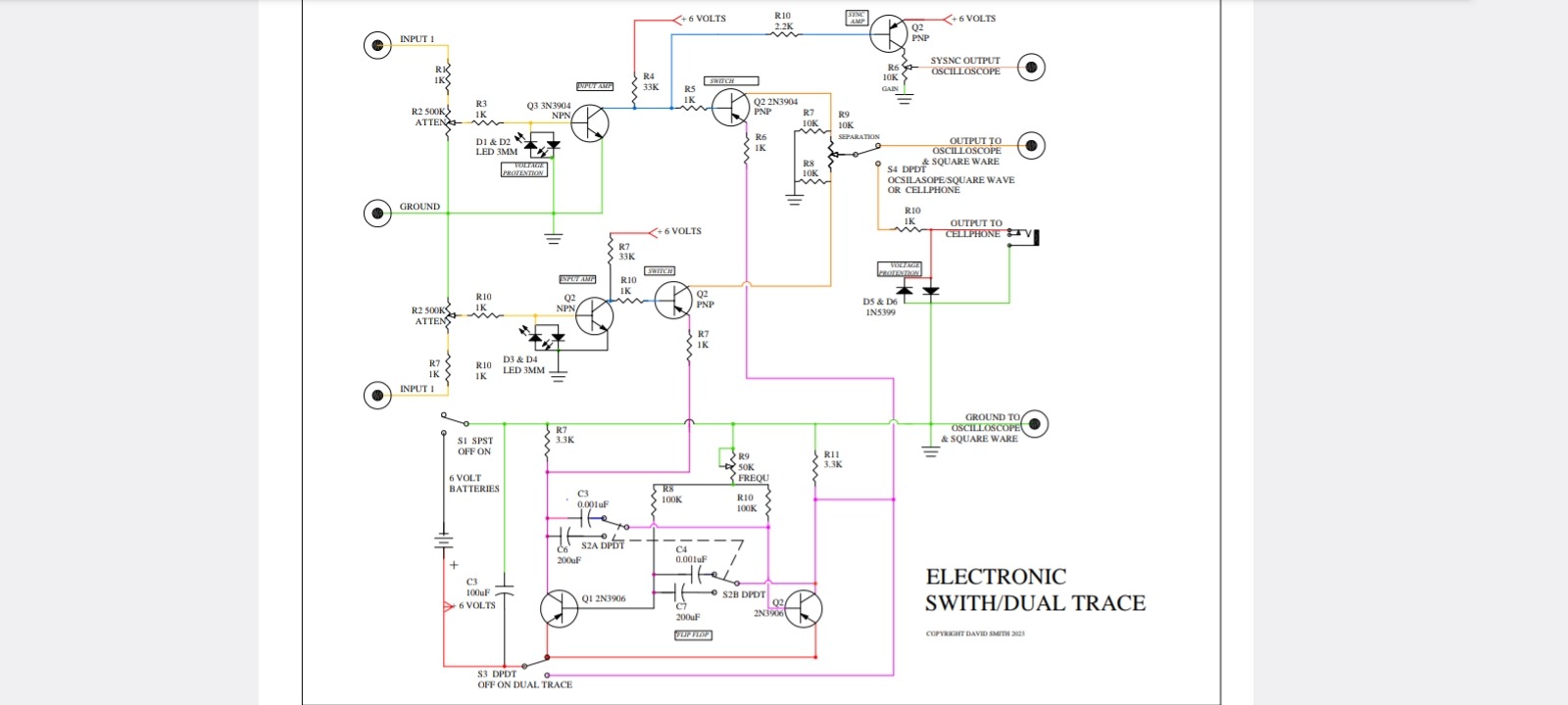

This what looking at .
It is good 100MHZ.
  • ELECTRONIC SWITH OCT 12 2023.pdf
