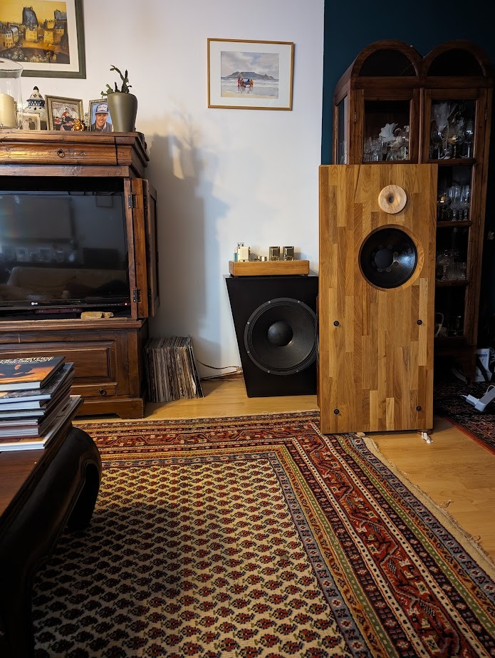

I have no "real" issues btw. These subs I have now are fantastic! I am as happy as a pig in ****. Previously I had a closed sub 15 Eminence Delta 15 LFA. in a small closed box. Facing each other because of the way I built it. And it was fine. But not as tight and present as I wanted it to be.
I just bought these diy subs yesterday and they are front facing. I'm suprised I even had to lower the volume button. Not even 9 o clock. Here a picture of one side.. I was just curious about a boost setting...sort of as a "loudness" button during lower volumes. But I might start looking for a measuring setup to get rid of guesswork.

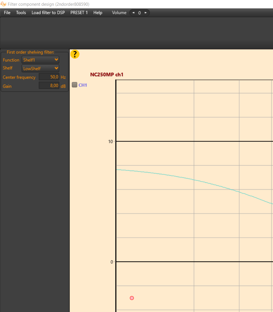

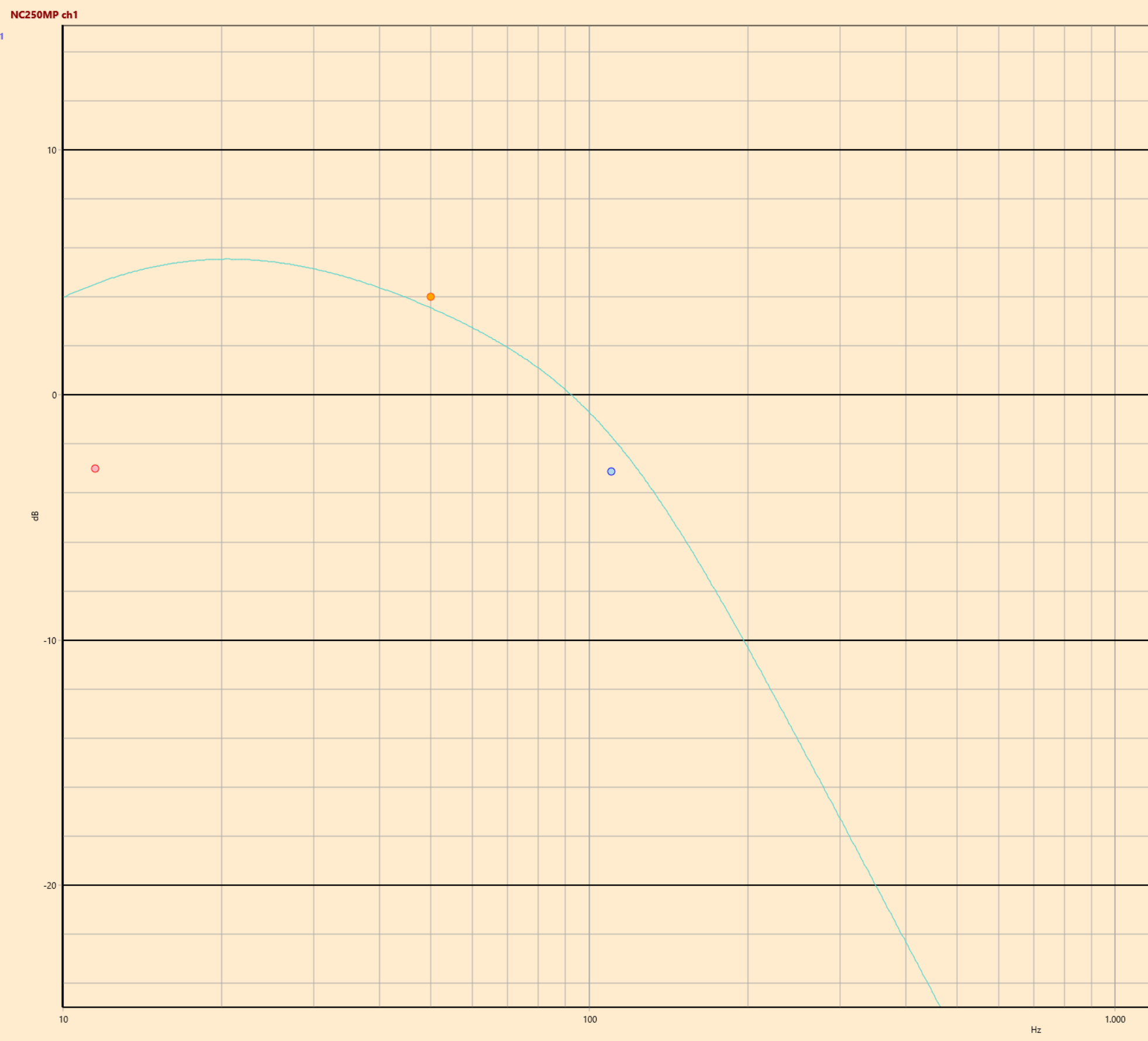

My low level listening preset. Shelf filter 50Hz/8dB boost. (Don't know what shelf filter is...but it's in the software)
I've gone for a higher cutoff. 110Hz 2nd Order lowpass. And 11.5Hz highpass.
I'll make preset 2 for higher listening level. Same as here but with 50Hz/4dB shelf boost
