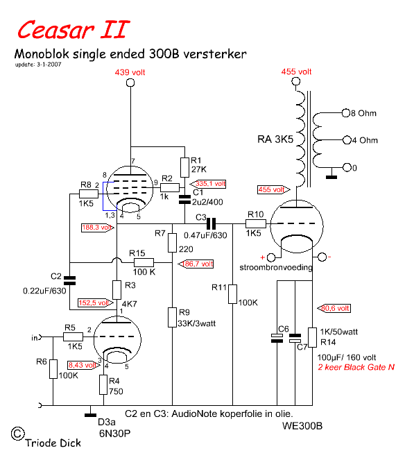

I was wondering if anybody knew of a great 300B design that uses the D3a as the driver. I have searched this forum and eleswhere but I continue to only come up with a DRD topology.
I recently sourced all the parts to build the JEL 300B and bought an extra set of OPTs from James (6123HS). I was toying with the idea of using this D3a in a 2A3 project I am completing but went a different direction with that one. In the process I picked up 4 of the Siemens D3a drivers and now I am thinking I might try them in a 2 stage D3a/300B amp since I have the parts (some of them at least).
Any suggestions for some designs? I wanted to stay away from the DRD designs b/c my power transformer selection I have won't get me the voltages I see with most of these designs.

If you have a centre tapped V+, you can use a full wave rectifier bridge on the outer connections, and leave the centre tap open. 250v-0v-250v becomes 500v; DC voltage will be about 500v x 1.41= 705v: should be enough for the DRD amplifiers.
You probably will have to use solid state diodes.
Or you can just use the schedule talked about for your 2a3 amp. 1e stage a ccs loaded d3a, coupling C, last stage a standard 300b stage.
greetings, Paul
Ha ha Jaap,
I think he wants to use the d3a as an amplifier, not a CCS/Mu stage tube.
On the other hand, it is a good schedule, and a good use of the d3a.
On triode dicks page are a number of 300b schedules with d3a and ecc99 or 6n30p.
Triode Dick's Page It is in dutch, but the schematics and pictures are easy to understand. Just click on "projects".

Ok, this is what I have come up with...
First, Pauldune....I had some errors in the PM I sent you, I think I worked them out here.
This is what I have come up with so far. I dont have a circuit drawing program (yet) so I will write it out.....please tell me what you think.
First the output stage I will leave basically untouched from the JEL300B.
I will be using the 3.5K tap on the primary of the James 6123HS and supply it with a B+ of 435, give or take a few volts.
The 300B cathode resistor will be 880 to 900 and bypassed with a 100uF 160V Elna Cerafine or BG. The grid leak for the 300B will be 220K with a 1K grid stopper.
This is exactly the same as JEL's 300B so far.
For my driver stage I have come up with the following, please let me know what you think and suggestions are very welcome....
I want to use a shunt-mod for volume control with a 50K pot and a 47K pass through resistor for thesunt mod. As I understand the volume control resistances with be my "grid leak" resistor.
The D3a will be wired triode and supplied with a 160V B+ via a resistor off the main B+, I will add an additional RC filter stage here with about 50uF....all to bring my driver B+ to 160v.
The plate load will be my K&K CCS set at 20mA with a cathode resistor of 75-82R bypassed with a 470uF Cerafine or BG.
This stage will then be coupled with a 0.33 PIO Russian K40 type cap.
Thats it......did I leave anything out?

I'm at work now, so I cant do much now, but i'm going to draw you a schematic this evening. I think its going to be much simpler than you expected. You cant drop the voltage to make the b+ 160v, because then the ccs has no working voltage anymore. With a appropriate heatsink the ccs does everything for you. Just choose the right current, and make shure that your ccs can handle the voltage it has to drop. (about 300v but it should be able to handle 400v(i dont know the k+k modules)) power dissipation in the CCS is then about 20ma x 300v= 6 Watt.
The CCS regulates the dropping voltage to keep the current constant at 20ma. so if the plate swings up, the dropping voltage swings down, just so that the current stays 20 ma. The cathode resistors you have chosen give you a V plate of approx. 180v. I would use the 75 ohms.
