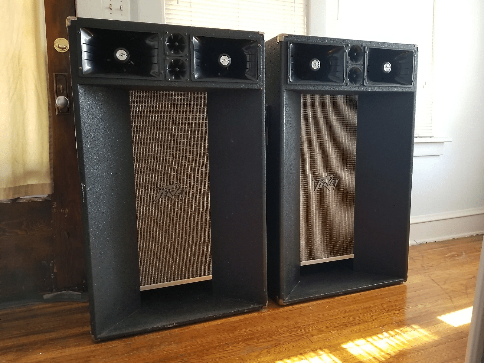

Hello, I have been searching to no avail online to answer a question about impedance wiring, crossovers, and amp load. What I have are some very old 70's PA/Musician speakers that I use both for music on solid state amps and my guitar tube amp as well. These old Peavey speakers had a passive crossover that I am working to redesign and things have become a bit too complicated for me. Originally 2x 15 inch 8 ohm woofers in parallel back to the crossover (so 4ohm), 2x 45-ohm horns in parallel back to the crossover (so 22.5ohm) and 2x piezo tweeters which don't have an ohm rating back to the crossover. It's not a good design, and the tweeters im going a different route with which will match the woofers impedance, and I ended up putting in a single 4-ohm woofer instead of 2-8ohm's. I am also making different cabinets. Each bank of parallel speakers has its own signal coming from the crossover, and the negative terminal just daisy chains around all of the speakers. To me it appears that each bank of speakers effectively parallels all the speakers at the crossover. (All passive crossover design's are this way). Does that not mean they are all paralleled? I read in a few forums that speaker banks at the crossover do not parallel and the amp will see them individually so 4+22.5+4 instead of whatever the 5 speakers would be paralleled together. Is this true? can someone clarify how this makes any sense?
Now for the nitty gritty, 4+22.5+4???? okay so I have also read if you are mismatching impedance that you should use similar impedances. Well, those are definitely not similar impedances. The crossover says (4-ohm) on it but I think this (22.5ohm) may have been damaging my old Randall tube amp. Is this safe to run? What can be done? I don't want to wire resistors in parallel to drop the horn bank more, wasting power and heat, I would rather just completely buy new ones that are rated correctly. They sound decent and I have used them for 25 years on solid state amps with zero problems, but the math makes zero sense to me. So to go a bit further on my impedance question, for simplicity lets say my speakers are all 4 ohm 4+4+4 in each cabinet. Say I connect both cabinet's to left and right channels to my solid state amp. Does that mean my amp is then powering all these banks of 4-ohm speakers? would the two 4-ohm cabinets not also make paralleling and make both cabs 2-ohm total now? Its all very confusing to me. I really don't understand how the crossover which wires 3 parallel speaker banks in parallel doesn't do paralleling. I hope someone can help me I am confused. Thank you all!

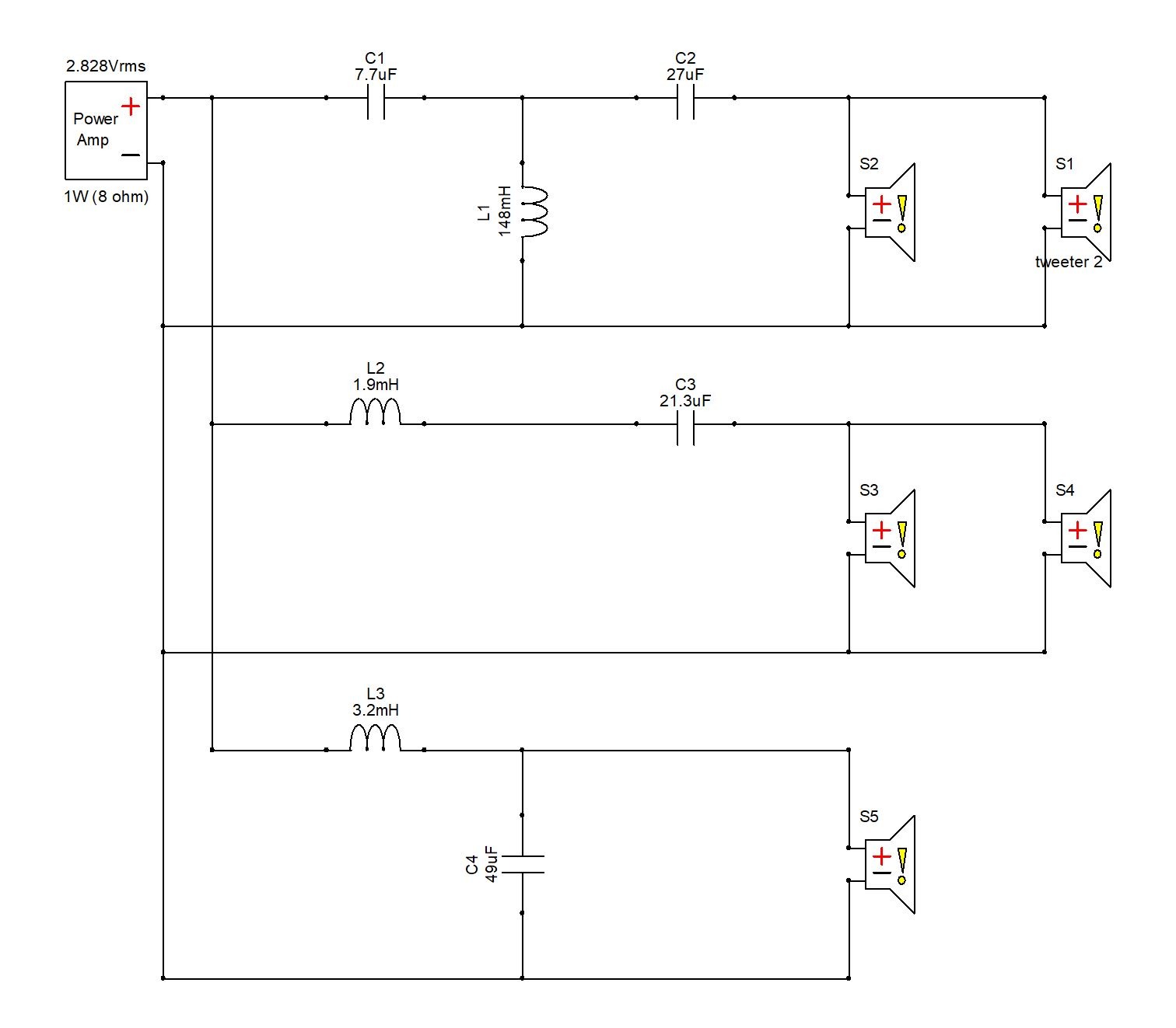

Here is the X-over design currently while i wait on parts
If I understand you correctly, you replaced the piezo tweeters with ordinary tweeters (2 of 8 ohm in parallel) and the crossover component values are all meant for 4 ohm, but the midrange section actually sees a 22.5 ohm load. Is that correct?
If so, with this specific crossover circuit, I would expect a much widened passband for the midrange, so the midrange horns get more bass and treble than intended. I wouldn't expect any damage to the amplifier.

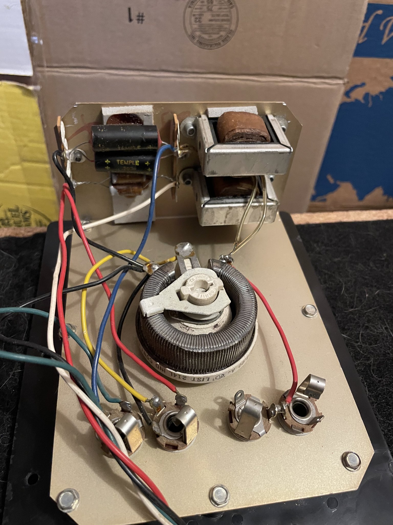

So that giant variable resistor (1-Amp, 50-ohm) I thought was just to drive down the DB which the horns need about 9 DB reduction and it sits at about 40ohm in series with them and is how the resistor was originally wired in. So that alone is enough to stabilize the amp from the 22.5 impedance??? <-- My main concern!! Yeah that diagram is something i've been working on and yes its completely mixed order due to many factors (mainly the cost of large inductors is why the mid section is a 1st order). Now that photo of the old crossover shows the original design where they had signal go through the giant variable resistor and then splits one off to the piezo bank with no components and the other goes through two paralleled 5uf caps (so 10uf) and then off to the horn bank. On the woofer it had two 2.6mH magnetic chokes paralleled with each other (so something like 1.4mH in series and then 2x 25uf caps paralleled with each other (so 50uf) shunted to the negative terminal. I mean i completely get what's going on as far as frequency control here. I just want to make sure those horns are safe and not going to break something. The new tweeters whenever i decide what works I will like either get an L-pad attenuator separately for them or just build resistors on to them once i get the freq response graph even.

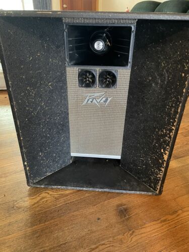

Yeah that is is unusual to say the least. There was a Peavey 115 vocal master and it only use a single paging horn... which makes sense as they are capable of much higher SPL than the other drivers, so not sure why you decided to use 2 of them in your version.

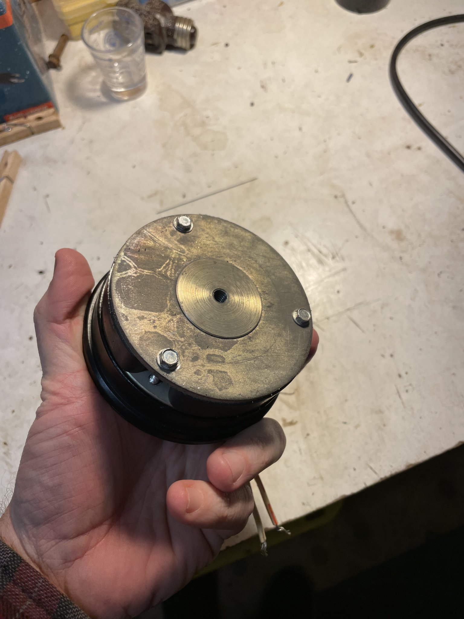

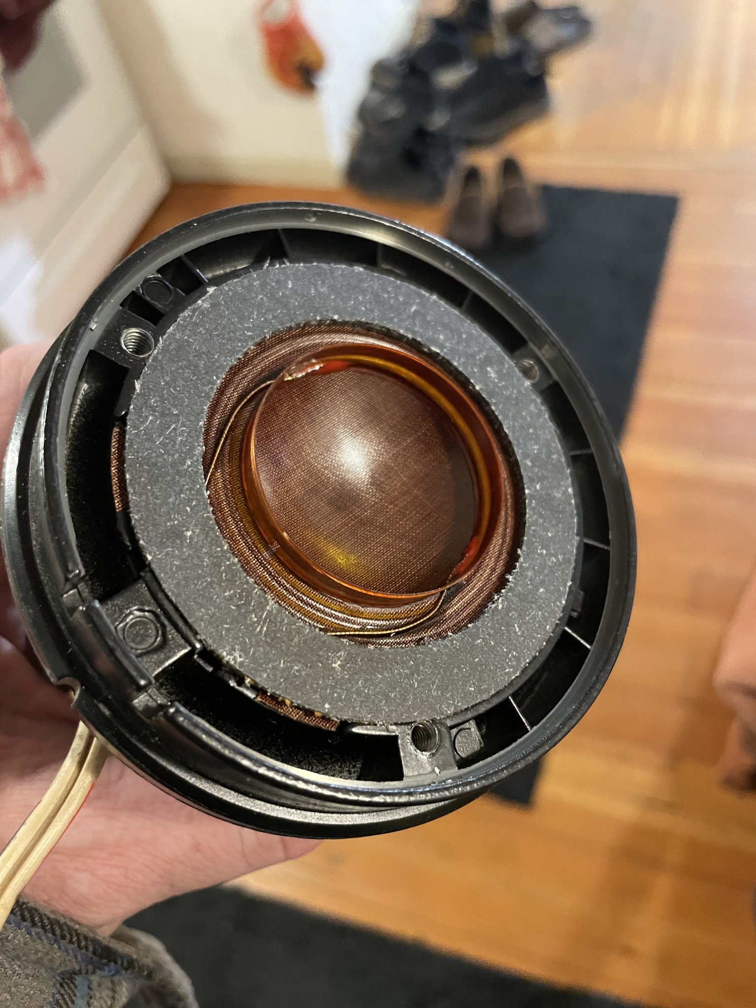

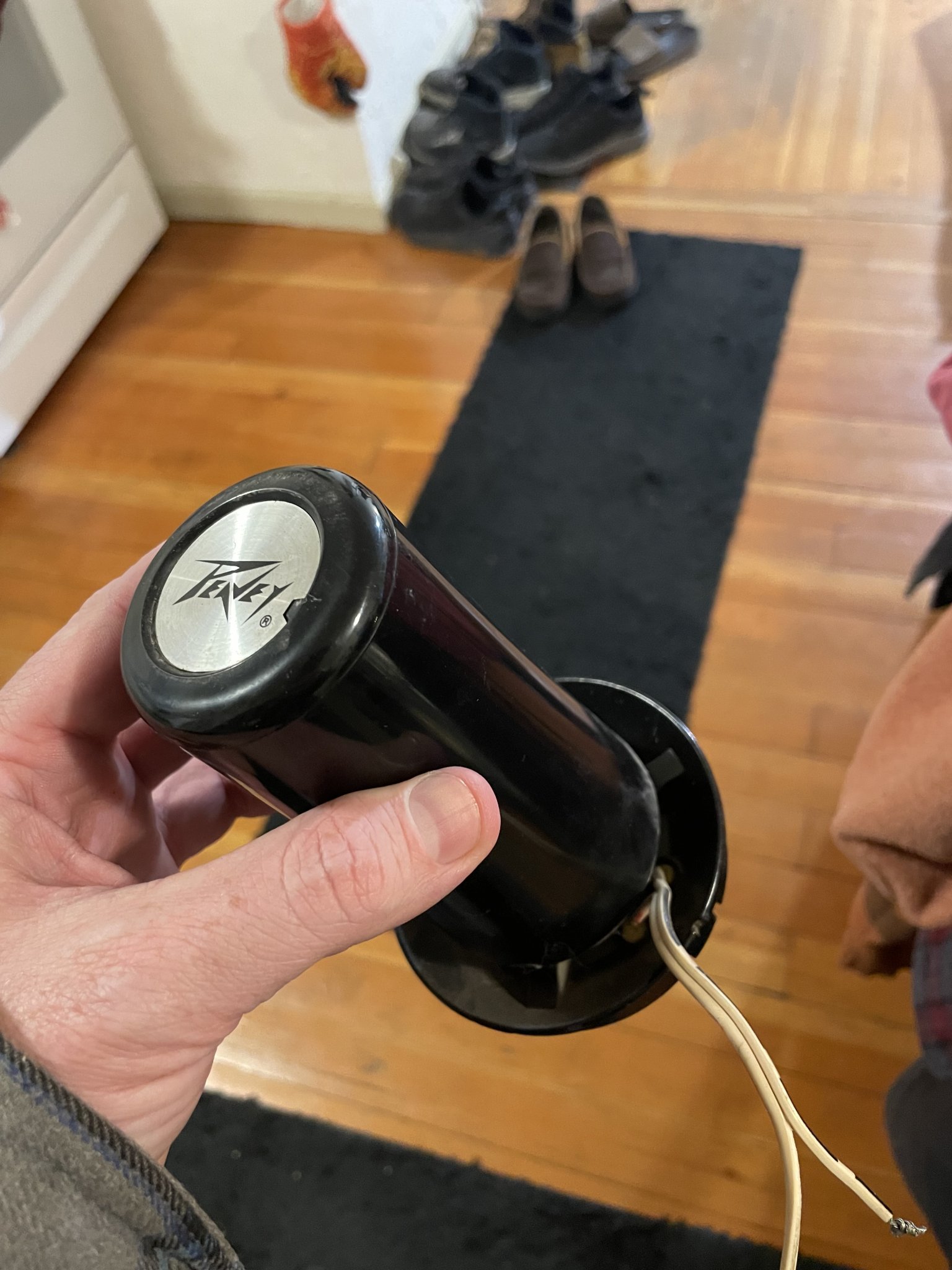

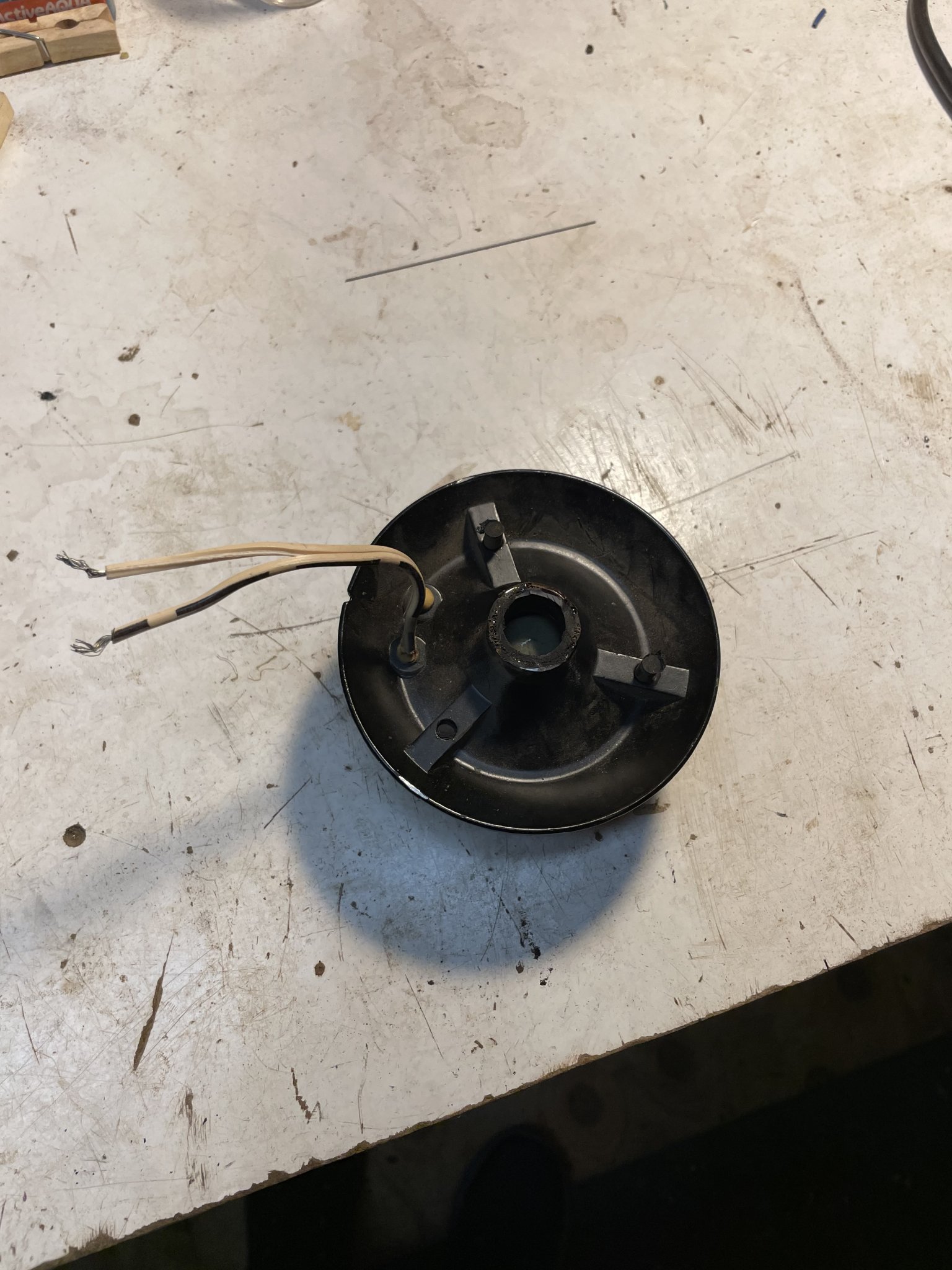

Do you have any pictires of the driver on the paging horn? Is there are transformer inline with them? You say you put a 8ohm diaphram in one of them? That should work fine assuming it fits properly, the hum you describe can't be caused by it so there must be something else going on, what were you powering the speaker with at that time?
The basics of a passive crossover is that it has to be designed for the impedances of the drivers it will be used with... if it isn't then the resulting acoustic response of the speaker system will not be what you had planned. So if the number or impedances of drivers are changed then the crossover needs rework.
The low freq driver/s in a fullrange speaker system with passive crossover essentially determines the overall impedance presented to the amplifier as the majority of power resides in the lower ranges, Good designs typically have a fairly uniform driver impedance across the whole audio spectrum but using different impedance drivers in each range can also work well.
With solid state amplifiers a higher speaker impedance is perfectly safe but less power is delivered, but that works out perfectly with compression drivers which usually have much higher sensitivity and don't need as much power.

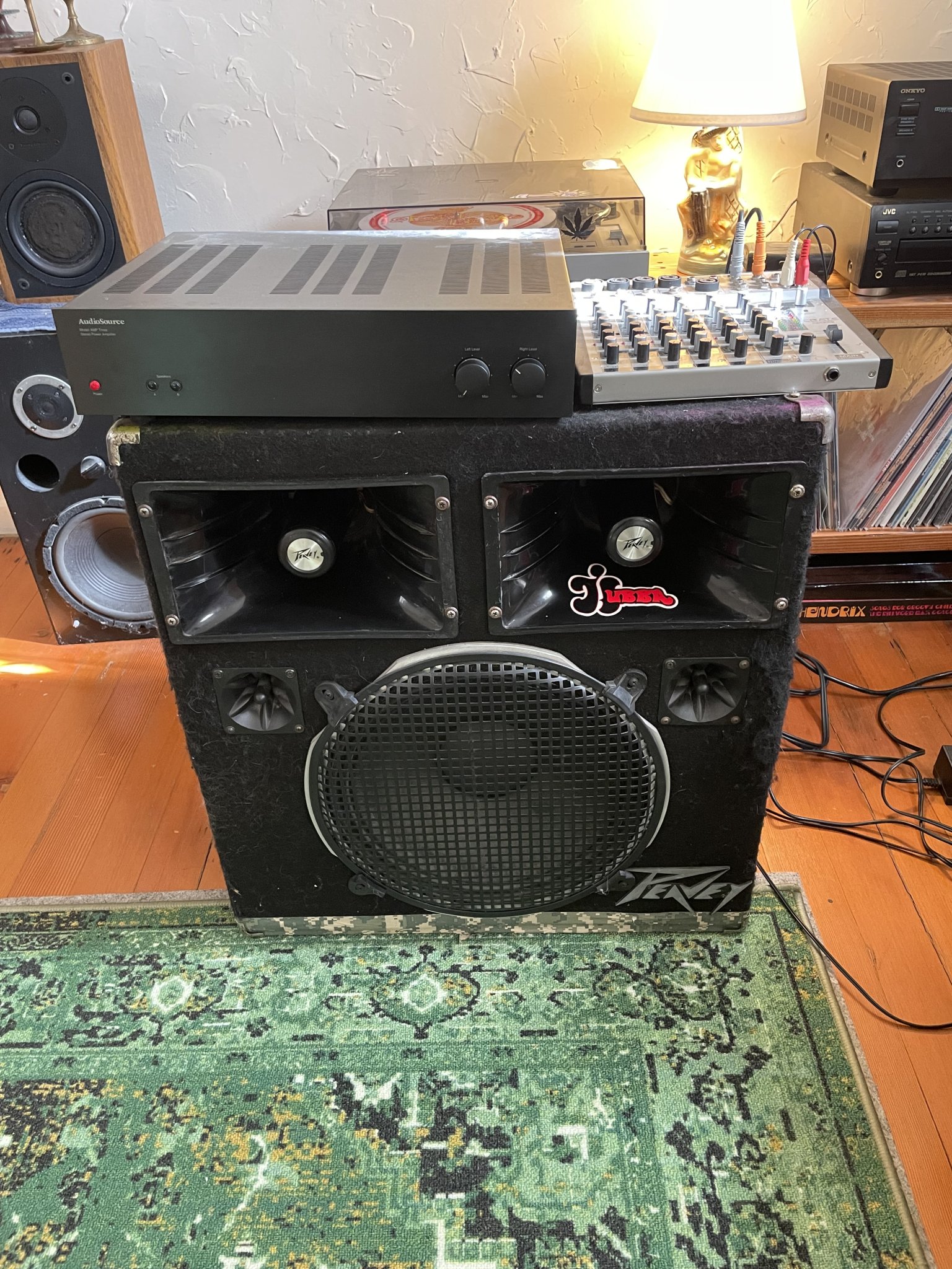

The originals had 2 in them, that's why I even have two in each cabinet. I'll attach an image. Mine are far from original though, the cabinets are long gone. The only difference 2 would really make is a change in impedance correct? I wouldn't think that would affect the SPL of a single horn but idk. No there is no transformer. The woofer's magnetic chokes i thought were transformers at first, I guess they sorta are since they remove AC noise but they are in no way wired with the paging horns only on the woofer. I removed that crap anyway I wanted air-core inductors and it sounds way better with that. Yeah I actually ended up cutting open the one i put the 8-ohm diaphram in since i had replaced it anyway. I mean it hums without a crossover. All of these speakers have individually been tested alone so i could see them on a freq analyzer. The horns are limited from 500hz-3000kz. And all that crap on the front of the horn blocking it blocks upper frequencies and yeah also proabably helps SPL. I cut all that off to get to the driver alone and it still doesn't hit 3khz. Really it doesn't hit that on either the 45ohm or the 8-ohm so roughly around 3khz is my crossover point. To really get everything as good as possible i had to do 400hz and 3200khz on a 3 octave scale as my best bet. The woofer can easily go beyond 400hz so its not an issue, and replacement tweeters will cover down past 3khz to so it should work. I just think running 22.5 ohm on an amp not rated for anything like that is wreckless of me. Same with a single 45-ohm horn. If I could get away with a single one I would do my new design that way definitely. 2 of everything is really stupid but ya know its also a learning process.

Yes using 1 horn is entirely possible.. PV did it back in the day and it has become the basis of most modern PA speaker designs. The 22ohm impedance of a single horn is no issue to a solid state amplifier so don't worry about it, just make sure the crossover you build for it is designed around that impedance.

I just realized that's not a variable resistor. It's a rotary rheostat. And now im trying to understand the difference between it and a potentiometer. One thing is it variably adjusts the signal current. The other thing is that the negative terminal of the horns come back to the 3rd pin and they are 18-ohm until they touch that 3rd pin on ground and that makes them 45-ohm. Absolutely bananas. Somehow that things is designed to retain a 45-ohm load despite the volume (And also despite the parallel wiring which would be 22.5). Maybe someone can understand better. the Rheostat says 50ohm on it so maybe thats it's purpose is to force a 45-50ohm load on the amp regardless of what the drivers are. And who knows what the impedance really is, I am just measuring DC resistance. Maybe these can't run on a tube amp without swapping the horns.

You are treating the crossover as not being there. The amp sees the impedance of the crossover & driver system, not the impedance of any individual driver. You need to put the driver & crossover measurements in a crossover simulator to plot the impedance the amp sees at each frequency. Note this crossover has the typical 4 jack Peavey interface, 2 overall jacks and a high section and low section jack for bi-amping.

Your 50 ohm rheostat is not shown on the crossover schematic. The difference between a rheostat and a potentiometer is that the rheostat does not have connections at both ends of the winding.
