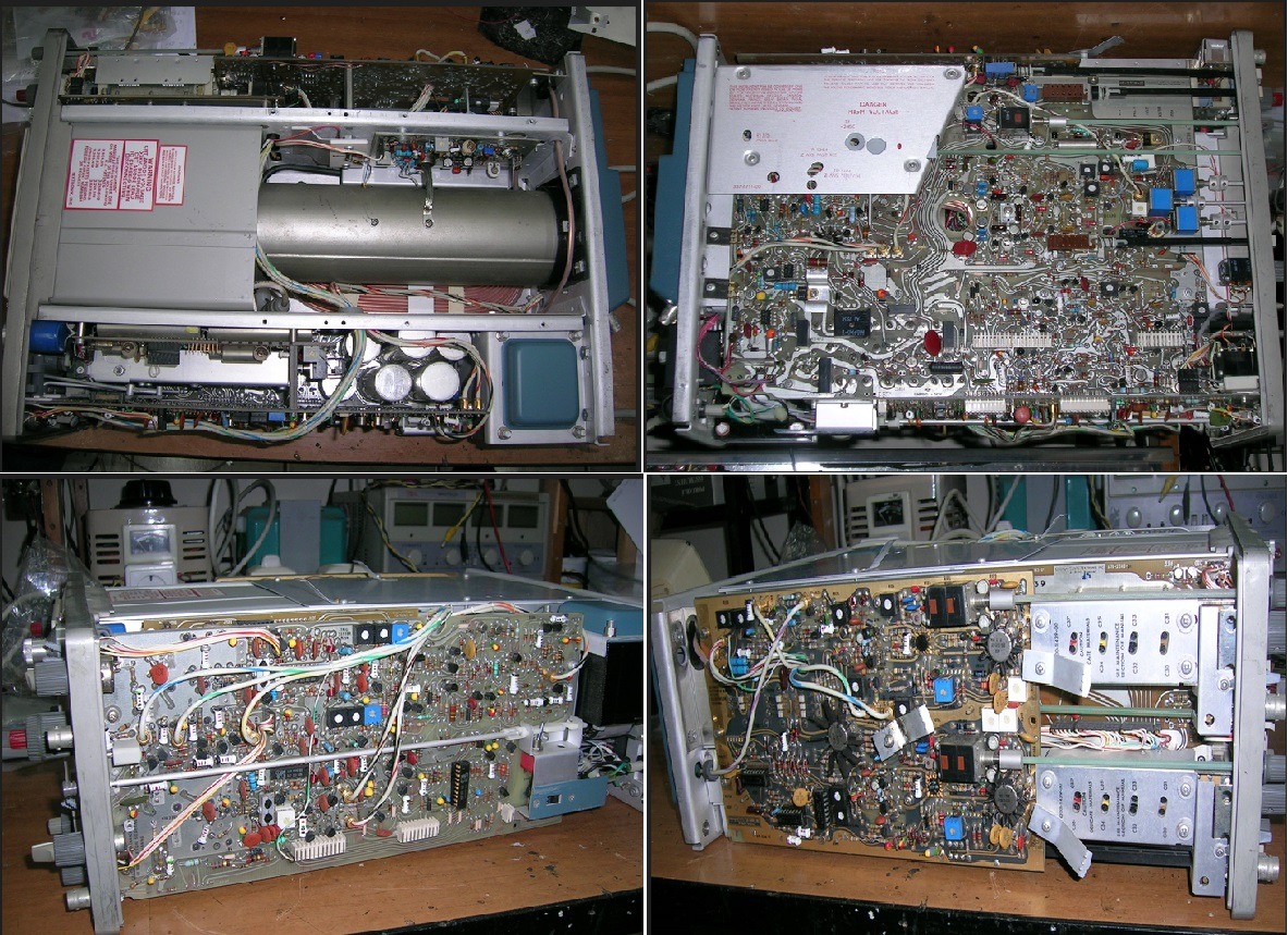

I did I gave away the old analog scope that I had for almost 20 years when I moved.
So when it came time to re-set up my bench I looked at the modern scopes, and it's amazing
to see what even a new digital budget scope can do as compared to an older analog scope.
So if you are looking for a scope you may want to take a look at the new digital scopes.
But I will say if you have an older analog scope now you may want to hang on to it
if you have room for it since they are fun to play with for oscilloscope music etc.

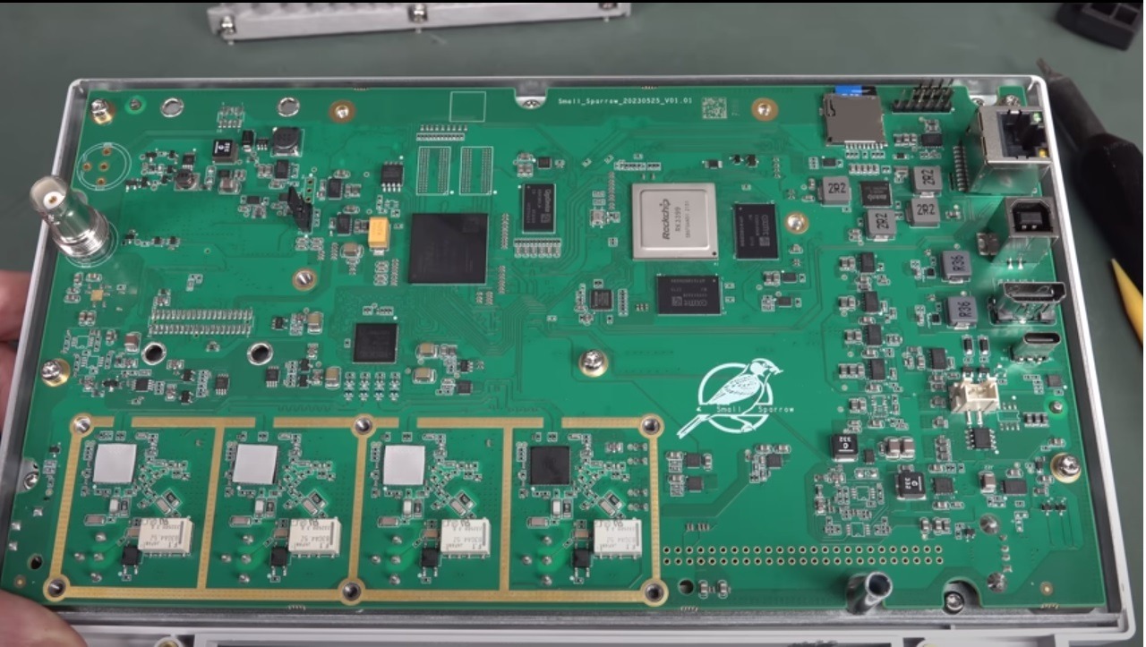

it is amazing to me they can make these things at the price point.
System integration (one PCB, custom ICs ect), SW control
