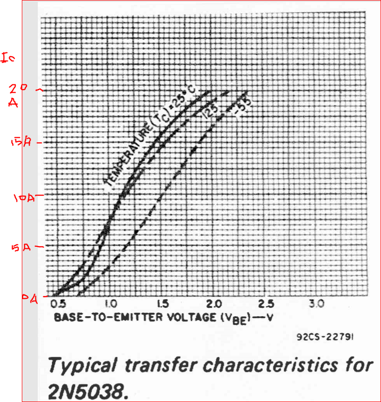

I think it would have been better if you had chosen BDV20 devices when you bought your modules but these are no longer in production. Possibly the niche in the market has been taken over by power FET's - I could not find a modern equivalent. I note the latest NCC uses MJ15003/15004 outputs.
Anyway 2N5038 is a device I remember from the 1970's which is still in production and you might consider this as a prospect as a drop-in replacement.
I have an old RCA Power Devices Handbook and the graph of Ic/Vbe is a little unusual and interesting since the best place in a Class AB amplifier for switching is where the plot is flattest and making the distance between sample points as small as possible.
The latter would be aided by reducing the switching times - a specification you get with this device but not with MJ15003.
The graph for 2N5038 is unusual in that it has two steps in the turn on region and at 25 degrees C conduction starts with a Vbe a little less than 500 m.V.

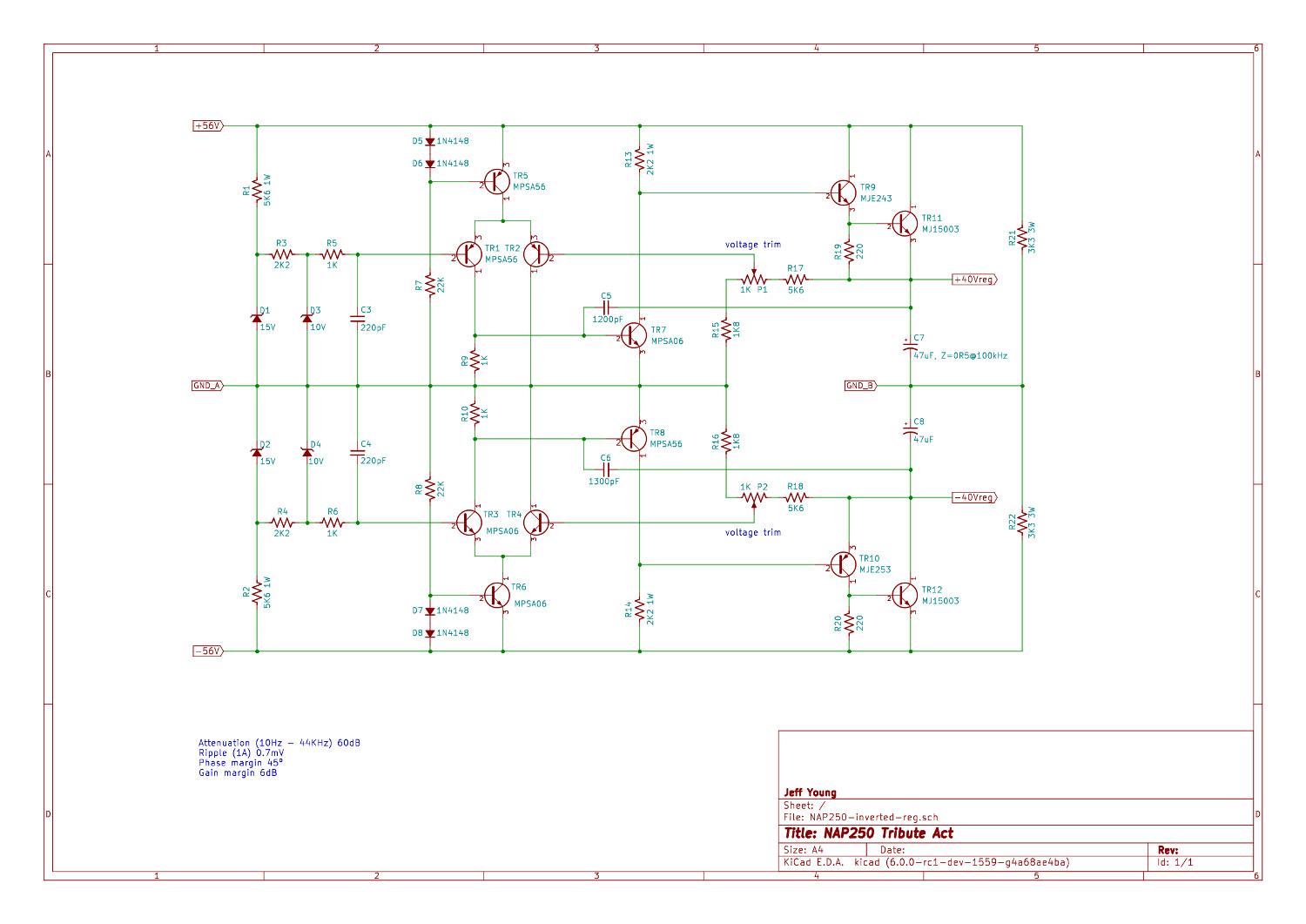

For my boards I have 10 Siemens BDY58s and 10 Motorola BUV20s. Since it appears that the cheapest way to get a Naim sleeve is to buy an olive series NAC102 or NAP180, I might as well spend a bit more on the 180 and get 4 NA001s and a "proper" transformer.
Current plan is to build 2 sets of regulators and 3 sets of amp boards. One set of regulators will be classic NAP250; the other will be with the VAS inverted for a cleaner reference and a CCS for the LTP:

Not sure which regulator set should get BDY58s and which should get BUV20s....

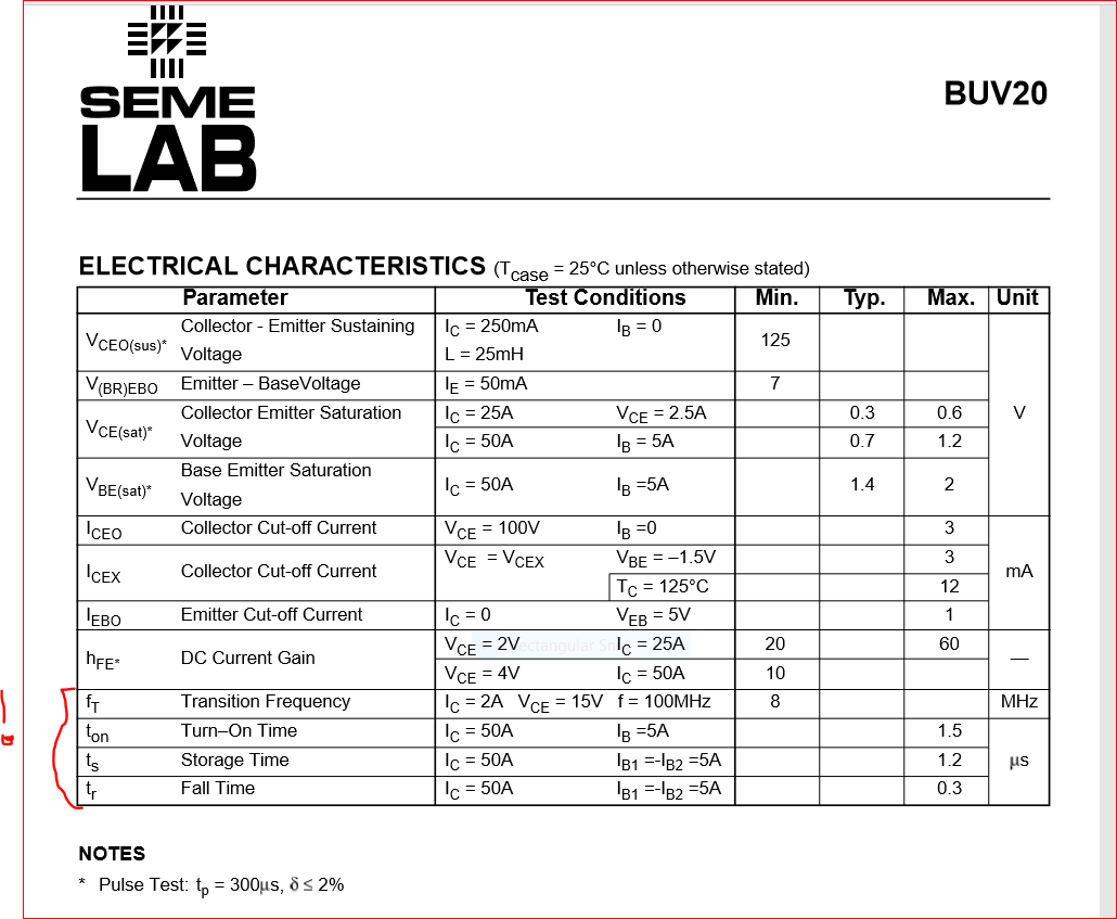

Yes specifically but also to others generally interested. I was concerned that my comment about the Gain Bandwidth Product of MJ 15003 and that it might be your intention to use these. Good for you that is not the case.
I looked for datasheets for the BUV20 and found one from Semelab which is attached.
The BUV20 Gain Bandwidth Product has to exceed 100MHz since the gain at that frequency is 8.
The 2N5038 has a gain of 12 at 5MHz some references extrapolate that to an fT of 60MHz.
The BDY56 or BDY58 were used in Naim amplifiers in the 1970's these have an fT of 10 MHz.
The MJ15003 has an fT of 2MHz ( a gain of one).
You already have ten BUV20's (Motorola) so you could use 4 of these in your present board and if you buy a Nap 180 spend a bit of time doing some listening comparisons before deciding what to do next.
The regulated supplies in the Naim NAP250 had resistors in the raw supply lines with transistors monitoring the voltage drops across these and if the voltage drop was too high in the resistors in either raw the sense resistors would activate a 2 transistor trip arrangement to cut off the supply.
Also there are no load line output short circuit protection transistors in the main amplifier.
I think Naim wanted to minimize the chances of come backs for repairs.

The Motorola BUV20 datasheet (attached) has a bit more data than the Semelab.
I didn't have as much luck with the BDY58. The Comset datasheet (also attached) has a bit more info than the typical Semelab, but not by much.

Possibly with BDV20 outputs you may get away without the load line short circuit protection in the amplifier module.
I think it would be good policy to include the trip circuit for the regulated supply - I have built a couple of pairs of these and I know they work the trip is not activated in use but it would be if the output or either of the supply rails is shorted.

The BUV20 Gain Bandwidth Product has to exceed 100MHz since the gain at that frequency is 8.........
I may have misunderstood the method all along but the Semelab datasheet states that at F=100MHz, Ft is determined to be just 8MHz - i.e. a gain of only 0.08. This is more in line with older BJT power switching devices such as SGS-Thomson's BDY56,58 which followed the original Solitron and apparently other similar switching types when they were dropped due to reliability or supply problems.
An Ft of 100MHz for and old-tech power transistor would make it quite an expensive choice, being high in the RF power category. I don't think this was likely in the 1970s or even now.
Thanks for point the error out. I was too wrapped up with the 2N5038 datasheet and applied the wrong logic in the case of BUV20.
