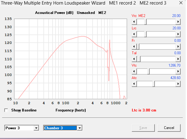

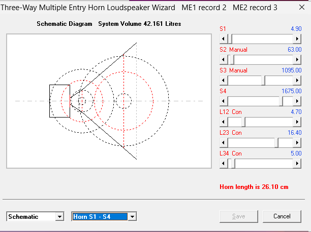

I've made some more hornresp progress, achieving a crude 3-way MEH design. Very basic at this stage; I've not even touched the HF driver or horn throat contours. Really just looking at what output I can get from drivers and their chambers before Xmax. But I'm not confident, as there is so much to get wrong; I was even confusing which fields wanted litres and which ones wanted cc, at one point.
If anyone has a moment, I would appreciate a brief second opinion on the attached records to see if I'm even vaguely getting this simulation right (I've not yet even considered subtleties like tap/aperture shapes etc). I'm particularly keen to know if ME2 (with the Fane 8-225) looks sensible, since I may buy these drivers based on my dodgy sim!

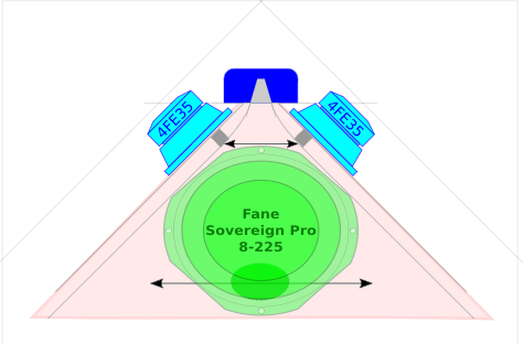

So this is roughly the size of waveguide that I'm envisaging before extensions or flares are added. In practice it'll be rectangular and 90 by 60 degrees, around 50cm wide and 30cm tall. Though with the bass drivers top and bottom the overall size of the speaker itself will be about 50cm tall as well. Thats a bit bigger than originally intended but having worked on the implications of being smaller, my intentions have changed a bit!
This is the maximum output I'm apparently able to expect from the Fane Sovereign 8-255 and the Faital Pro 4FE35. If my crude sims are to be trusted, and before any EQ or further port/chamber/horn tweaking is done to flatten the initial raw response. First the fane 8" for bass, would be used up to say 300hz-400hz depending on how I tweak things:
I can't see myself ever needing more than 100dB peaks per driver, so once EQ'd it 'seems' I could hope for them being flat down to 30hz. Which I'm somewhat suspicious of being true, since that is much lower frequency than I expected from only an 8" with 62hz Fs in a 4th order box. I was intending to use subwoofers up to at least 60Hz; I probably still would, but it would be very nice to have the option of these being full range if/when wished.

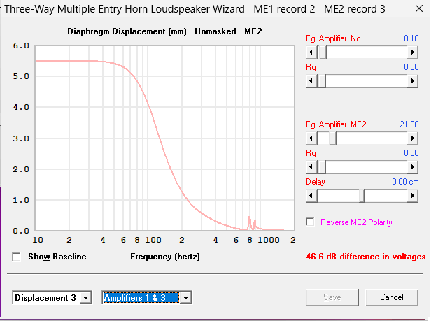

Then the FaitalPro 4FE35 for midrange (something like 300hz-400hz up to 1khz)
Though whilst the 8" Fane is at Xmax in its passband:
The 4FE35 only reaches Xmax a couple/few hundred hertz below its lower cross-over; in reality that will be attenuated and it could then go much louder. So whilst I had doubts about using only two of these drivers per speaker, they seem to be more than enough. In fact one would be enough, though I'll still use two in order to achieve symmetrical taps/apertures:

So I remain suspicious of having cocked up my first hornresp sims somewhere. But if this is vaguely correct then I shall have output to spare. I could consider smaller bass drivers to make an even smaller waveguide, however the bass-driver's tap position means I wouldn't save very much on the footprint, just a small amount of height.

Check the particle velocity at the throat exit port at xmax to see if it is ok. I try and keep below 17ms which may scupper your 30Hz plans. You need a lot of air moving through the port for 30Hz. I tried a pair of lab12 drivers with sealed backs on one test box and EQ'd them for 35Hz. You could easily hear the distortion on kick drum transients when driven at 'decent' levels. (~150W) I use the 17ms figure as that is what I use for normal BP boxes. Apparently the frustums lower velocity a bit like port flares do. (Think that's mentioned in the patent)
Model the entrance ports as frustums if you intend to use them. My mid ports were 0.4cm long in my model.
If you are doing a rectangular horn, use the BWaslo XL spreadsheet to generate your figures to input into Hornresp, this will give you your secondary flare figures aswell. (I use Libre Office for the spreadsheet, )

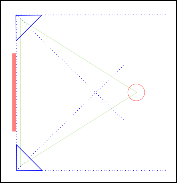

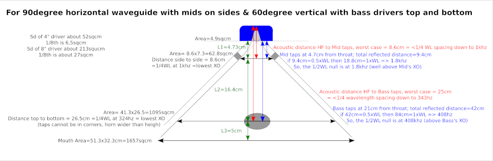

EDIT: FWIW attached is a small schematic I made to work out roughly what was wanted before plugging the values into hornresp. There may well be errors in my understanding, and some things people disagree on too, so it'll be interesting to see what BWaslo's spreadsheet and Hornsrep think of my attempt.

Kev,There may well be errors in my understanding, and some things people disagree on too..
If the side to side distance of the ports is more than 1/4 wavelength of 1kHz in your example, some off axis cancellation may occur.
That does not equal the lowest crossover point, lower frequencies (longer wavelengths) wouldn't have an off axis problem related to the 8.6cm side to side distance.
1kHz side to side distance may be approaching the upper crossover limit where off axis cancellation due to the 8.6cm spacing may occur.
Conical horns will still have other off-axis issues at various frequencies dependent on the horizontal and vertical horn angles of both the first and second (if used) sections.
Art
Thank you, Art. Yes, well spotted; it looks like I got that 'lowest' statement the wrong way around; I was probably thinking of how low the HF driver would need to reach, as that seems to be a pressing limitation. I suppose the impact of any off-axis effects might depend on how far off axis my waveguide is intended to work; in this example 90degrees horizontal and 60degrees vertical.
Perhaps I will change the distances slightly, to better facilitate the possibility of a higher HF/Mid crossover. The midranges will work higher than 1khz, especially with a volume reducer/plug in the front chamber, so i could make more use of their presence (compared to a 2-way).
That would permit higher SPLs for the high frequency driver, if I wanted a 'loud/party' option in my EQ profiles. Though from what Earl Geddes says, I would perhaps find a <=1khz crossover less of a compromise for audio quality (for SPLs at which the HF108 driver can play that low without distortion), which is still by far my main interest here.
