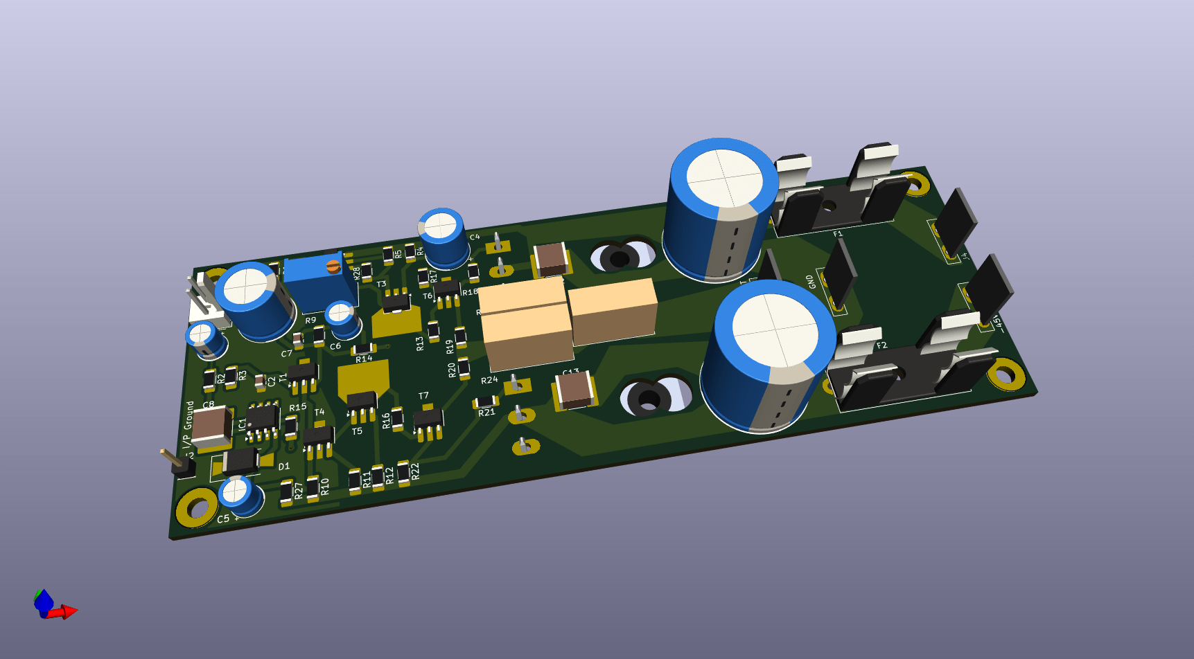

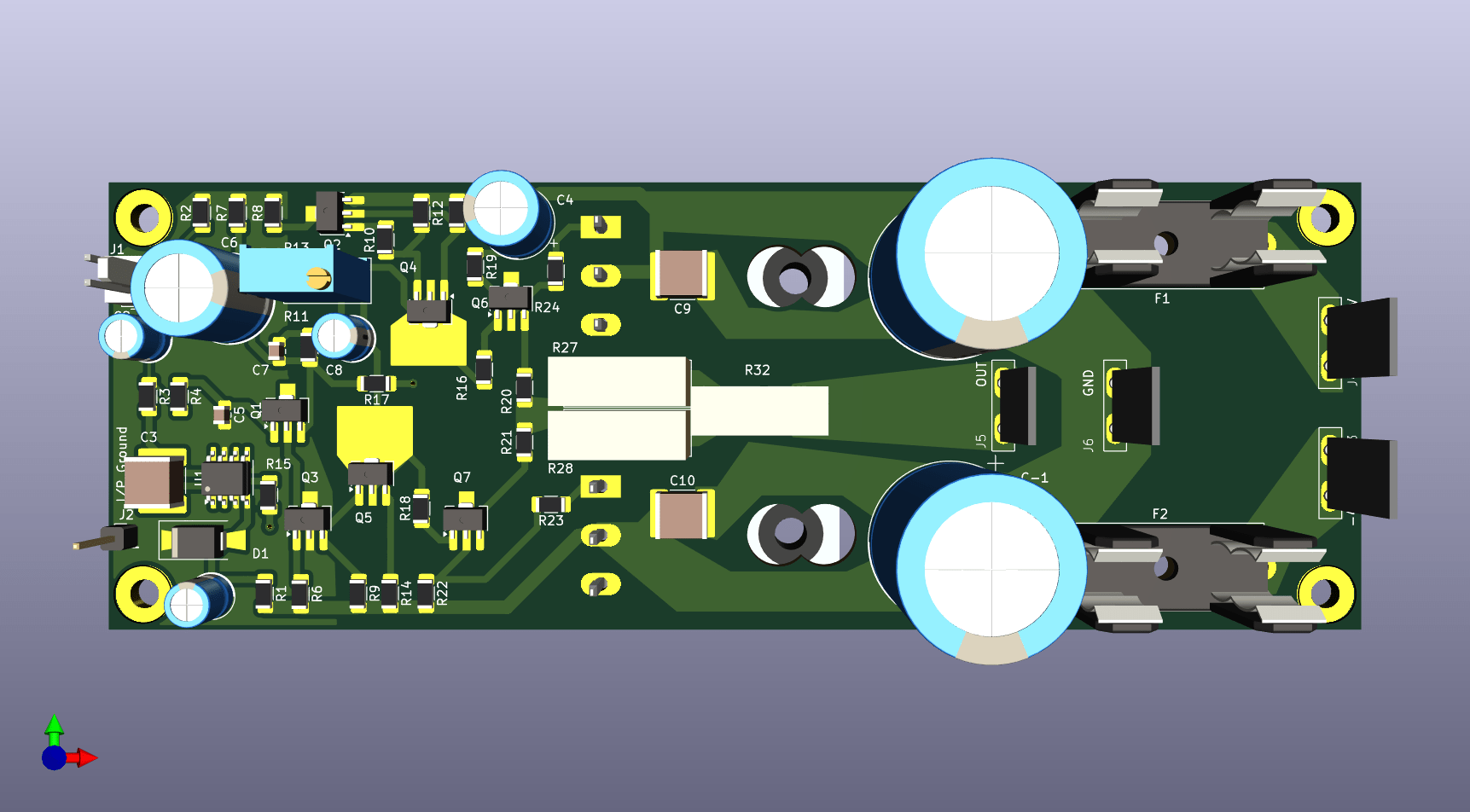

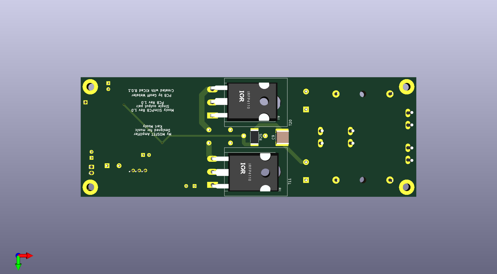

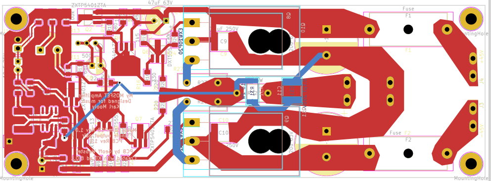

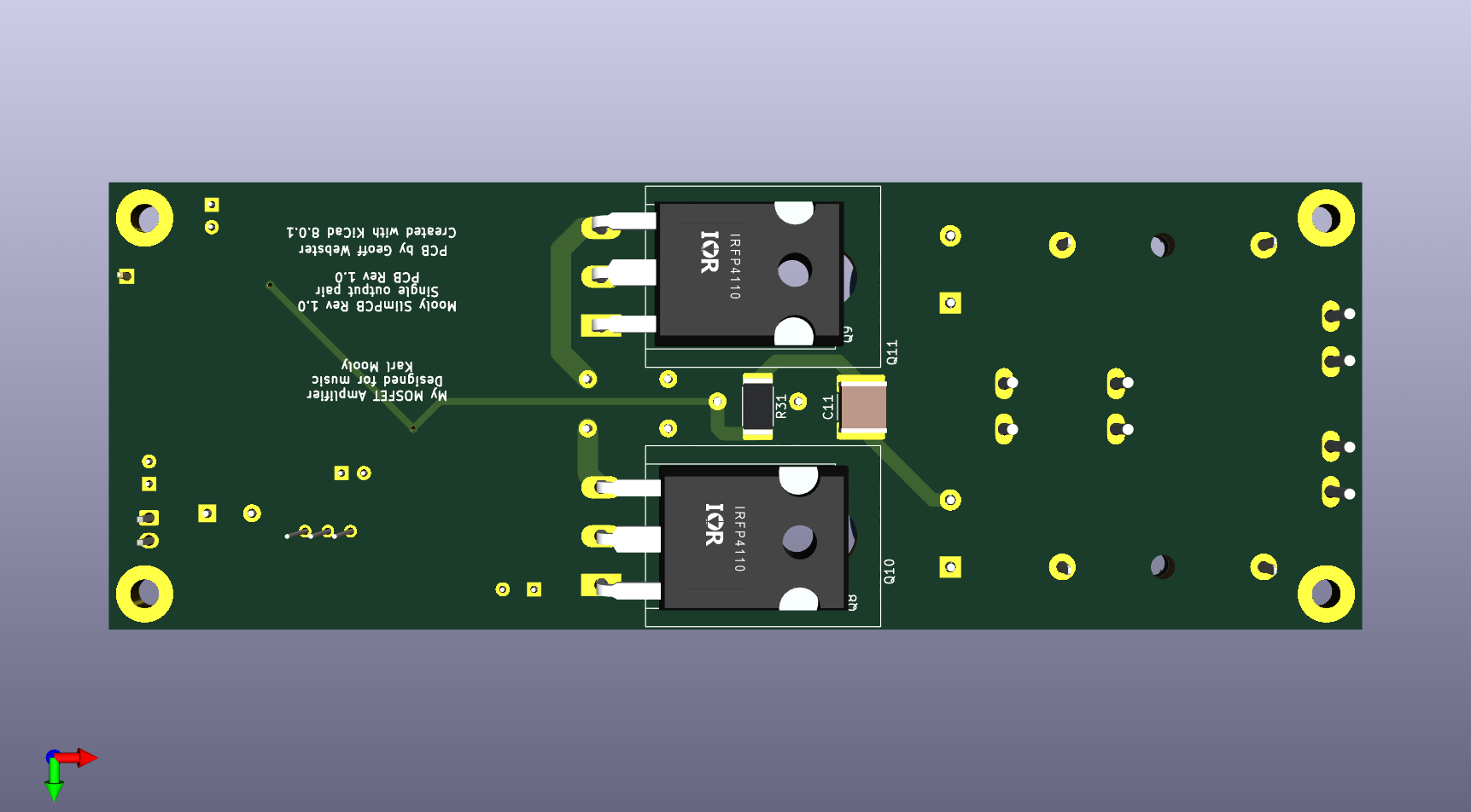

What about the output inductor and output series resistor? Are these to be mounted off-board?
R32 (0.22 ohm) is currently connected to the output connector of this board.
I presume you mean the resistor that goes in parallel with the output inductor. On all the other boards I've seen on this thread, the output inductor and parallel resistor are mounted off-board.
I'll have a look at the size of the inductor/resistor and see about mounting them onboard. Ideally without extending the pcb length any further.

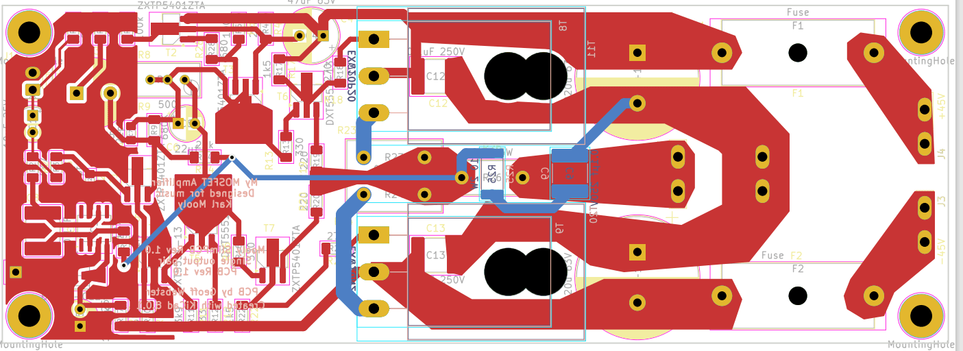

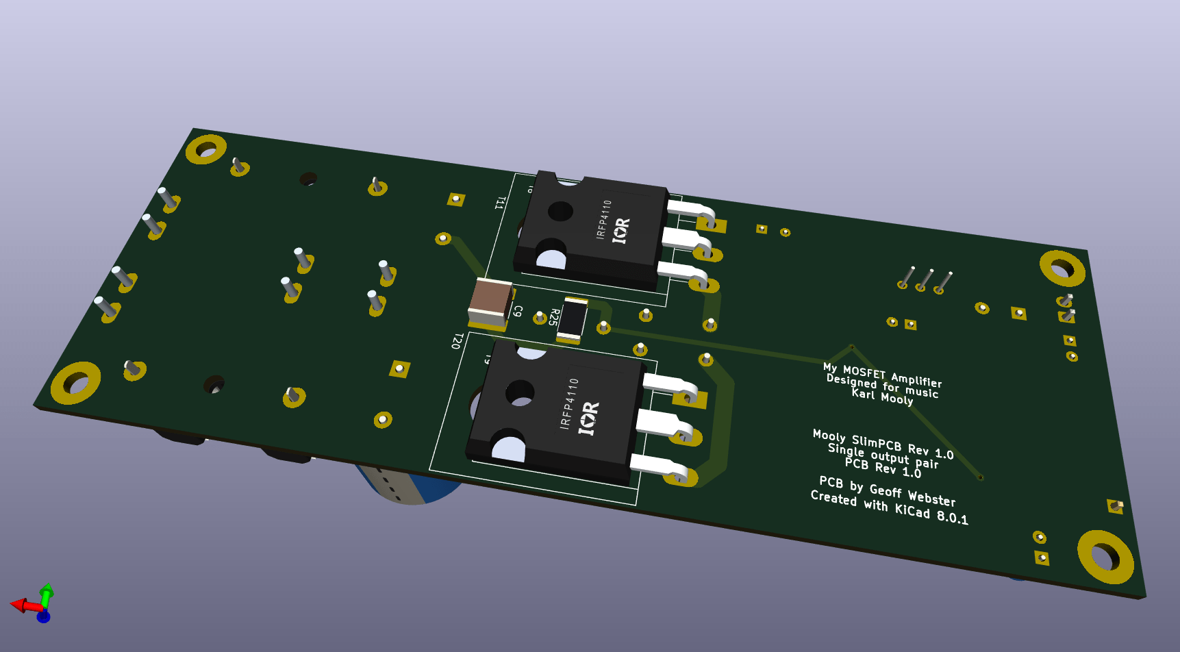

I've reviewed a few things related to the last few responses.
  1. The output inductor/resistor (Thiele network) take up too much room to sensibly integrate into a 50mm width pcb (this width done to accommodate the Modushop Dissipante heatsink bracket dimensions) so I'm sticking with these being mounted off-board between this pcb and the output terminals mounted on the case.
  2. The KiCad8 footprints for the MOSFETS (both single and double die options) have a 3.3mm diameter for the fastener holes. These are fine if mounting directly to the PCBs but need to be larger (7mm dia) when mounting MOSFETS onto the heatsink which is spaced off from the pcb by around 10mm or so (can't remember what Mooly originally stated). The larger holes are now incorporated in the board layout and tracking around their locations adjusted accordingly.
Unless someone comes up with anything else important, this will be the final layout and here's the gerber

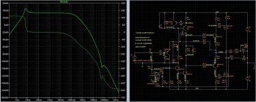

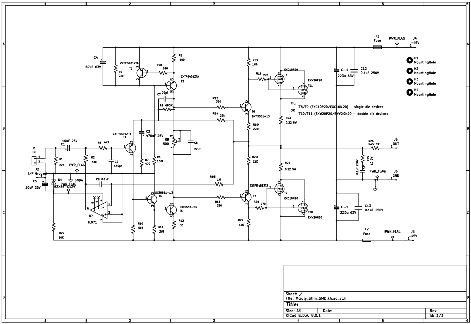

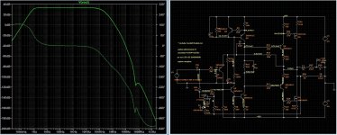

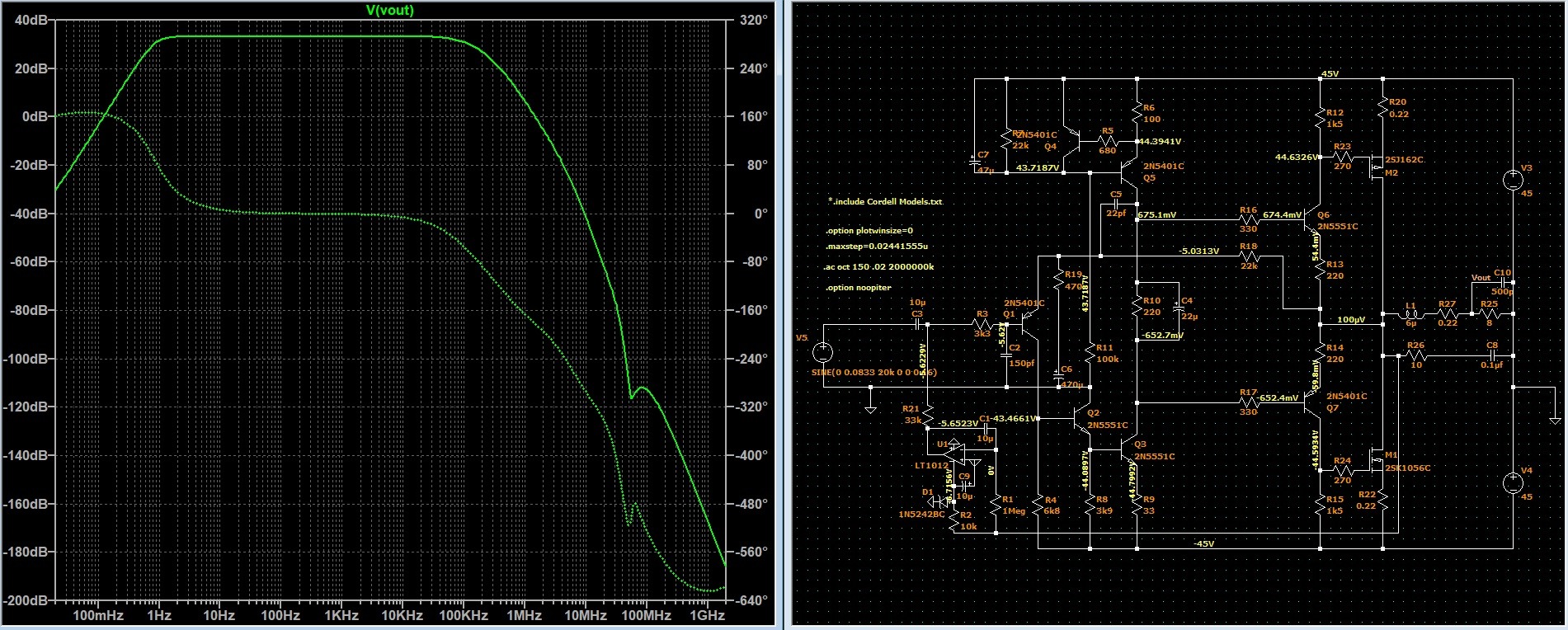

It looks like your component numbering isn't following the original schematic? For example, I see R31 as a SMD resistor on the bottom layer. This doesn't correspond to the schematic from Post #1.
I'd suggest updating the numbering to match the Mooly's Post 1 schematic.
Reactions: 1 users
Joined 2014
Hole diameter is much better now to properly mount board and mosfets 👍🏻
Brian92f makes a good point to eliminate confusion keeping the component designator labeling consistent with Mooly’s, especially if asking for troubleshooting help.

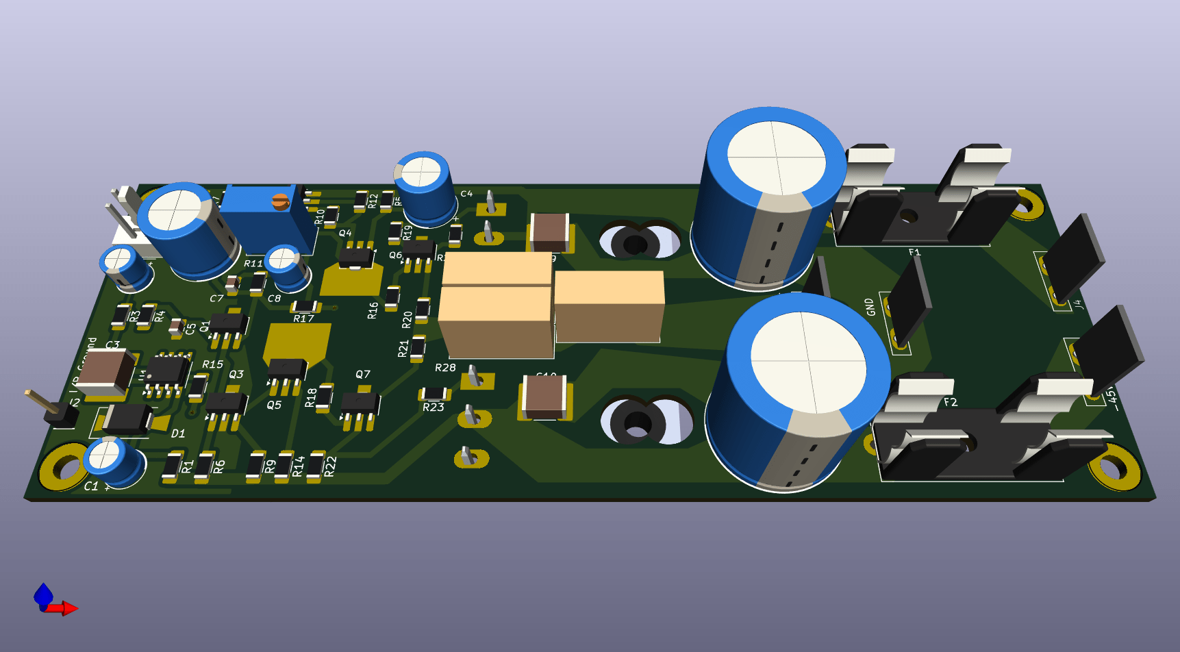

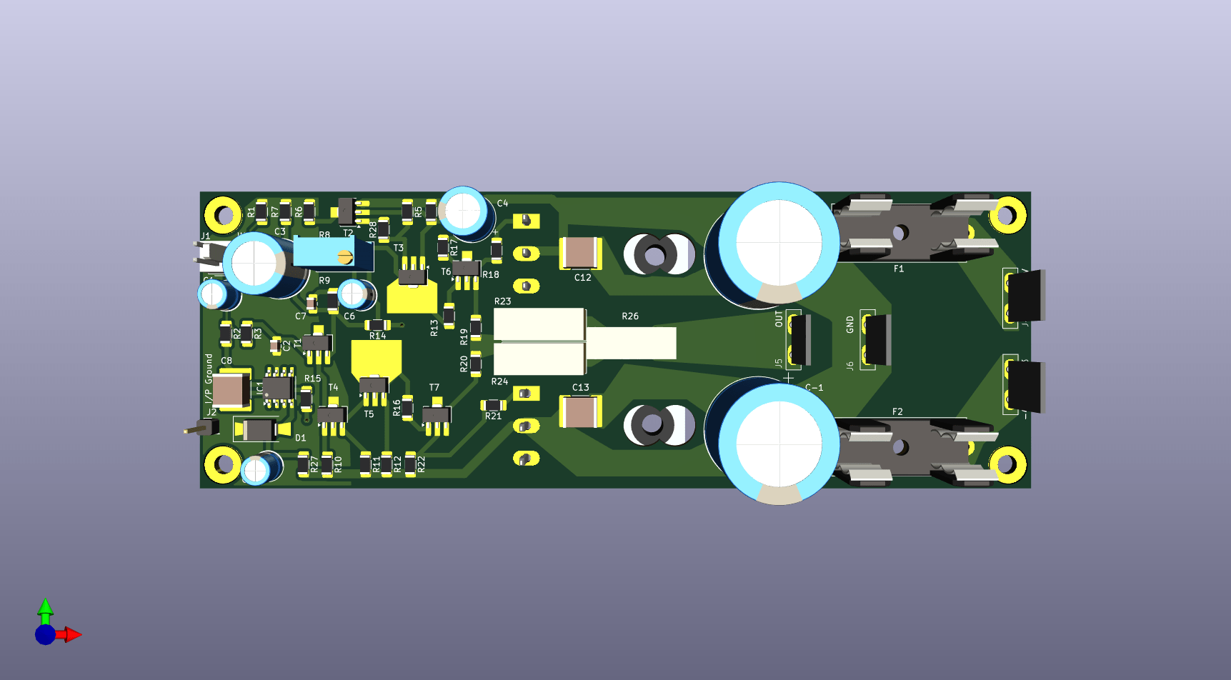

Looks good work to these uneducated eyes.
Could a seperate pcb be made for the inductor, resistor?
Schematic component numbering revised to match originals so we now have consistency with Mooly's original. Here we go!

Reasonable question.
If the amplifier were to be run continuously at high power levels, it could be an issue but for domestic use isn't a problem.
The quiescent state with output bias set to give 100mA through the MOSFETs will dissipate about 4W in each MOSFET. and won't be much more at domestic (even a noisy party) levels.
A few posts back I uploaded the schematic and renderings for the revised layout with component numbering matching Mooly's original. I forgot to upload the Gerbers to go with it. Here they are if anyone cares to use them. I've just ordered a min quantity of 5 from JLCPCB so, once I extract 2 for myself, will have a couple spare and am happy to pass them on for cost of postage (within UK) if anyone is interested.
