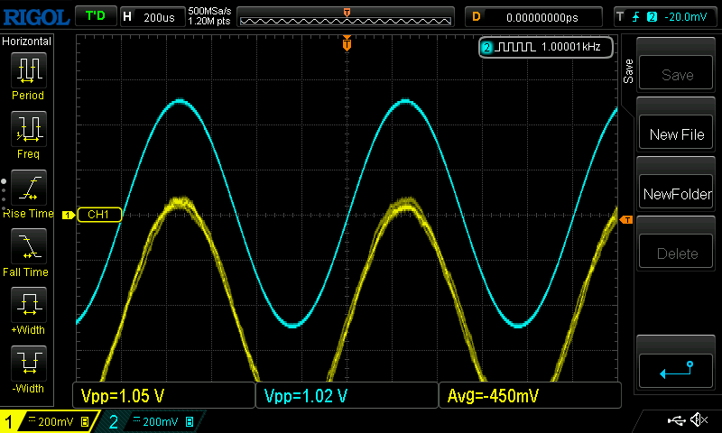

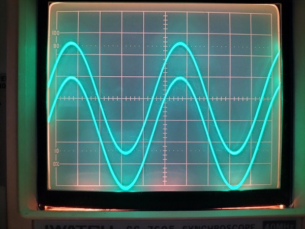

I repeated measurements a few times, using sets of resistors:
1). 10 Ohm - 10 kOhm, 2). 100 Ohm - 100 kOhm, 3). 1 kOhm - 1 MOhm 4). 10 kOhm - 10 MOhm
Set 1 produces no visual deviation at all.
Sets 2-4 shows almost the same:

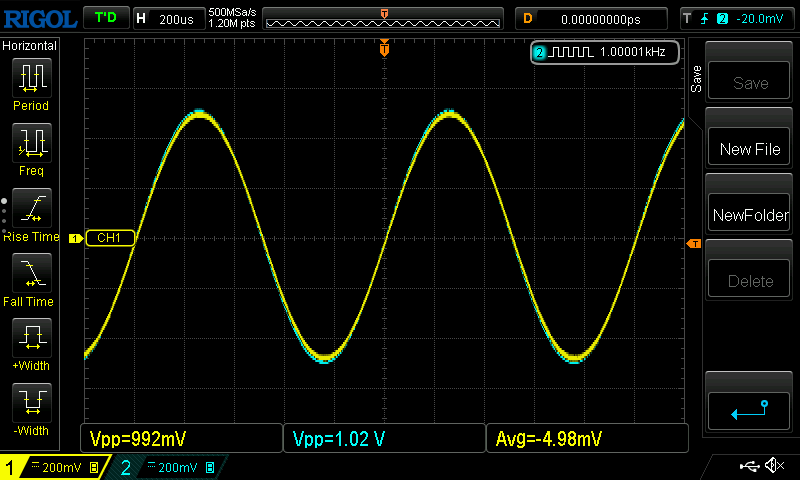

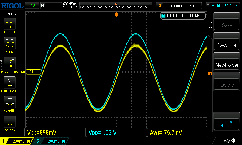

Disregard offset issue with +-3V power, see abnormality with +-6V. Blue line - Input 1Vp-p, yellow - output.
AX tech editor
Joined 2002
Note that with Sallen & Key and other feedback based filters, the internal circuit node voltages can be much higher thanthe input and output levels. Often a source of distortion, especially with limited supply voltages.
BTW in your scope pics I don't see any distortion, only level differences.
In the first pic it is the scope that clips, you should move the yellow wave up on the screen.
Jan

I don't see any reason, why circuit node voltage in Sallen-Key filter would be any different for opa1652 /opa1688 and for opa1656. Especially with 33nF cap.
Same apply to THD measurements circuits, look again, distorted positive half-wave Only. Any other OPA in this circuits would stay as in picture 9V in the specified by DS voltage range. Gain must be exactly +1.

I didn't say it is different with different opamps.
Again, I see no distortion in any of your graphs. Which one are you referring to? The first one? That's just a bad scope setting.
Edit: I looked at the first link in your 1st post. All I see is a bunch of scope pictures all almost the same as the generator distortion. That means that the opamp basically has much, much less distortion, which cannot be deduced from these pics.
I think you are chasing a ghost.
Jan
Reactions: 1 users

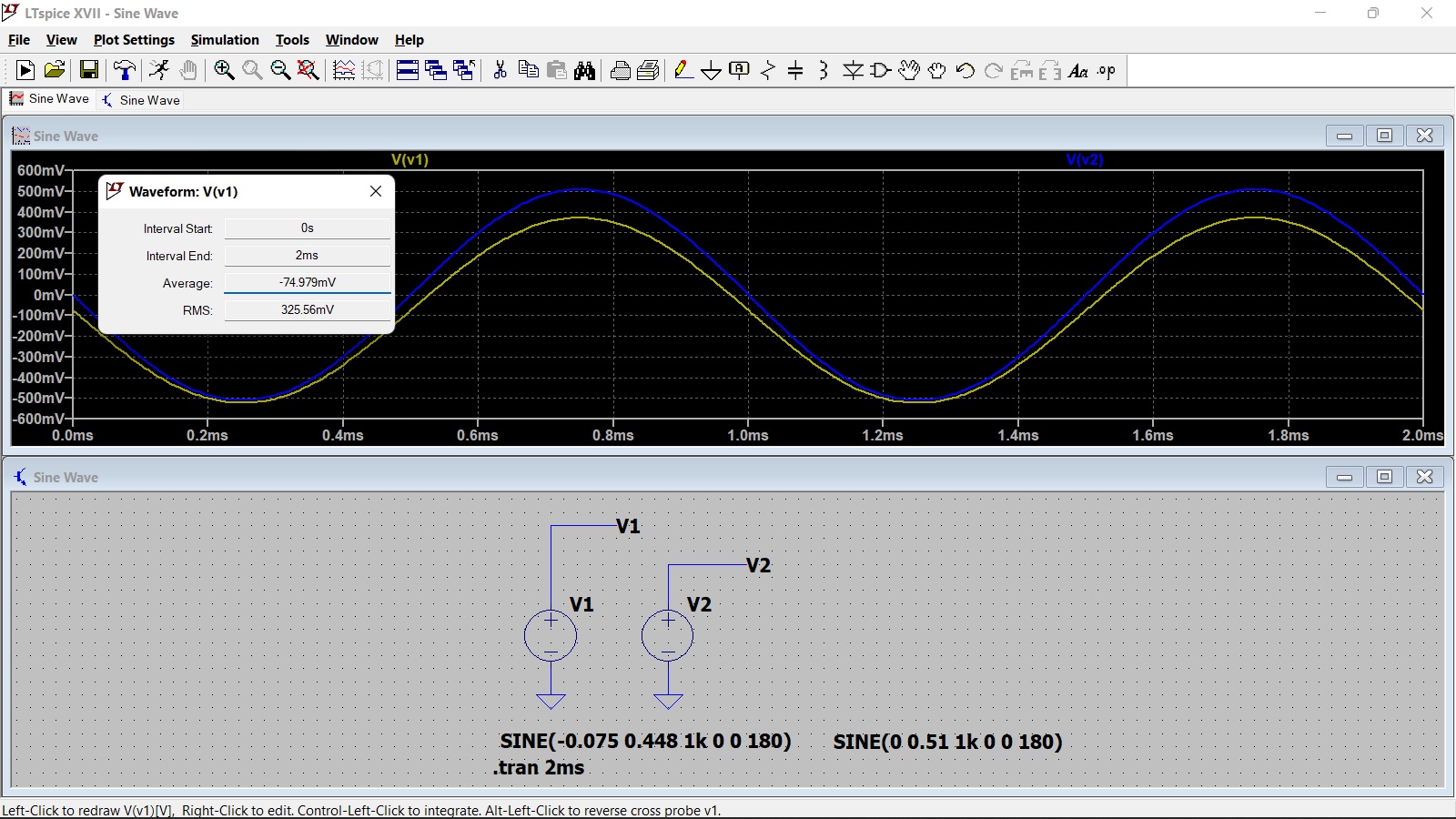

@MagicianT , have you measured the DC offset??
You know how sine wave with offset differs from sine wave with gain not correct? Settings on the oscilloscope were not changed in between 3 pictures.

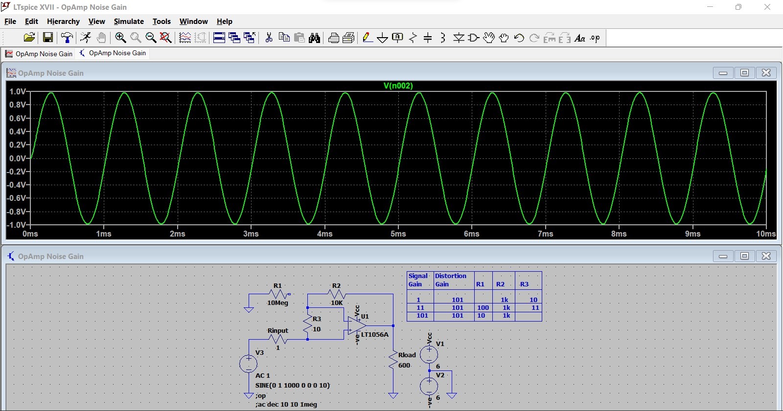

I see a lot of confusion. Sallen-Key circuits is much more complex to analyze , my initial attempts to insert 2.4k into negative feedback that I mention in another thread is the first things that come to my mind. There are too many parameters involved, PS Voltage, R & C on both inputs, etc.
This is why I bring another circuits right from OPA1611 data sheet (and many many others)
First line in the table G=+1 , with resistors 1k & 1M would means distortion gain 1001, but input signal G stays +1.
I used this circuit always, 100-200 OPA different makers & types were evaluated for many years . My new SA based on MAX11270 could measure -130dB THD with 2 frame per seconds - real time. This is first ocasion I see an issue, so big in scale. It's visible on a scope!

Can you tell me in which scope pic you see this distortion?
Or maybe show this pic?
Jan
Picture in the middle, 1k6V - move a mouse over it shows a bubble with a name.
No, it's not a DC offset, this is DC offset + Gain Error - huge error, about 10% off. Peak-to Peak value yellow & blue channels must be the same, if not - linearity & distortion problems. It could be shifted up and down depends on DC offset, but newer magnitude variation.
It looks like DC offset to me.
It is a DC offset. However it seems there is no use to debate with someone who is unwilling to learn and who even does not know how the harmonic distortion of the sine wave looks like. BTW, he has a scope and the scope definitely has an FFT measurement. No problem to measure harmonic distortion, then, if there is any.

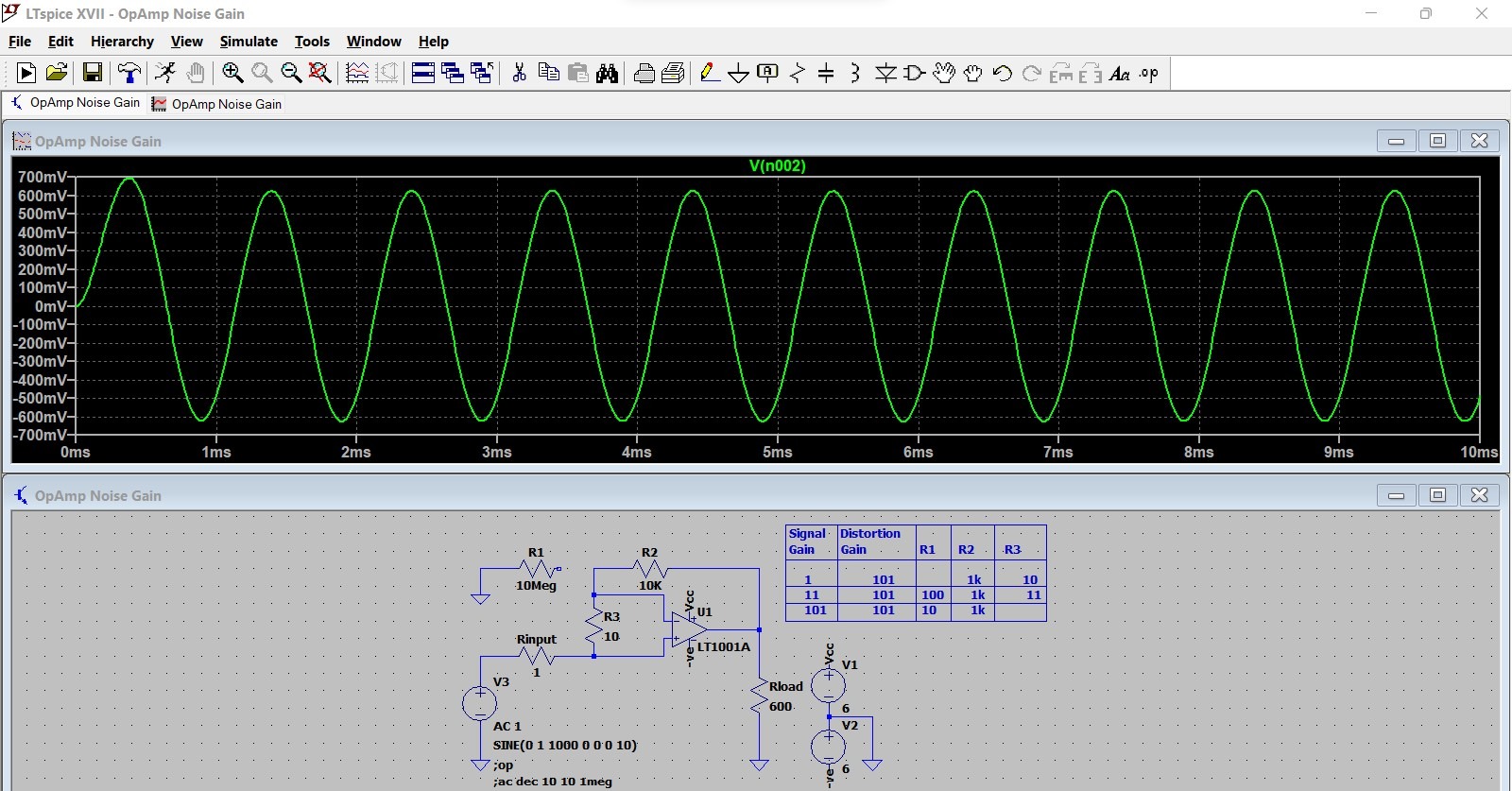

You use the opamp in a 1000x gain config, so you can expect less than 1000x actual gain. You show input/output curves overlaid, so how did you get the output divided down to the input? Scope attenuator? Trying to get these small differences measured with an 8-bit cheap scope is, well, ambitious.
The same with trying to interprete tiny waveform differences between scope channels as 'distortion' of the opamp.
That opamp runs rings around that scope, even at 60dB.
From earlier postings, I expect you to be too stubborn to think seriously about it, but you're wasting your time this way and learn nothing.
A single stage gain of 1000 using resistors of megaohms is not what opamps are designed for. Limit each stage to 10 to 20x gain max if possible, use feedback resistors of lower value, a few 100k is about the max typically seen for solid-state audio circuitry. Many audio opamps have GBW of 10 to 20MHz or so, so at a gain of 1000 the bandwidth will have dropped to 10--20kHz - completely inadequate for audio.
Also audio opamps may have enough input offset voltage to saturate the output for such high gains - if the input offset is +/-3mV and the gain is 1000, the output offset is +/-3V, or maybe much worse if a bipolar opamp with extra offset due to bias resistors.
Often the headline distortion figures in datasheets are for gains of +/-1 only.
Distortions less than 5% or so can be hard/impossible to see on a 'scope screen, the eye doesn't act as a spectrum analyzer.

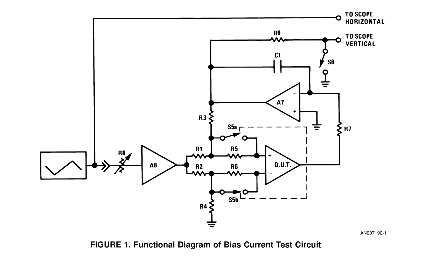

Think I'd continue old thread, instead of starting new one. I build another hobby project, modified version of
"National Semiconductor
Application Note 24
M. Yamatake
April 1986"
A Simplified Test Set for
Op Amp Characterization.

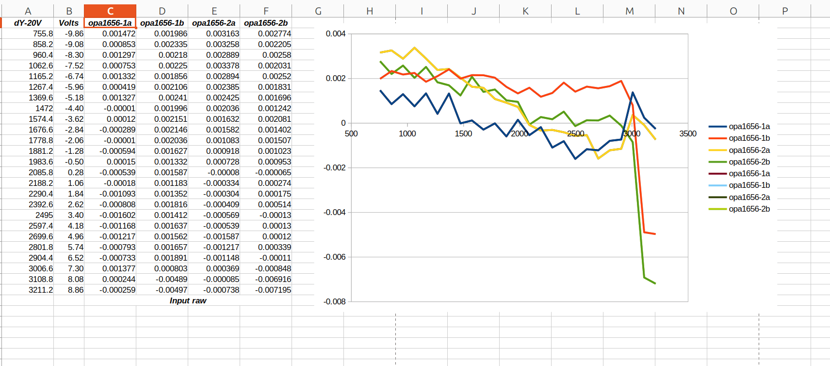

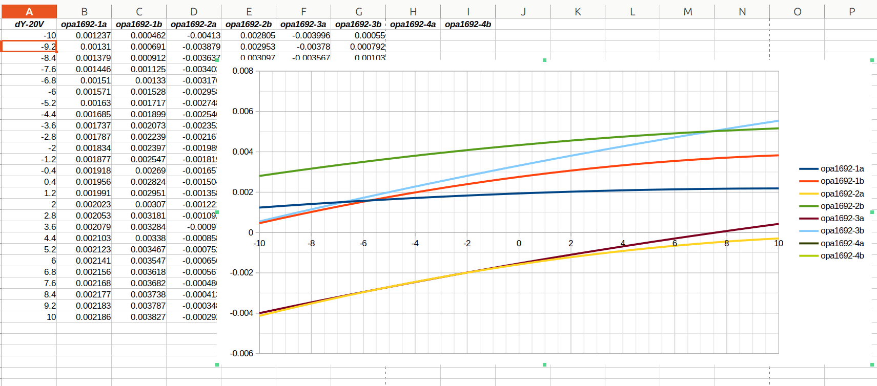

In essence, idea is similar to shown in original post circuits, drive input CM of the OPA and using gain of the DUT itself measure RTI offset.
Read app note for details. My "upgrade" consists of removing integrator - replace to DAC (kind of software integrator) and track data by internal nucleo-G474 adc -> streaming to PC.
I 'd show two IC, opa1692 (good one) and opa1656. As you can see, opa1656 exibits sharp change in RTI offset about 6-7V (powered +-12.5V).
Data for opa1692 "noise removed" version.
Testing 20-30 OPA's I have in stock, different types and makers, didn't find any that have this gluk. Some have real problem with linearity, where changes in offset may reach 100's uVolt, I can post more results if interesting.
Strange that all aplication examples of opa1656 in DS have gain G >= 2.

Input Common voltage test, simply:
1. apply power voltage to IC;
2. use circuits from initial message of this thread;
3. SLOWLY drive input from SG, or using potentiometer from V- to V+ ;
4. connect Voltmeter in between input and output of the OPA , that capable to register ~100 uV (having gain 1000 and jump in offset 2-6 uV expected abrupt voltmeter indication about 2-6 mV)
5. observe abnormality around 1/2 V+, in my case +6-7 vol'ts when powered +-12.5V
