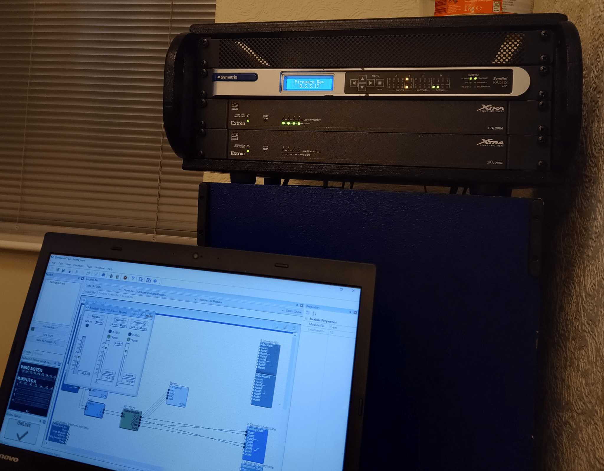

LA8 looks to be a Lab gruppen dressed up as a L'acoustics with a homebrew DSP. That Dante is starting to become available on china amps is very exciting running everything over network would be cool, our DSPs (symetrix radius AEC) have Dante already. This must mean there is a cheap Dante module available. If you look on ebay there are plenty of ex-install extron amps but I don't know about newer models, I guess look up your local distributor. They also do an 8 output model with Dante input.
Attachment is my Extron rack (DSP is only temp I use 8x8 and DIGIO in this rack normally). Not bad for 8*200W.

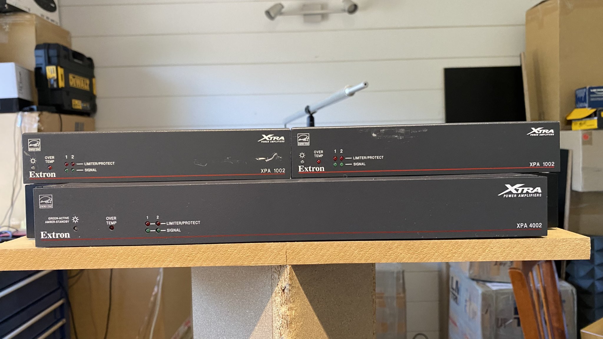

I have a pair of 1002 and a 4002.
No hum, no buzz, no ticking.
No fans.
Just deadly...:cool:
A minor bugbear is having manually wire the Phoenix type connectors.
A kind @kipman725 help pushed me in the right direction…
