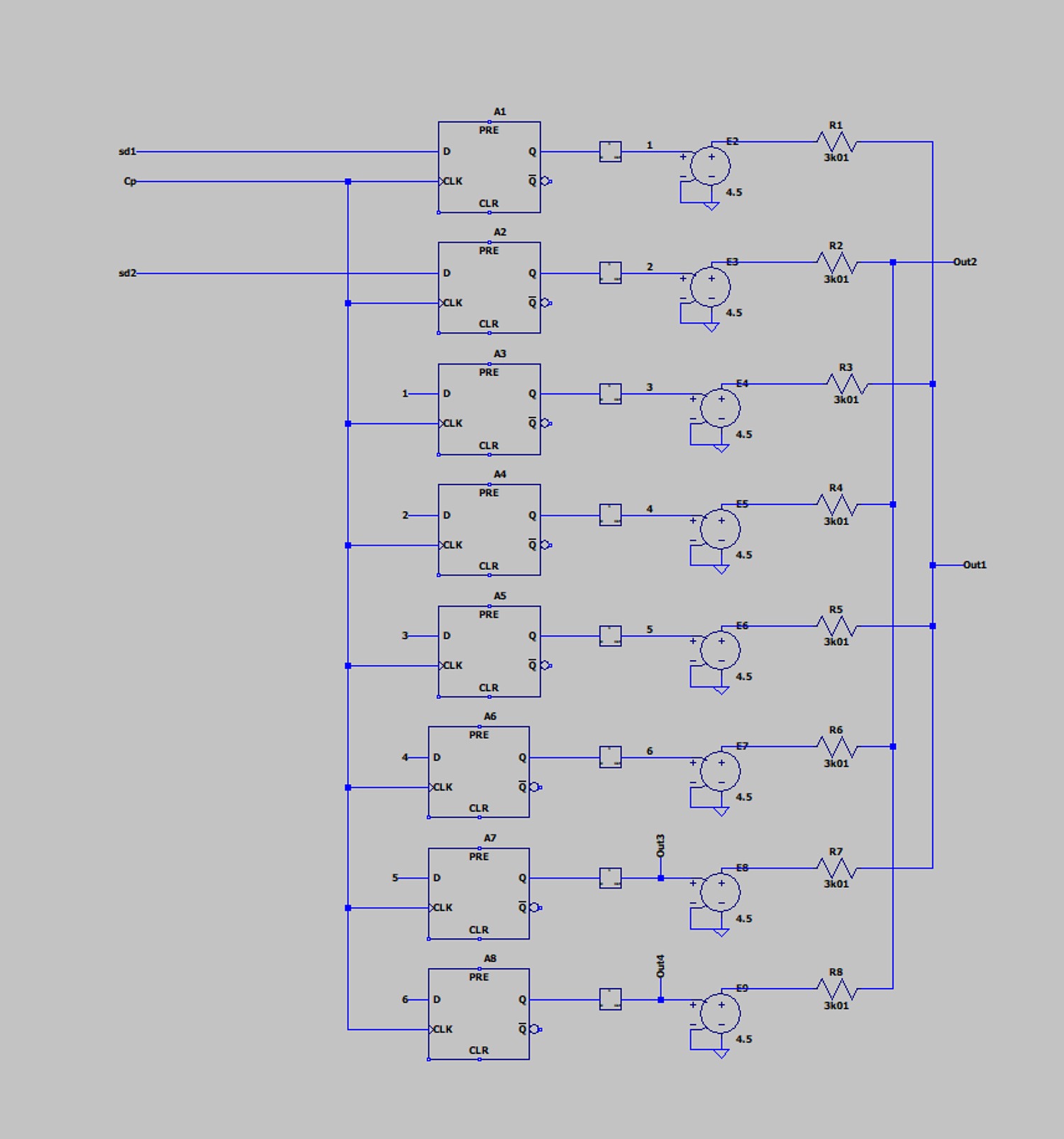

Point is that LTSpice works with 1Volt logic, where the real Firdac circuitry uses 5Volt, giving a level difference of 14dB.
But all shiftregister outputs, which are supplied with 4,5Volt, are multiplied with a VDVS with a gain of 4.5 to get the right voltages at the summation point of the 8 resistors.
So to get the absolute suppression value before and after, add 14dB and you will get the 55dB that you mentioned.
Rise and fall time are determined by the little squares in the sim with an equal 5nsec for both.
This added delay is needed because digital logic in LTSpice has no delay.
See first attachment with the building block for this part.

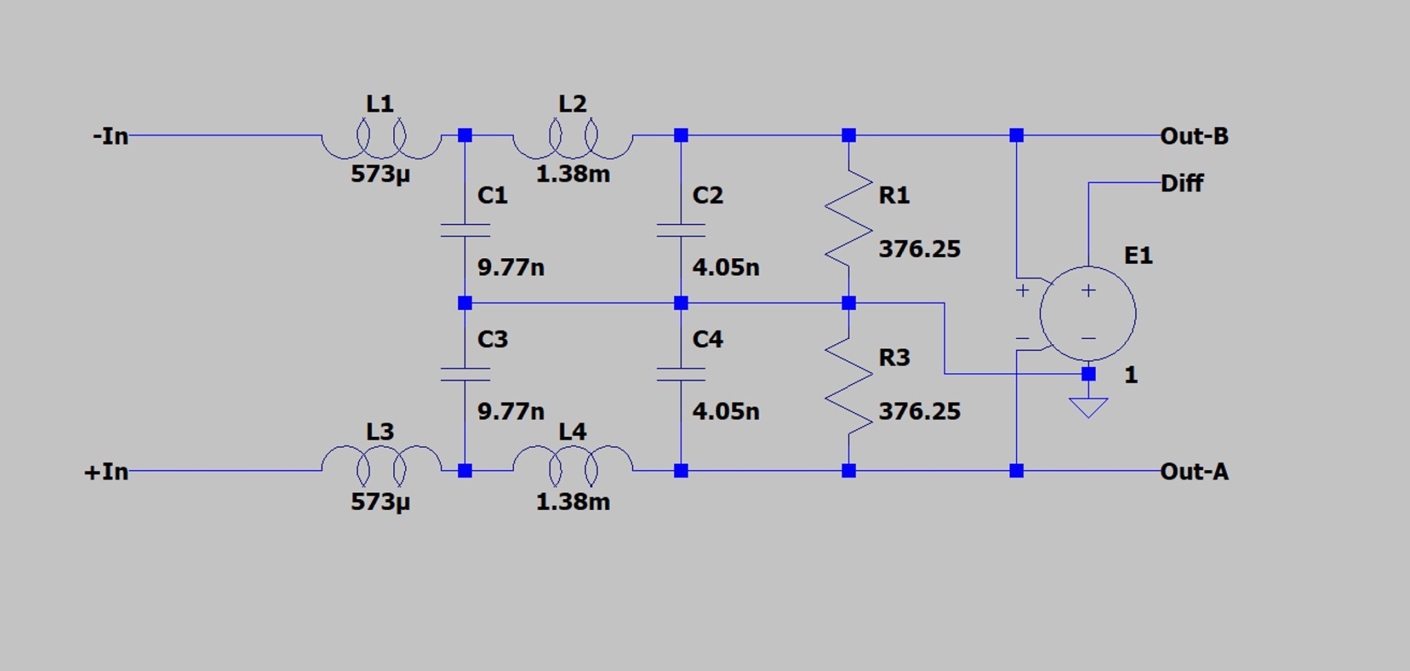

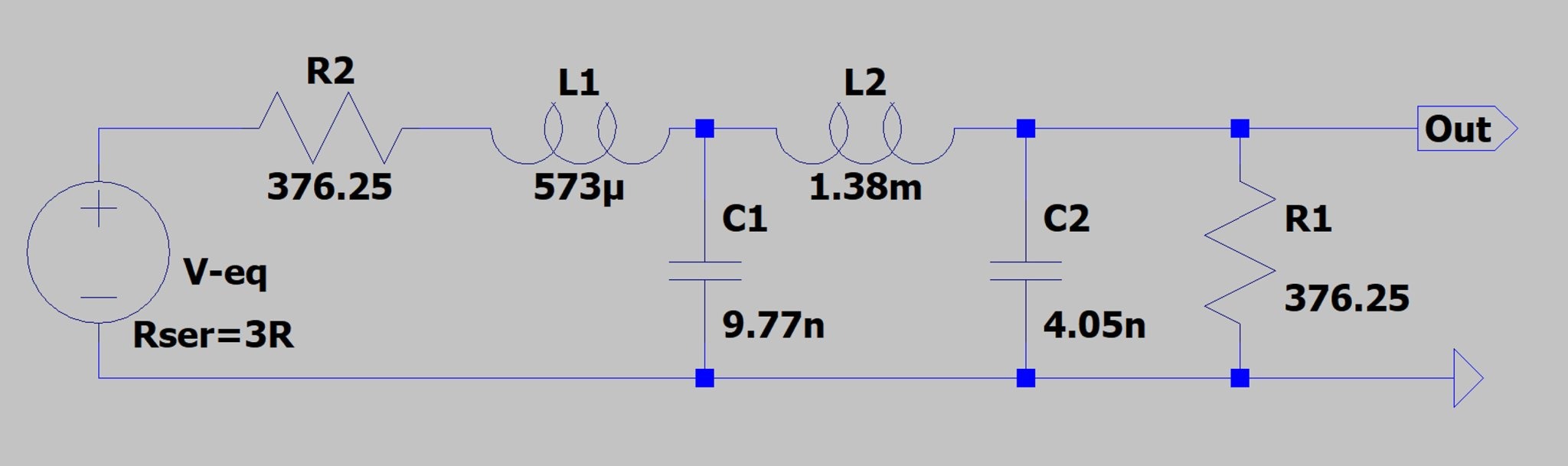

3) The summing point was loaded by a passive 4th order Butt. filter, see second attachment.

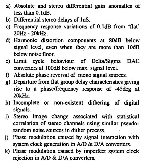

The latest PCM2DSD FW which "ignited" Markw4's question was aimed at improving issues found together with Marcel's RTZ dac. My understanding is that the latest modifications made to PCM2DSD FW are not altogether applicable to other DACs. But I don't see any problem with that. E.g. the developer of HQPlayer recommends specific type of modulators for ESS DACs and another type for AKM DACs.
Listened with an RTZ dac.
Also since my initial impression, I was able to get a 2nd opinion from another listener.
He and I agree on a few points:
1. Time domain dynamics of individual instruments and voices have been lost (in midi terminology we might say the ASDR envelope information has been diminished or lost; dynamics over time are flat).
2. L/R spatial positioning of voices/instruments between the speakers has been lost.
3. It sounds "bad." (maybe like lossy encoded)

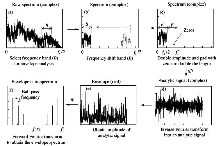

Regarding the first point, this seems like in principle it should be measurable as a change in the Analytic Function (Hilbert Transform).
Regarding the second point, as I suggested in the other thread (Simple DSD Converter...) its probably measurable in terms of inter-channel phase coherence and or ITD timing accuracy.
The above observations may be consistent with some of the list of unexpected audible effects described in Paul Frindle's AES paper on a professional digital mixing console:
Perhaps items (i), (b), and or (g) seem possibly related to what may have happened here?

EDIT 2: Some related information attached.
  • Envelope calculation from the Hilbert transform.pdf

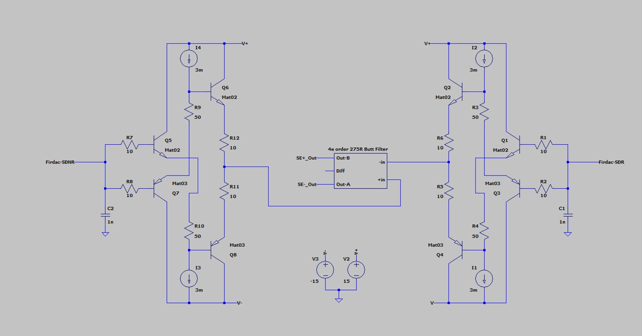

Marcel,
The cosmetic flaw that allows intermodulation products slip into the audio band with certain DSD converters producing larger peaks around fs/ than others, are seemingly to be blamed to non ideal behaviour of the output filter, but Bohrok showed with his AK4493 D/A that those flaws can be fully suppressed with the right filter.
That made me make up my mind by attempting to design a more effective filter
The digital part of the RTZ FirDac however can be regarded as “almost blameless”

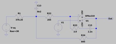

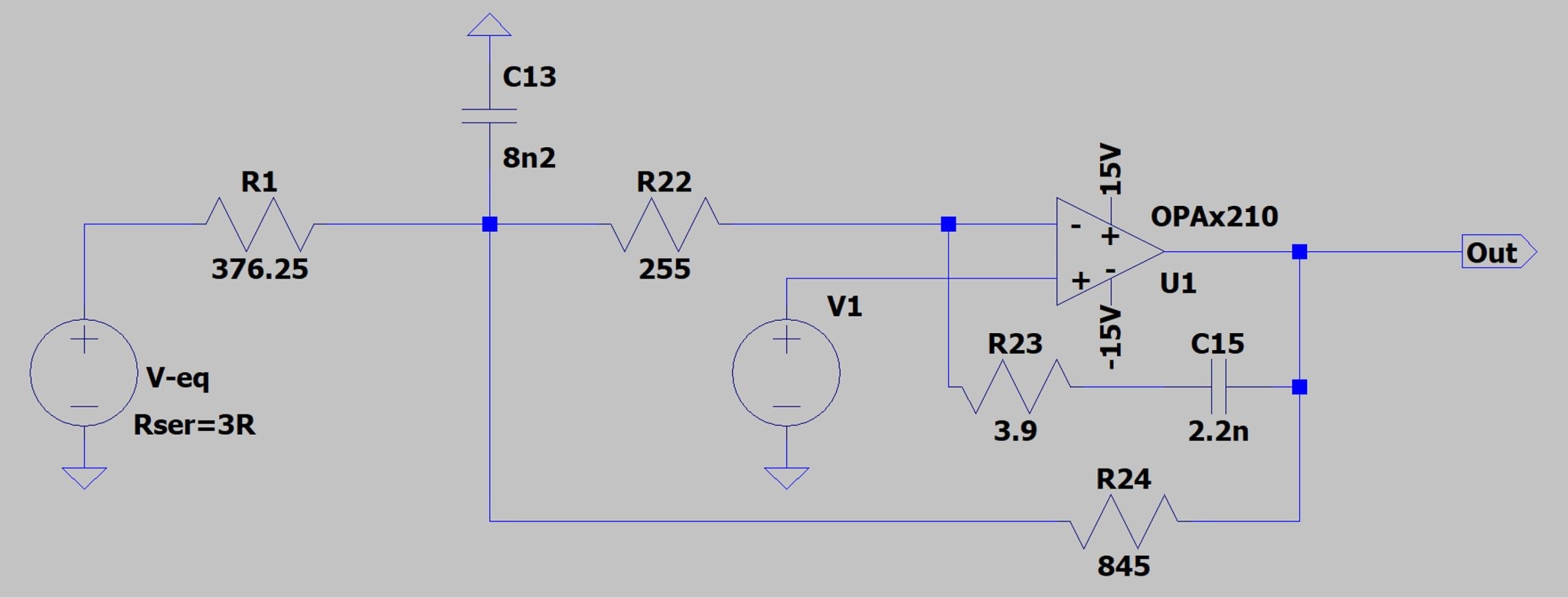

The Firdac’s register outputs are summed by eight 3k01 resistors. In a replacement diagram this can be seen as a voltage source driving a 376.25R resistor. This voltage source has an additional output resistance of ca. 4R.
You are talking about 8.2nF suppression, but when looking at the replacement diagram in the first attachment, you see a 2nd order MFB filter where the 8.2nF just is part of it, so because it is included in a feedback system, you can’t look at in isolation.
This first plus second MFB filter may not be any better as a passive 4th order filter tuned for 376.25R + 4R not having such 8.2nF cap, see the second attachment.
But in practice it can make a difference because Op-amp seem to have difficulties with the level of peaks around fs/2 and maybe even with large peaks at multiples of fs/2, resulting in unwanted aliases.
A passive filter may also have its flaws because of components behavior deviating as from certain frequencies from their nominal value.

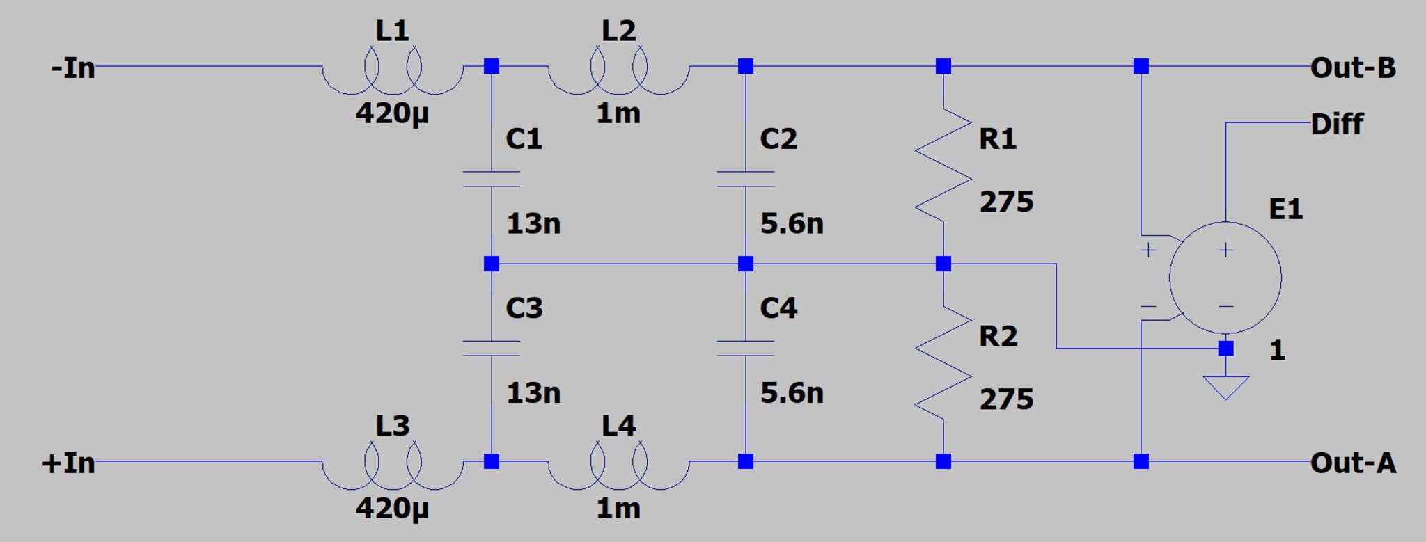

But in general, the lower their nominal value, the higher the frequency where they start to deviate. This lead me to the following proposal for an alternative filter that’s more resistant to those HF peaks around fs/2.
1) First start with a smaller cap of 1nF directly connected to the Firdac’s summing point, creating a pole at ca. 400kHz as a first line of defense to said spectral peaks around fs/2 and multiples.
2) Then followed by a discrete diamond buffer working in class A, with high BW and extremely low distortion. This buffer should drive a 4th order passive filter. In this buffer the low noise high BW Mat02 and Mat03 transistors were used, now replaced by the SSM2212 and SSM2220, but there are other alternatives to be found..
3) The passive 4th order filter is designed for a 275R impedance, where component values are still relatively easy to get or created from combining components in series or parallel and where the relatively filter low load results in a very low distortion for the buffer.
Here R1 and R2 are shown as the termination resistors, bur when using an amplifier behind the filter, these resistors will be replaced by the amps input resistors.

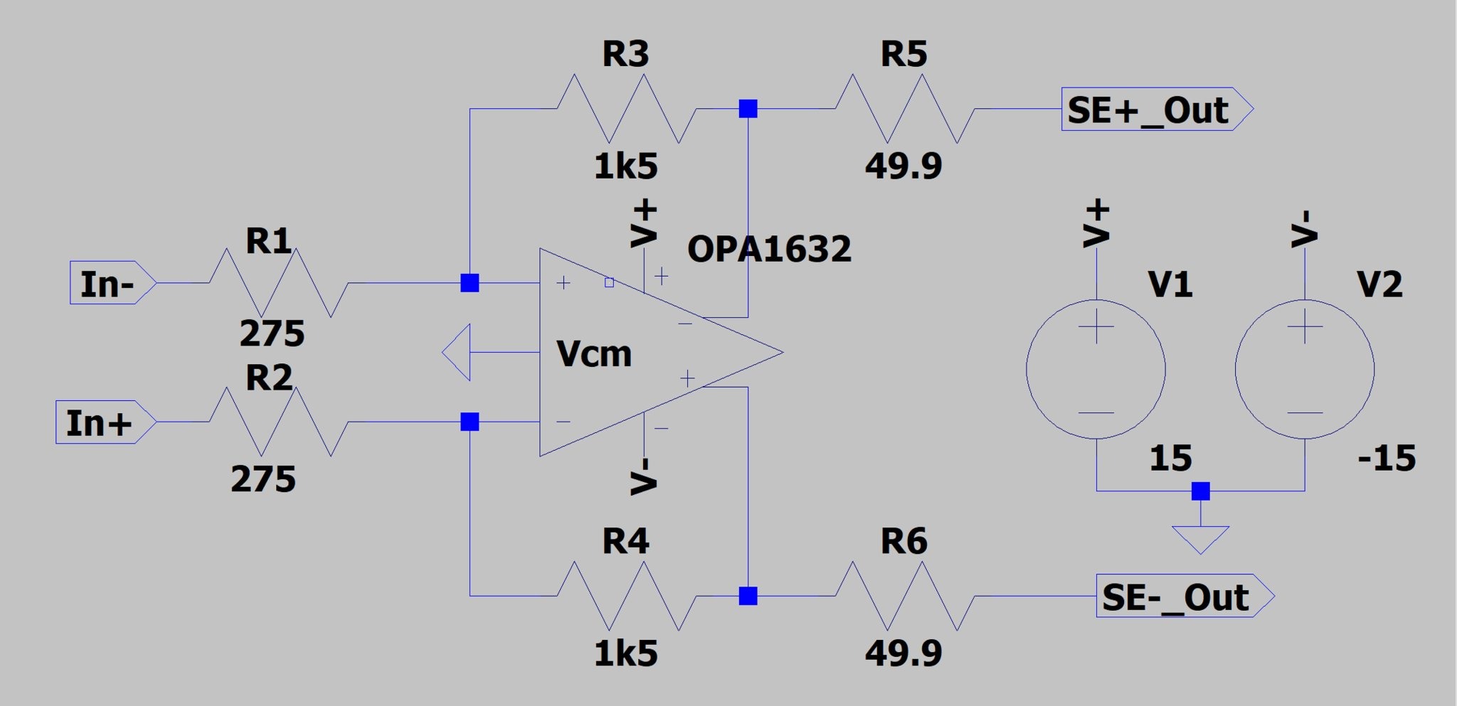

4) Finally an active differential op-amp to bring the output level at the usual 2Vrms for a 0dB audio signal and the DC level at zero Volt. This can be done with a OPA1632, where at this point al peaks have been removed from the signal.

Output from the buffer plus filter still has to be amplified by a factor 5.3 to get the usual 2Vrms for a Dac at the differential output.

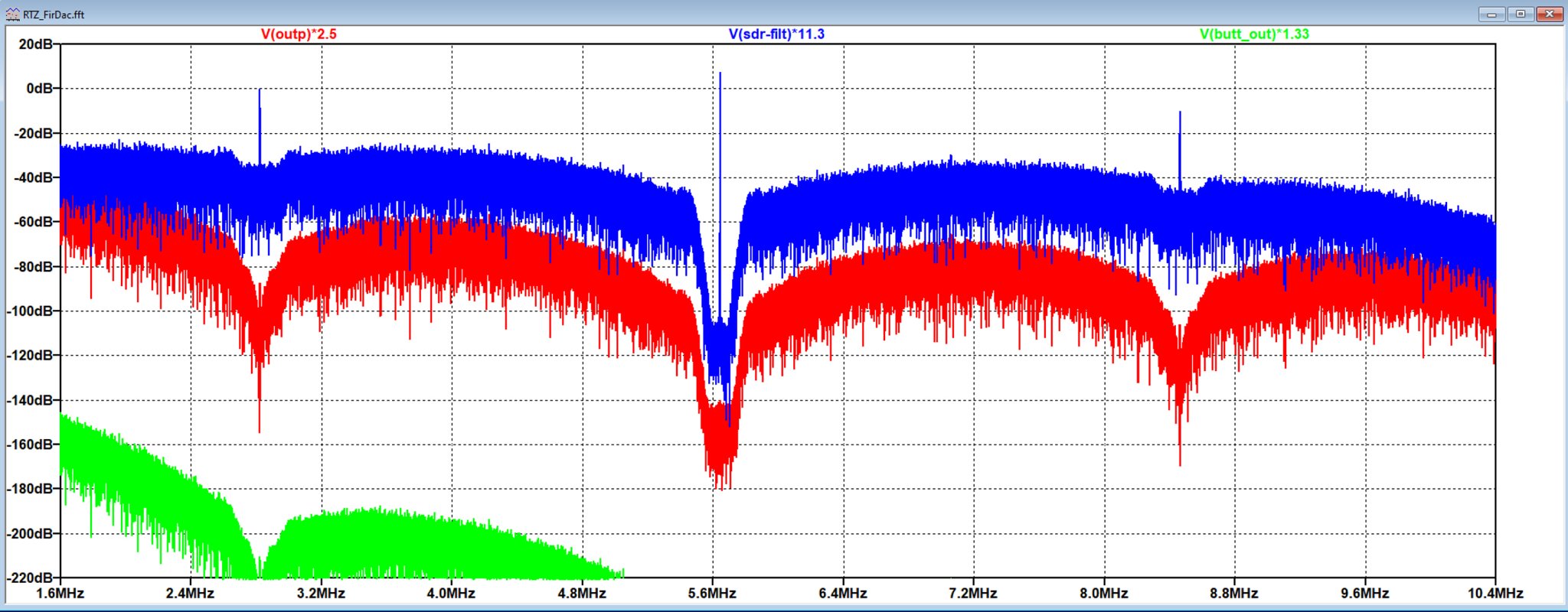

A first glimpse shows already a preview of part of the spectrum where the peaks are.
Blue is input signal to the Firdac's shiftregisters, Red is on the summing point with the 1nF cap and buffer connected and Green is at the output of the 4th order filter.
All levels are carefully adjusted and matched, giving absolute references levels, as will be shown in the next posting.
