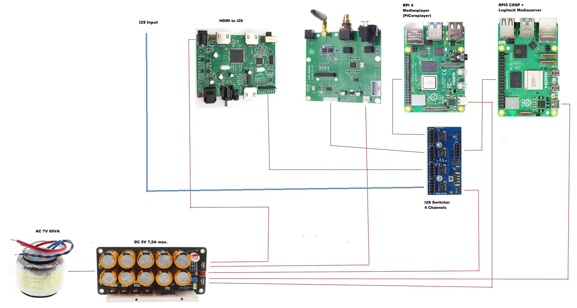

Hello I am new with CamillaDSP and use it now for a week or so and it works already great but one thing i need for the whole Projekt i build up,
Is to detect the Input Samplerate on an RPI'S 5 I2S Input (Multichannel) I got already an HDMI (1.4) to I2S Board running but for now i need to switch the Incomming samplerates Manualy on CDSP. And this isn't realy funn to do.
Look at the Attached Picture. That is my Plan to build up an nice complete DSP Solution (waiting for the Boards i ordered already) for an 7.2 full aktiv Surround Setup with CamillaDSP as the Heart of all.
Outputdevice for now is an MOTU UL mk5 but i need at all 16 Channels with Volumecontroll on all Channels, so i need to switch it any day to may be an MOTU Ao 24 or A16.
At minimum all Channels on Motu need to run at 96kHz
For the Capturdevice i use this:
hw:CARD=GenericStereoAu,DEV=0 (I2S Input on RPI5)
Would be the camilladsp-saterate the right tool to switch automaticly to any incomming samplefrequenz on I2S ???
Than i would give it an try.
Other Option would be to use an SRC Like that Chip "AK4128A 8 Channel Asyncronous SRC" but i cant find an DIY Board with it or an aviable Evaluationboard with this Chip
Damm this is EOL, now Ti has only an 4 CHannel SRC4194 and EVAL Board with one of them cost 300€ :(
Dont think that anyone will have an DIY Board with 2 of them for 8 Channels.(Digi-key Price is 19,17€)... ;)
I use UBUNTU 23.1 on the RPI5 for camilladsp with Squezzeliteserver on it and on my second RPI 4 is the Picoreplayer, with for now, HDMI Out to HDMI IN Board to I2S on RPI5 later i will use also I2S Out instead of HDMI Out on RPI4 with Picoreplayer.
I am not an Linux Expert so any advice will help me ;)
Robert
