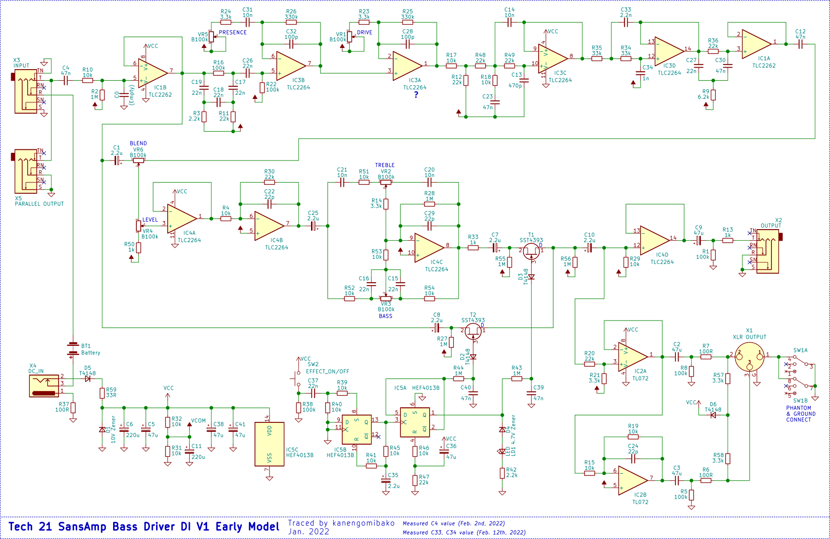

Maybe somebody finds the Factory schematic, but for starters here you have a reverse engineered clone, might help for tracing your issue.
Most probably part designations will not match, but actual schematic/parts will or be very close.
Would not be surprised about typos on redrawn schematic.
Way more complex than I expected, but doable.
I would inject signal, say 100mV 1kHz and follow it end to end, to check where it disappears or becomes garbled/noisy.
Also check for DC at all Op Amp pins; I´d expect about +9V on all 4 pins on quad Op Amps, pin 8 of duals, 0V on pins 11 and 4 respectively, and about 4.5V on all other pins.

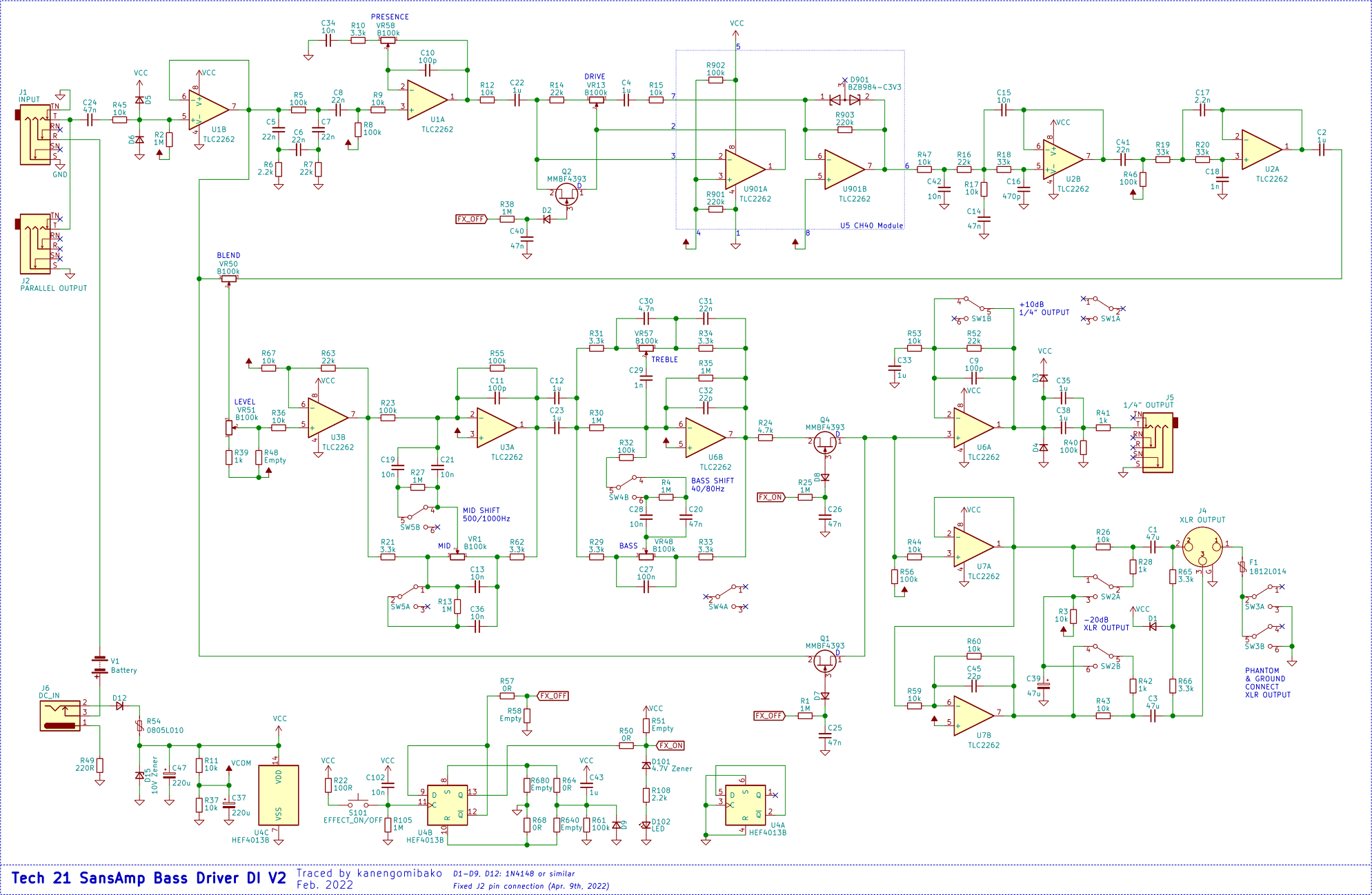

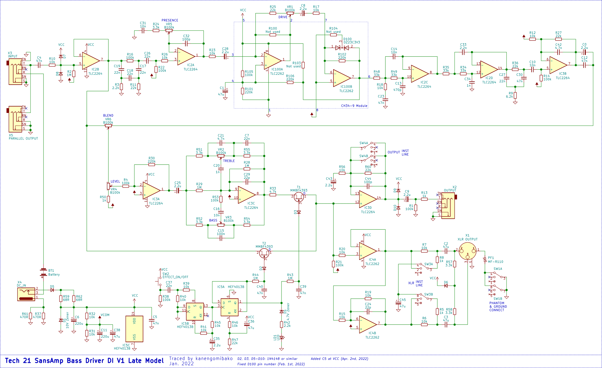

Google finds more traced schematics. Link seems dubious so schematics attached so no one else needs to click it :D Schems found here https://drugscore.blog.fc2.com/blog-entry-286.html
While can't help whats the problem with your devices my intermittent problems on all kinds of devices have been cold solder joints and bad jack sockets mostly. Then there has been problems with pots and switches, but that is usually obvious when using the device.
