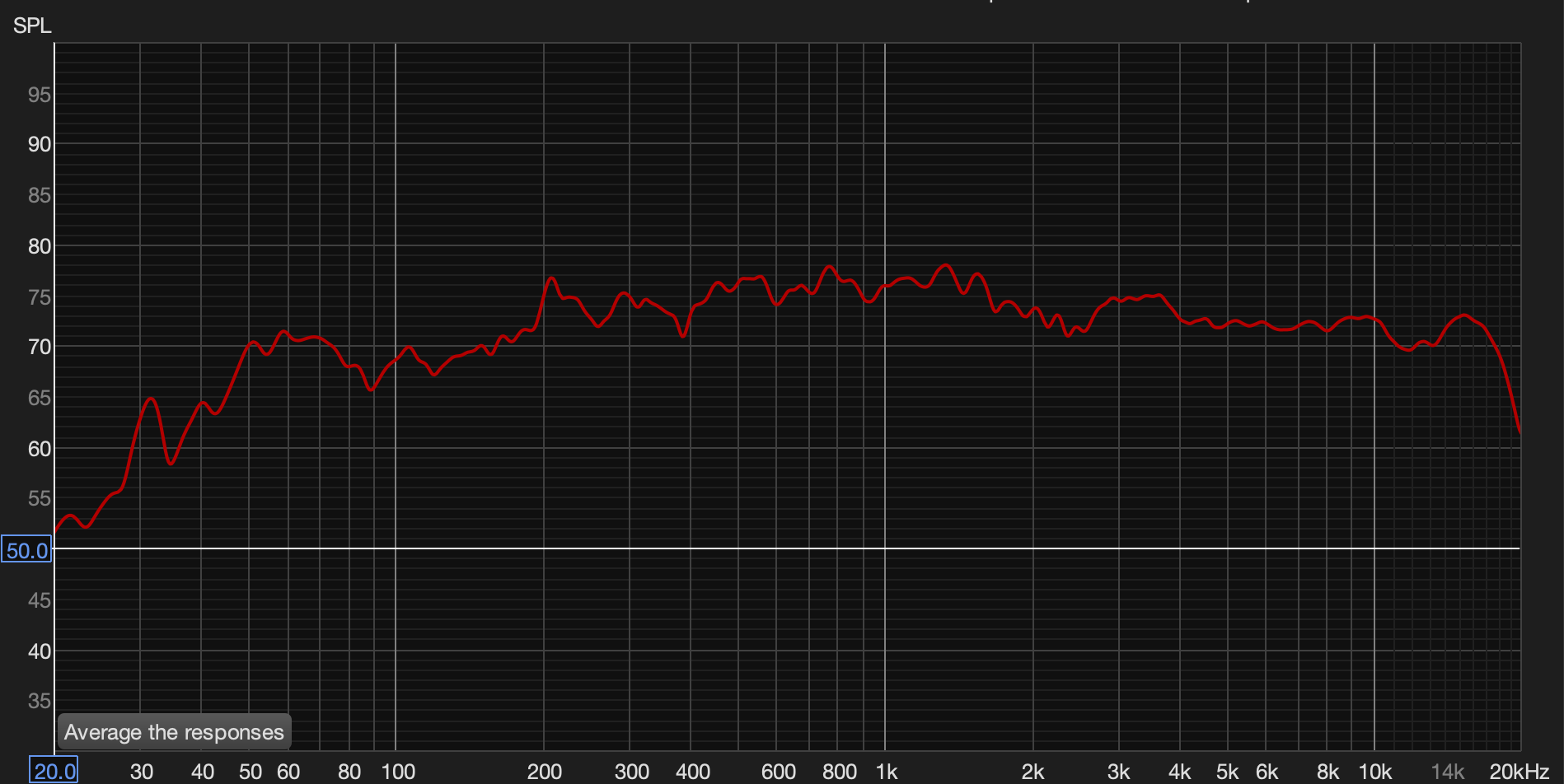

I did REW/UMIK measurements and they measured nicely and sound good too. I’ll try to update with pics and measurements when I get a chance.

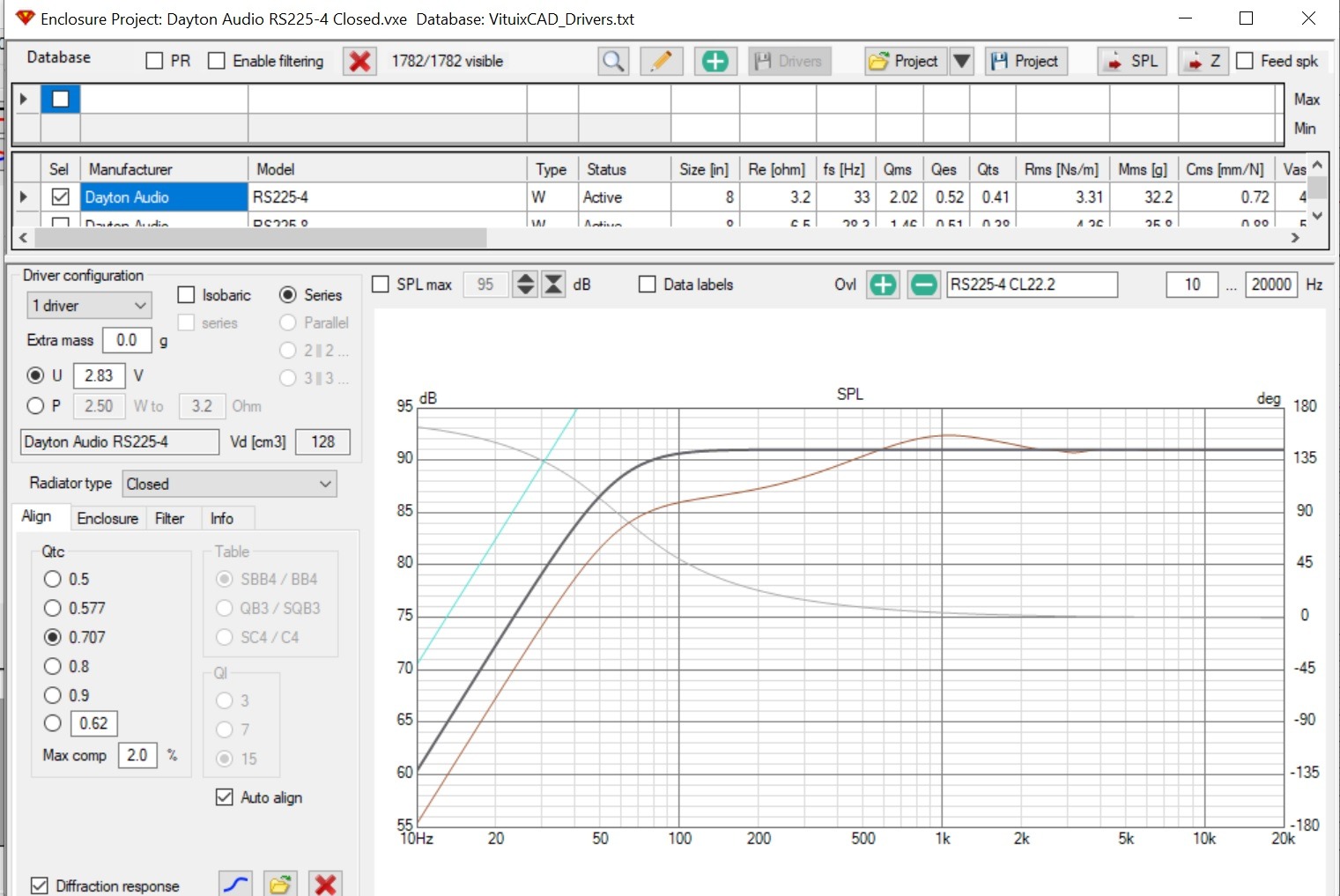

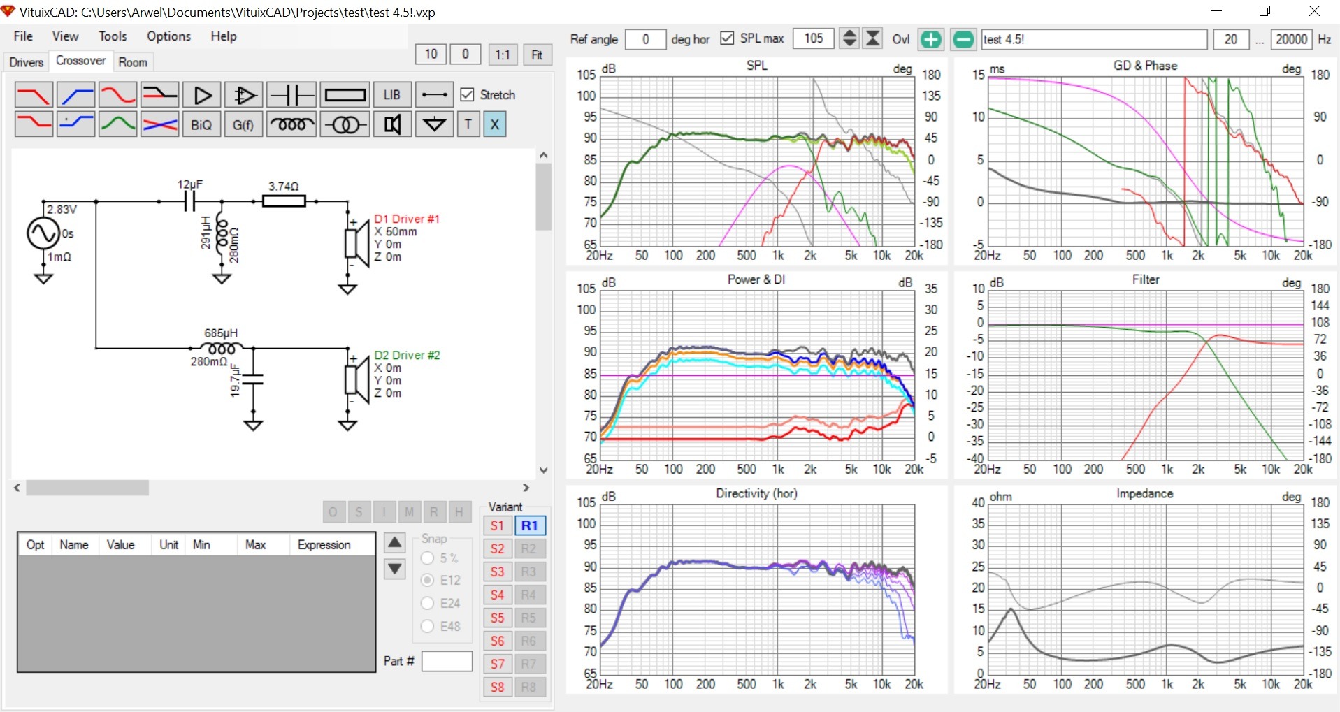

Dear DiyAudio members,
I decided I am going to design the whole speaker myself including the crossover. I understand most of the theory involved (musicologist and sound technician), but electronics are my weakness. I would like to share with you some screenshots from VituixCAD, explaining step by step my process. I would be pleased if you could let me know when you see a problem.
Thanks in advance!

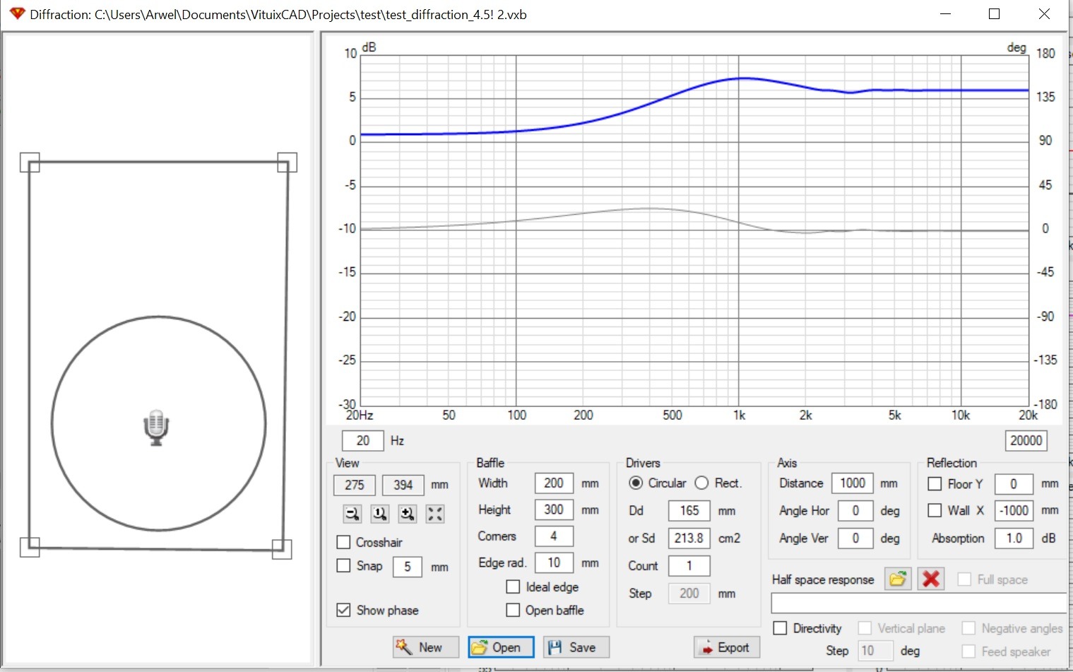

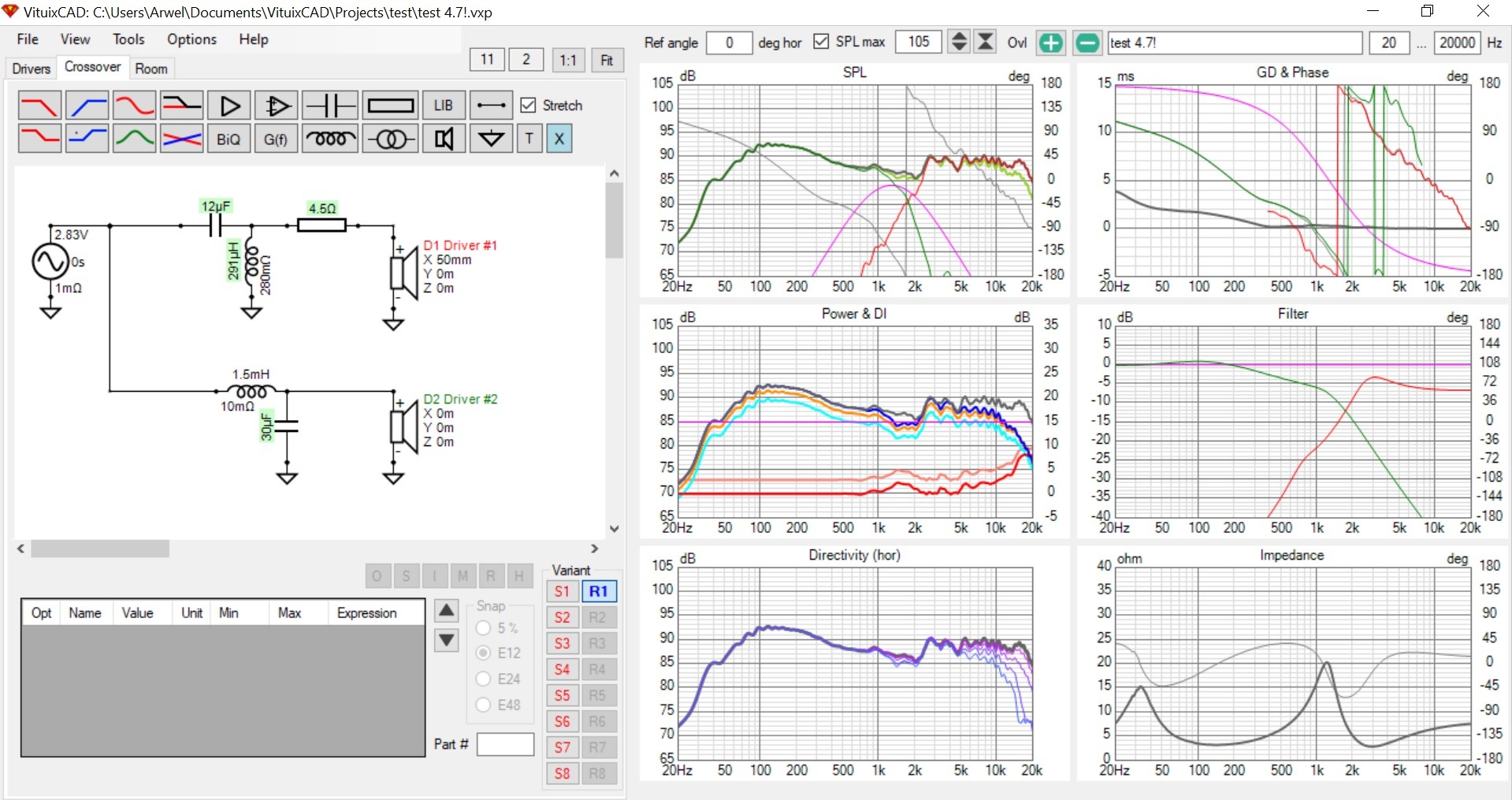

1- For designing the crossover, I downloaded the data from Dayton's website and used VituixCAD. I tried optimizing diagrams which were created on https://www.diyaudioandvideo.com/Calculator/SpeakerCrossover/
2- After doing this, I designed the baffle and chose an enclosure:
(*The enclosure is 22.2L)

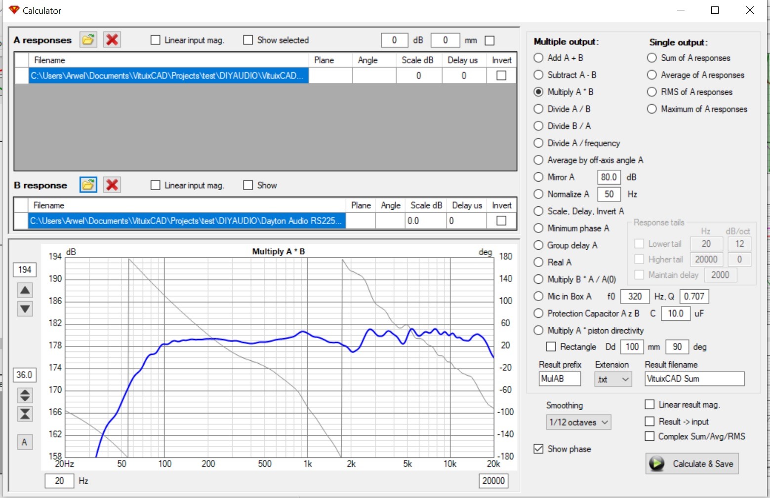

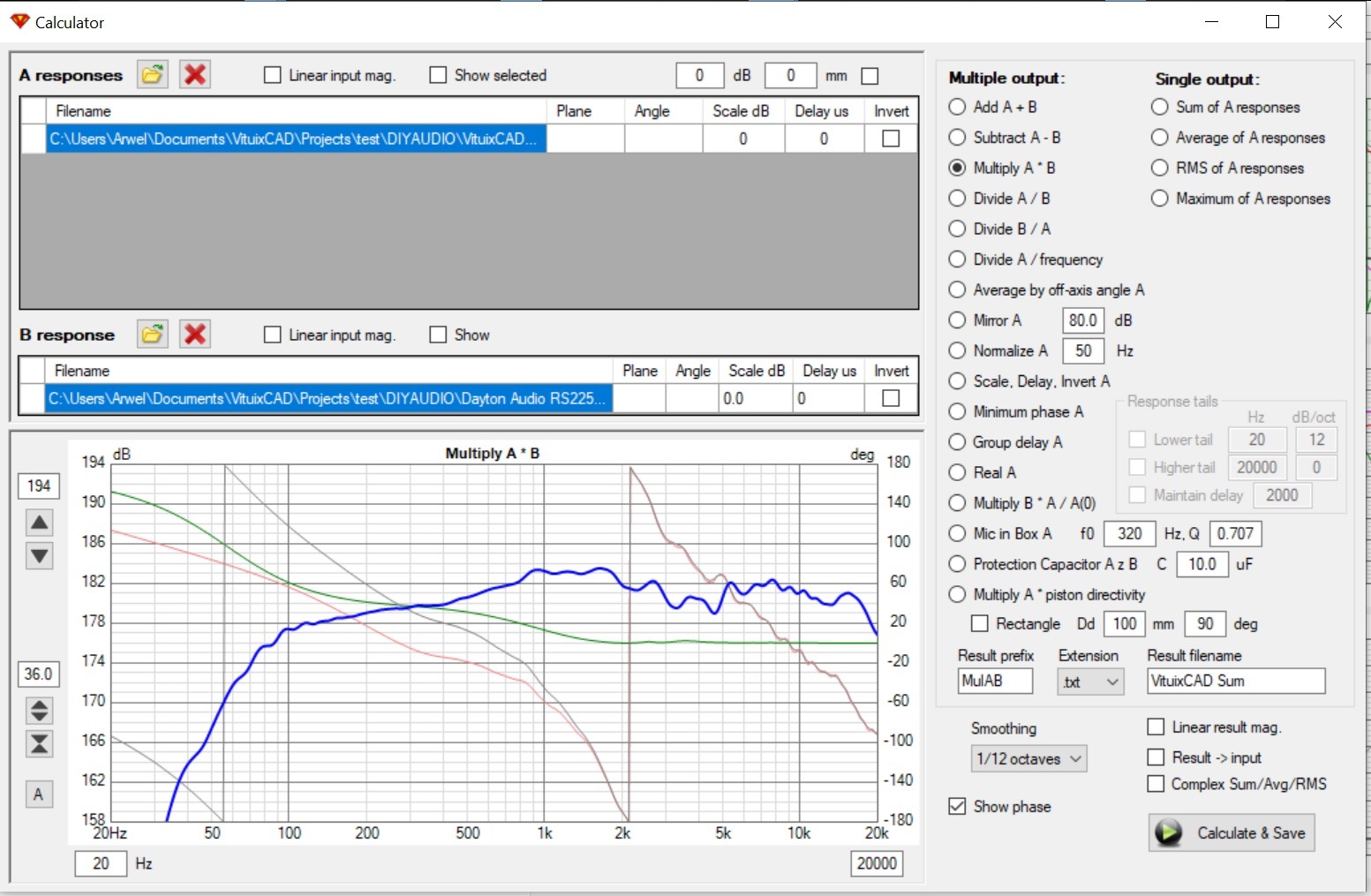

3- I used the calculator in VituixCAD to multiply the frequency response of the crossover with the enclosure's (with diffraction). This resulted in a quite big baffle loss :
4- So I redesigned the xover according to the baffle loss and used the calculator again to see the actual results (crossover + enclosure):

If this is your first time I'd recommend keeping an eye (ear?) out for off-axis response graphs/directivity too, as others have mentioned. The choice of a waveguide may help cross a bit lower/more easily, however waveguide selection likely requires some effort too, and your crossover need changes. Disclaimer, NAE (not an expert)
Thanks a lot! I have two questions:
1- Why can't I get more bass with a 8" woofer? Currently, it rolls off quite rapidly below 100hz (see my last graph in the calculator). Am I going to have to sacrifice the overall sensitivity because off the baffle step loss? Or, this is because of the enclosure's volume (currently 22.2)? Or both?
2- The way I used the calculator, is it right? Also, what's the next step? Should I simulate the room?

If I’m not mistaken the bass roll off is due to the size of the box basically becoming too small. Something ideal would be an infinite baffle, where one side of the driver would be another room or even the outdoors - but that’s not practical most of the time. You could vent, or even use a passive radiator, or use some sort of EQ compensation- depending on things like your source/amplifier and its capabilities. Baffle loss occurs at frequencies where the wavelength of sound is similar to the length of the baffle, that’s generally much higher than 100hz.
Tbh with the calculator I have no suggestion as Ive never used it. If you could create a graph of off axis response, and/or a visualisation of the audio output individual drivers (or maybe a directivity plot which might be easier), that would be a good step imo.

Then use a smaller woofer in the same size enclosure…..it will extend lower given the more suitable volume.Thanks a lot! I have two questions:

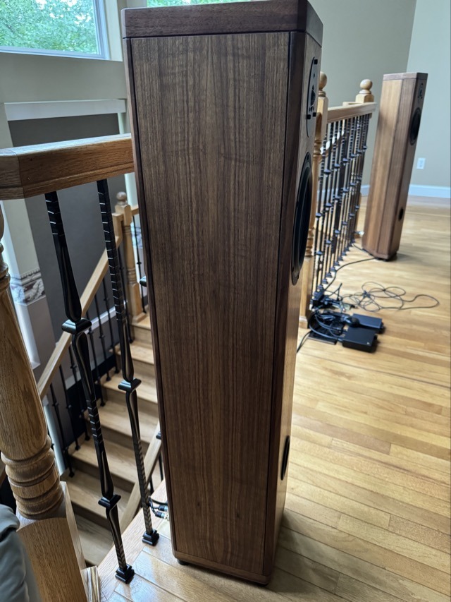

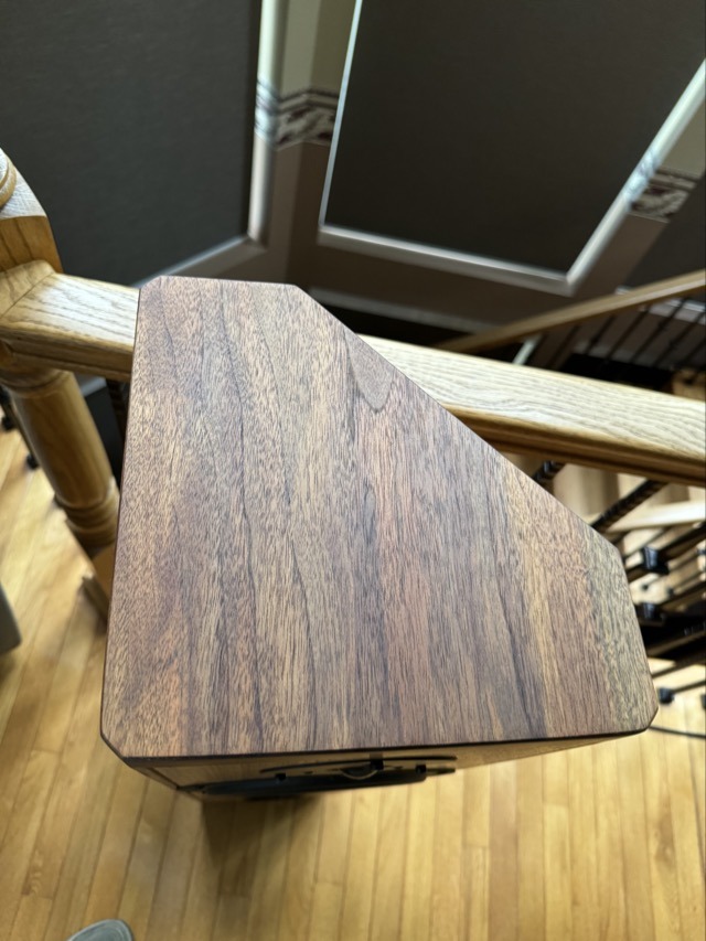

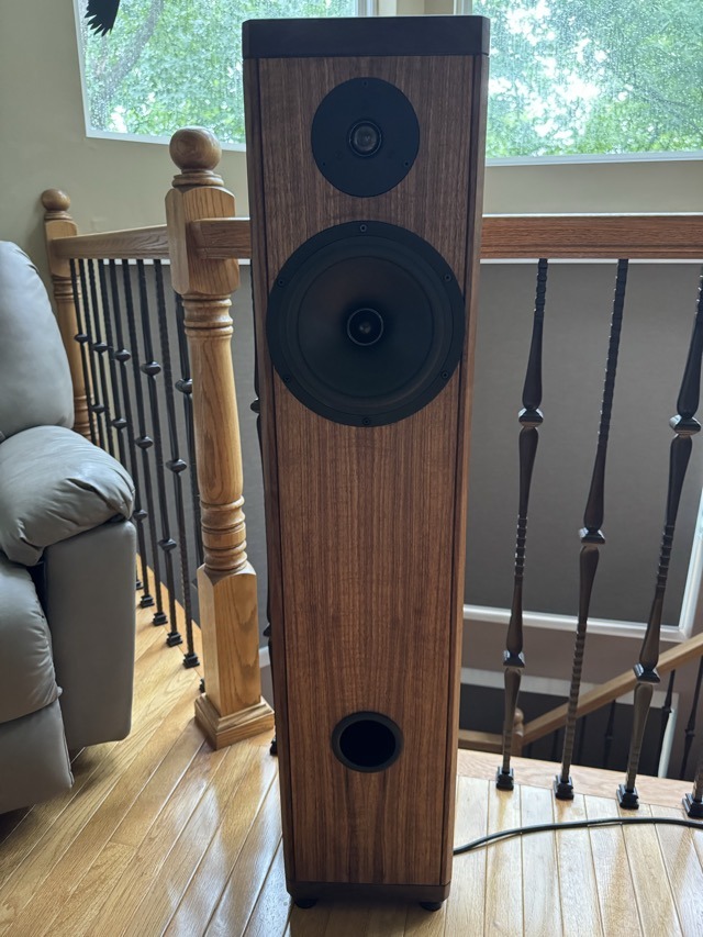

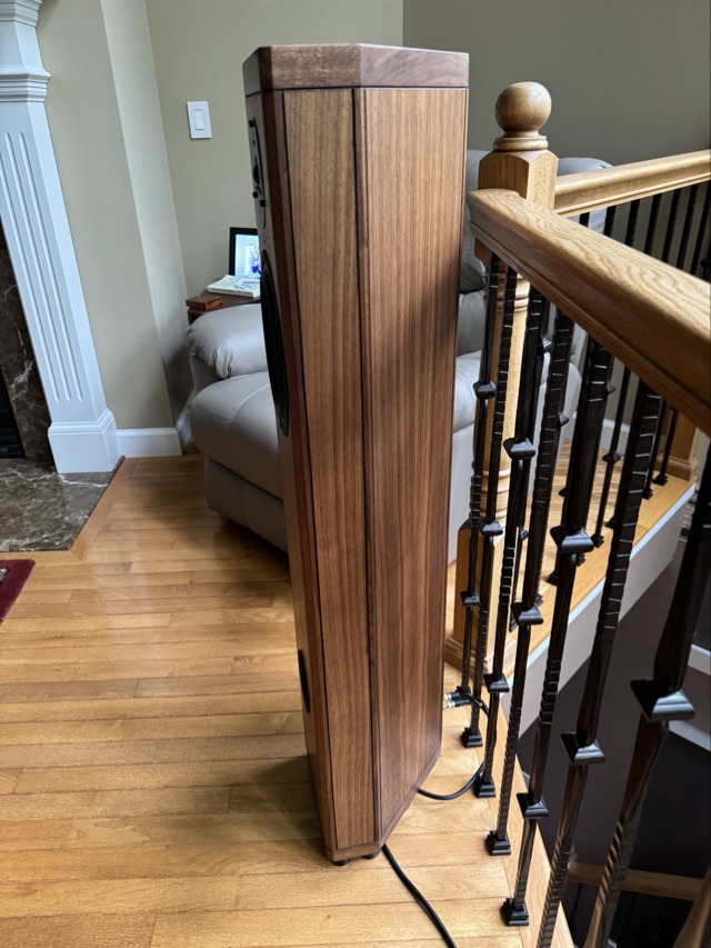

Pictures! The design is unusual. Long story about the location where I wanted to place them, which is not the location in the pictures. The top, bottom and corner pieces are solid black walnut. The rest is black walnut plywood with five MDF window braces inside. I did some fancy routing on the joints where all the pieces join up. I used auto sound deadening material on all interior walls and stuffed the cavity with denim batting. The two speakers are book matched for identical grain on all equivalent sides.
Good - you're applying the baffle diffraction response to the "raw" Dayton woofer measurements. Same goes for the tweeter.
Don't forget in vituixCad to check the "minimum phase" checkbox for each driver in the driver tab AND enter a Z offset for your woofer - around 50mm would probably be about right for a 1" / 8" driver combo (tweeter Z remains at zero). This is because you are not using frequency responses with measured phase data... but derived (minimum) phase from the individual frequency responses.
If you don't enter a Z offset and don't check the minimum phase checkbox, your phase data will be all wrong and your crossover summing won't reflect reality.
