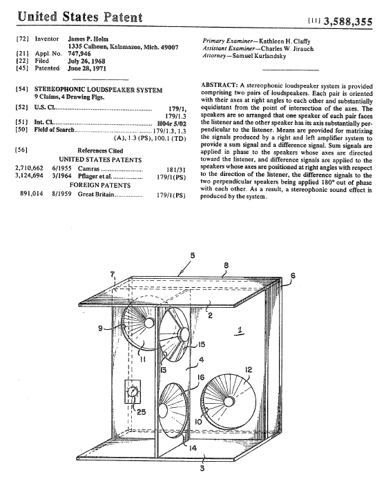

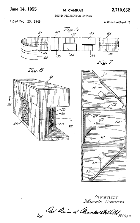

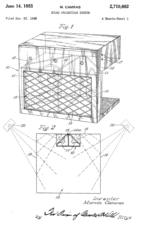

How would this work, using Elias's ideas?
the rear speakers bouncing off the wall, the forward speaker low passed:
(I'm thinking of a desktop situation)
Ok, reinventing the wheel :D 1948

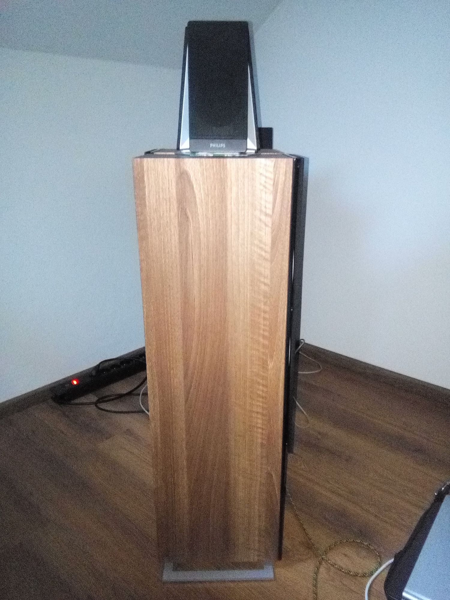

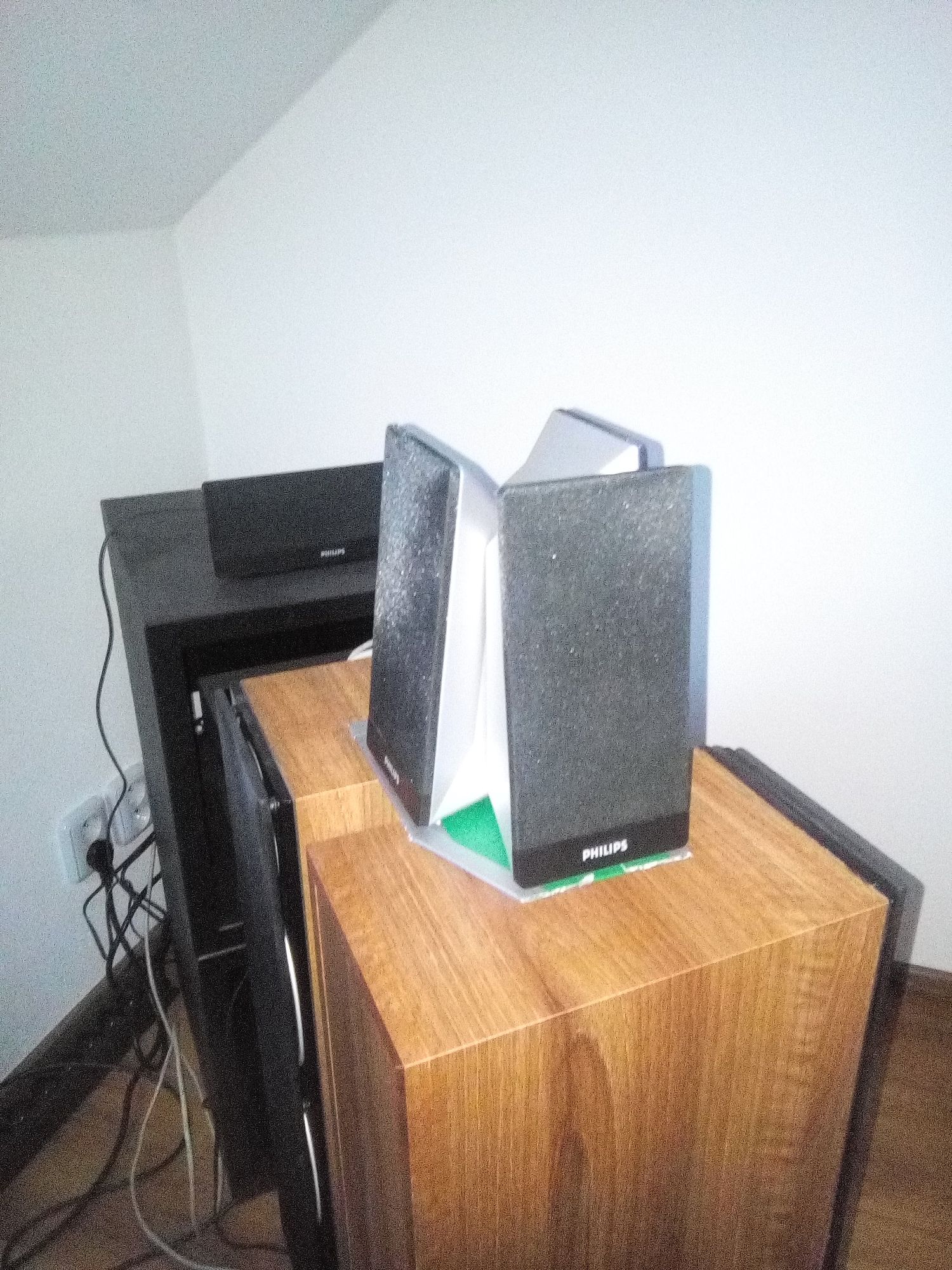

Some tests, after years:)
I put together three small speakers that were leftovers from a cheap HT system and wired them in the star configuration. I was quite happy with the result, instead of the psycho-acoustic filter I used a piece of paper blocking the treble. Definitely very good for background music, they will be installed in my workshop.
This experiment was enforced by my unhappiness with the speakers I had, Dali Zensor 5. Even when moved around the room, I could not find an enjoyable spot. I tried to place them side by side in the middle with speakers facing to the sides and I was really surprised with the result. Suddenly, I could tell the placement of single drums and cymbals, hear details like rim hits on toms, etc. And all that in almost whole room, amazing. I did not really miss the direct sound.
There are now two pictures as attachment.

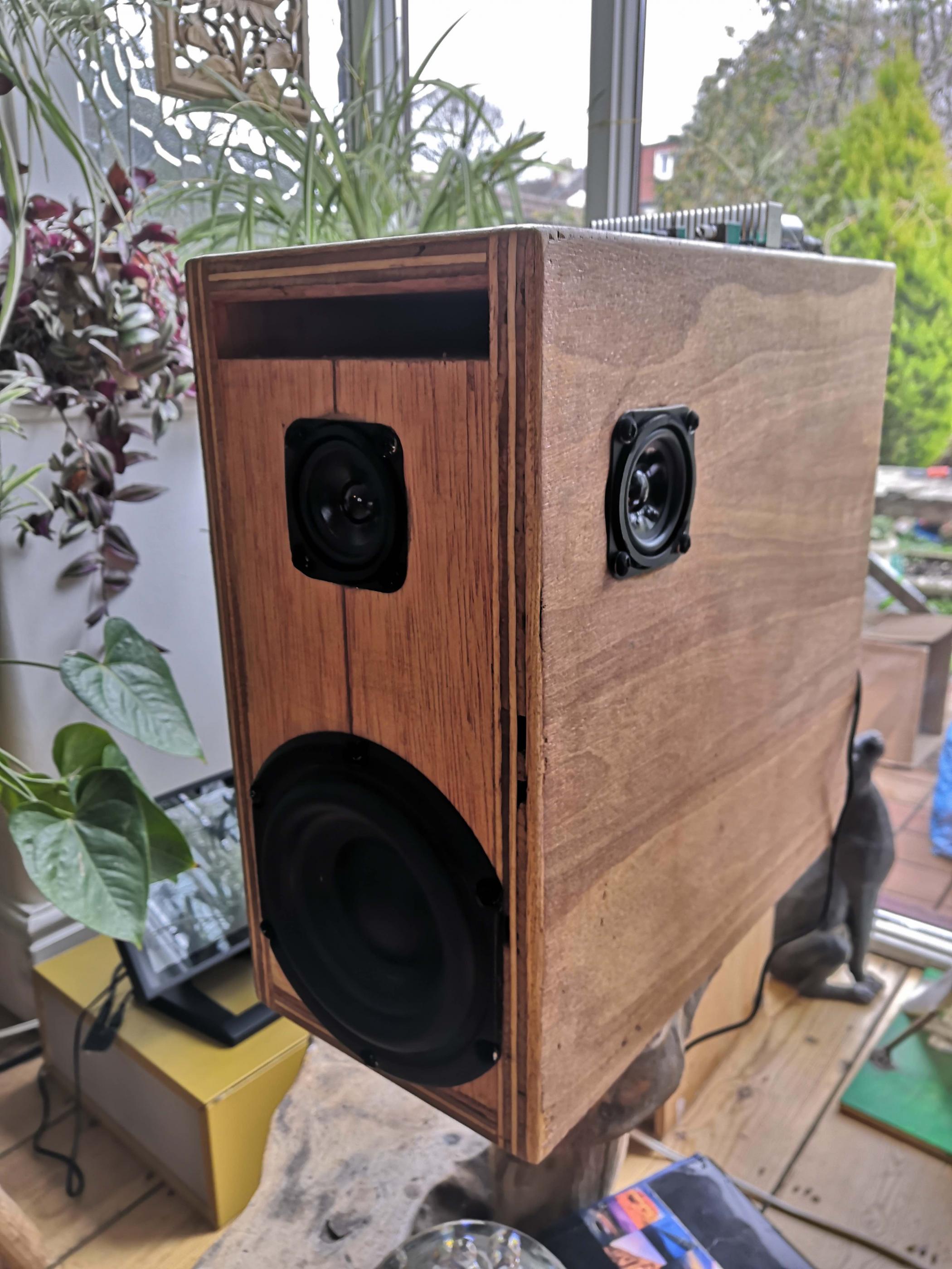

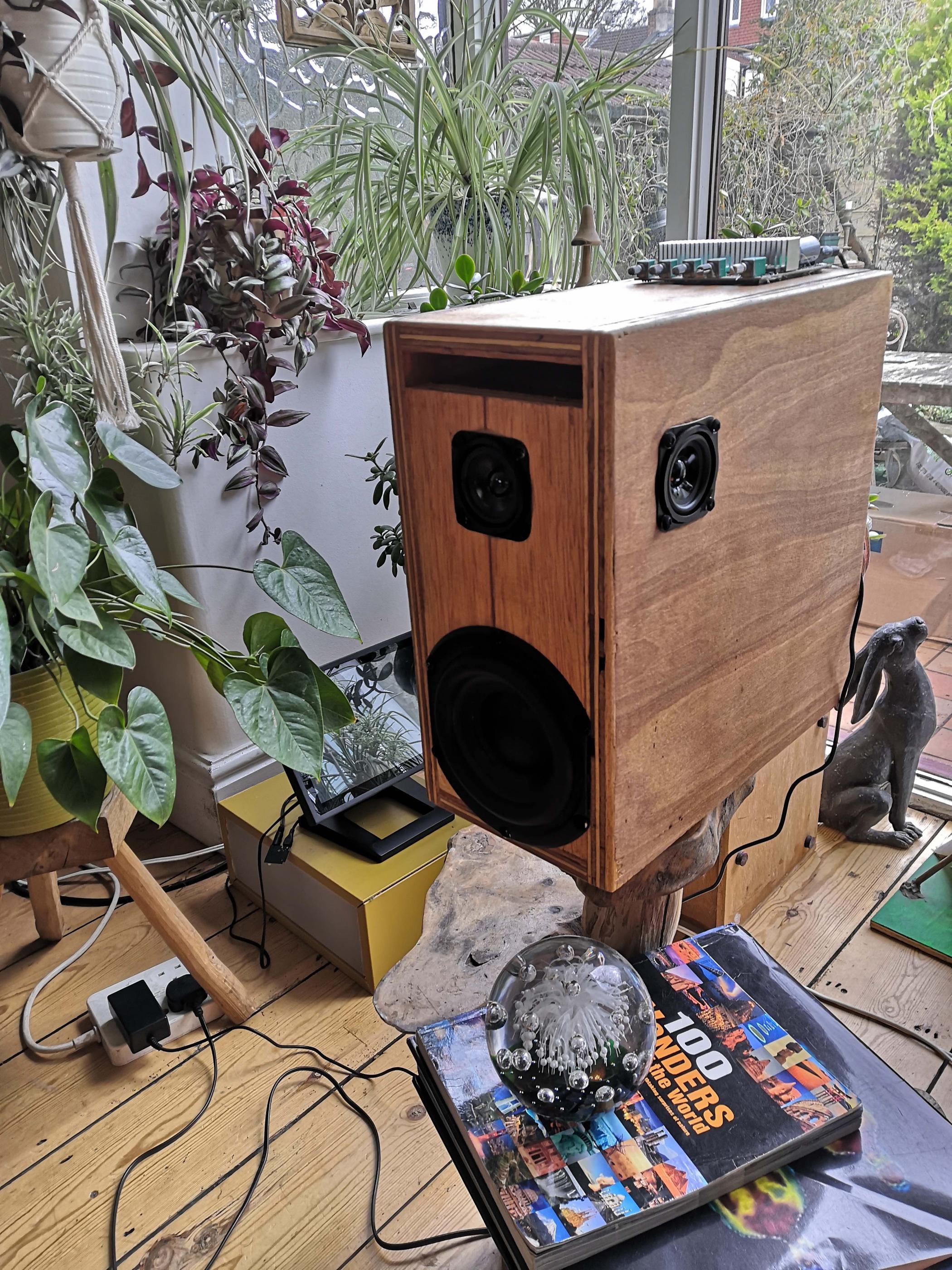

Thanks to Elias for this great set up.
I have built a fine sounding 2.1 version of this arrangement, using the super cheap Visaton FR8's with a peerless SLS-P830945 for bass. I've had trouble trying to source a correct amp for this project. After a bad experience with Chinese ebay-ers I was wondering if anyone had a recommendation. Either off-the-shelf or a someone who could build something bespoke.
What are people running these on?
Running it of a spare 3116 2.1 with a built in high-pass it sounds fabulous, except on resonant sounds like piano where inevitably there's some break up in the amp. I've got a 4.7 cap and 8ohm resistor, which seems to balance well for my box.
Here's the prototype. Would love to get the amplifier situation all within the box, running bluetooth. The full rangers have their own separate enclosure within the main box. Not sure if it would be called a TL or a BR with a long port.
I have a LM3886 2.1 amp running on my main system, but its BTL which I read somewhere does not take the combined ground signals.
