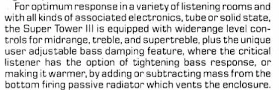

The thread started 22 years ago, and after ~two years dormant, davidc! revived it to ask about the Q factor of a cabinet using a 15" passive radiator in place of a port.
I wonder how much the down firing passive radiator suspension has sagged since it was installed, and how that has affected Fb and Q..
Sorry weltersys, are you complaining that I never saw, or didn't note, the quote you provided? Thank you though, regardless.
I check the sag of the PR on a regular basis. It's easy to just put you hand under there to feel it. The early versions of these speakers would sag very quickly, the later versions seem to last a very long time. I have two NOS CSS PR ready though.
