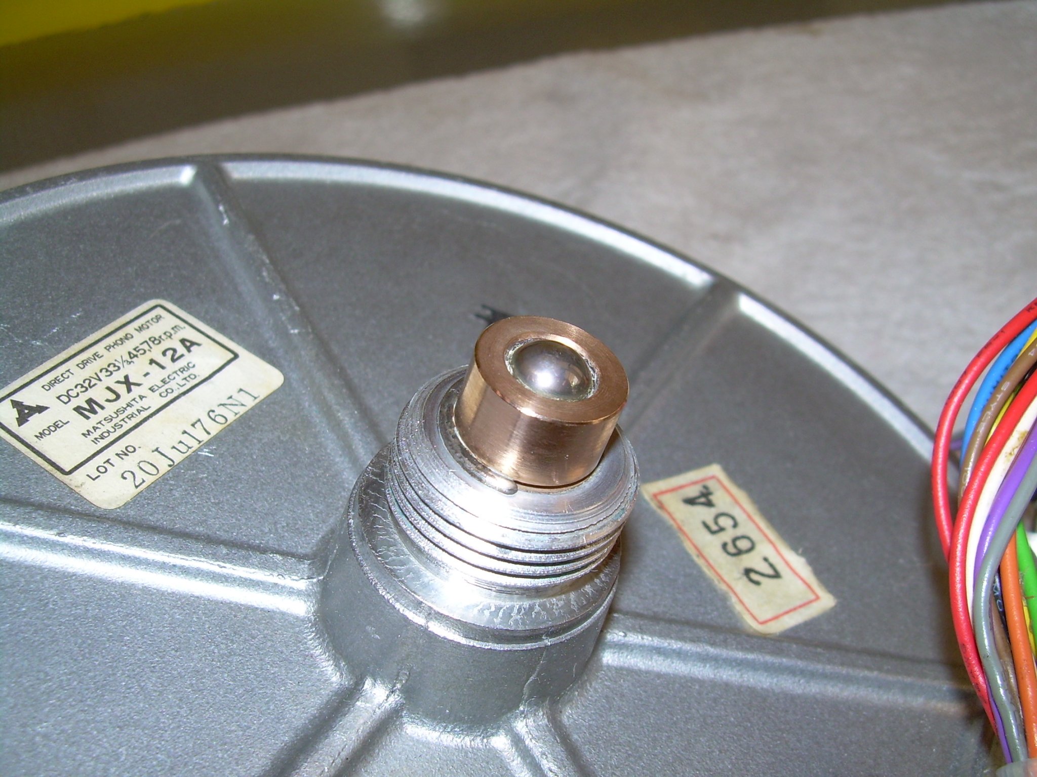

many thanks, I started searching on the web but many photos are no longer visible, it is not possible to understand for example (by not making the photos visible) whether the unloading of the bearing must be carried out with the cap in the engine inserted or removed completely; Does anyone have any guidance on this particular detail?

The cap MUST be in place or the ball could move, also possible for oil to leak.
The simplest method is to install a large bolt in the plinth and screw the bolt against the bottom of the bearing cap then lock it in place with a nut.

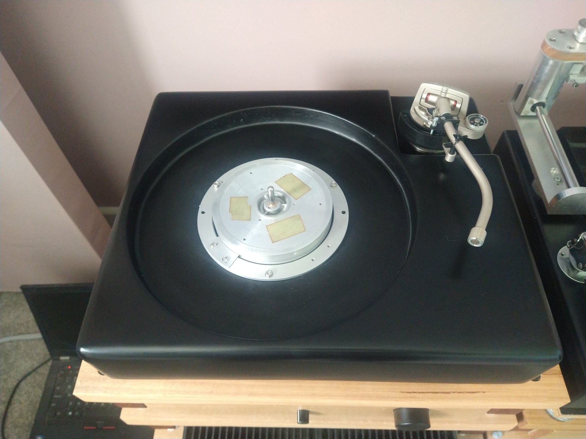

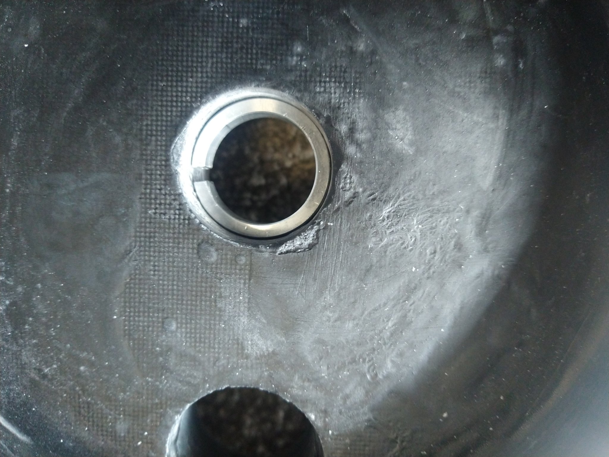

My solution is to use a locking ring. The bearing cap is tapered and opens the ring against the plinth locking the bearing against the plinth. This solution can only be implemented where the motor is removed from the SP10 chassis.
Photo of the bearing collar and installed motor

If one really wanted to make a design, with the main intention to work as a drain, there is a design that could be adopted where the Screw Cap on the Bearing Housing Base is exchanged for a oversized Cap machined from Brass.
The Brass Cap could be drilled/tapped to receive a Brass Threaded Rod.
The Top Face of the Brass Rod could be rebated to a dimension that enables a Bespoke Produced Thrust Pad to be inserted.
Different Materials could be selected to fine tune the voicing, resulting from this mechanical interface.
The Drain Rod could be attached to an Substantial Anchor Base produced to a Bespoke Size. The Anchor Base could be produced from a Metal, Cast Iron, Thermoplastic or Densified Wood. The Anchor Base can also be produced with a rebated Top Face, to allow for other substances to be considered for use in conjunction and safely contained. The intention for other substances is to have options to add a further voicing by being able to add a range of control for the the damping/dissipation of Bearing Housing Transferred Energy.
Substances to be considered can be Newplast Modellers Putty, Lead Shot, Oil Compacted Sand, or even a Silicone Oil.
The result of the above should be that a mechanical interface is in place that enables Bearing Housing produced energies to transfer through a path to a place of damping/dissipation. This path for energy transfer is successful in damping/dissipation will reduce the energy transfer that the Platter typically receives. The overall result being the Styli will not have as much non-modulation energy received.
The oversized Cap on the base of the bearing housing as a result of flexion being at its maximum at this point, can also have a counter measure side force applied via a arrangement of Three Horizontally Set Bolts.
Depending on the rigidity of the anchor point for the horizontal set bolts, the intention for the applied side force is to rigidly secure the Base of the Bearing Housing, as the oversized Cap will be a Pendulum and the flexion with added weight can easily manifest as a Ellipse Pendulum Rotation, ultimately increase off axis rotation for the Spindle.
