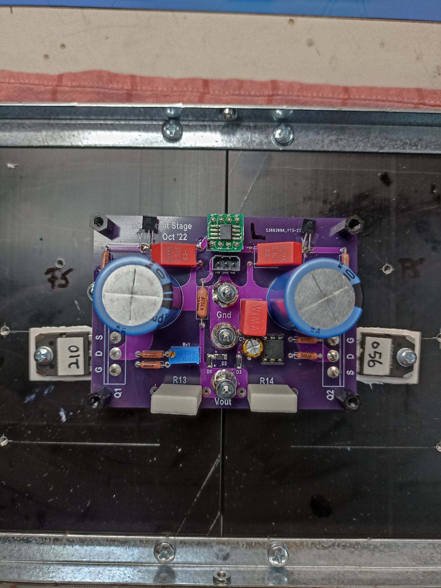

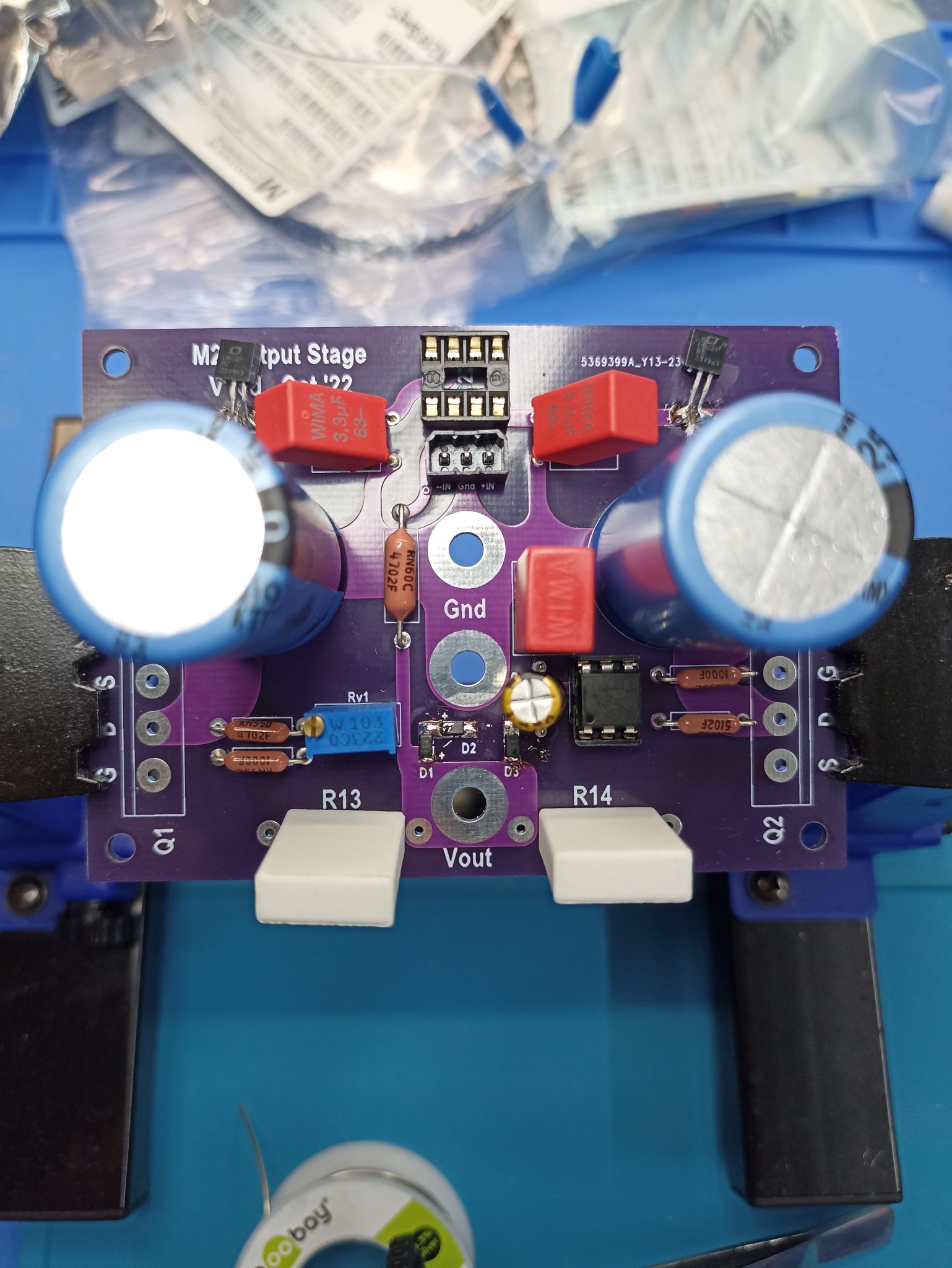

sry to report- not ok
R13,14 are 0R56--I know too low-high bias
Rail 2x 16,35V
2x 1,56 A
NMOS on Drain source has about 30 V --I shut down after 15 seconds getting too warm -PMOS 0,5V on DS
with trimmer 10k no chance to get dc offset to zero, only between 14,2V and 14,8V dc offset...
opamp pin 4,7 on 9V in relation to GND-OK
3 steps back ---let see tomorrow

Read the instructions again in post #74.
Did you include the 2.7V Zener across the 10uF cap, and lower the lower 51k to 39k ?
But test the M2OPS first without those and without the opamp.
Also, if you are using 16V rails, there is no need to use the LM329s, as the opamp can most likely survive 16V.

Ok that's it.Read the instructions again in post #74.

Because I started directly with local feedback and check only BOM local fb and text. At mixed FB it refered to local. Lfb it was written 51 k and so on.
Seems to be misleading for me.
So to be clear, I have to refered also to global feedback too.🤔🙂
Sry stressful weekend.....
If you use 16V rails + LM329, your opamp will have very limited output voltage, and the DC feedback loop may not work properly.
You should first test the M2OPS without opamp but say 23V rails.
Then add the opamp with local feedback.
Then change to loop feedback, before finally going to MFB.
One step at a time.
