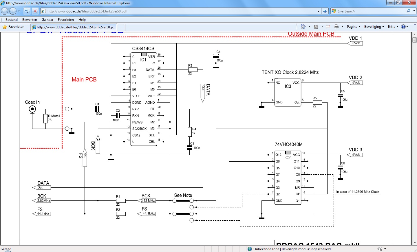

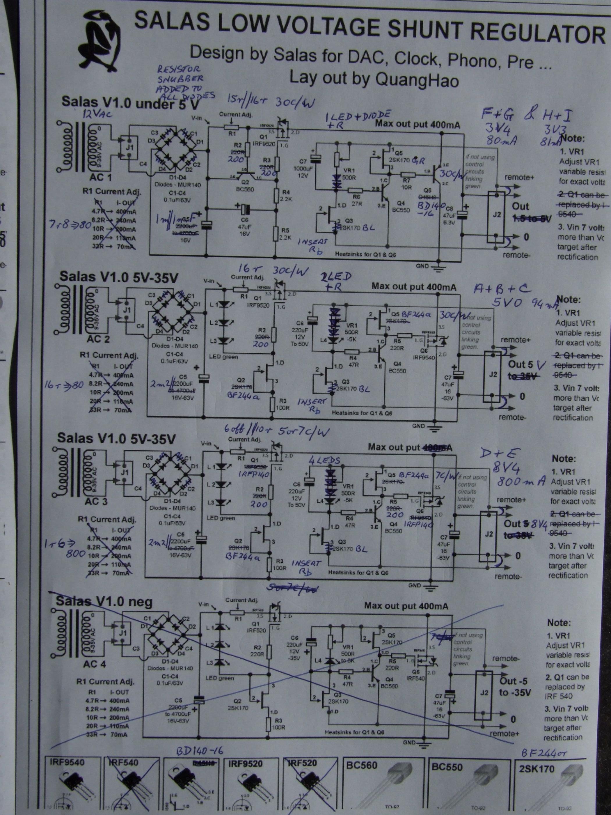

Here you have the schematic how the 5 volt Salas reg is build.

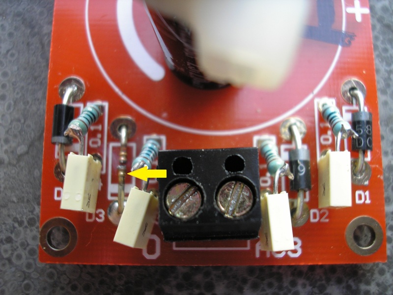

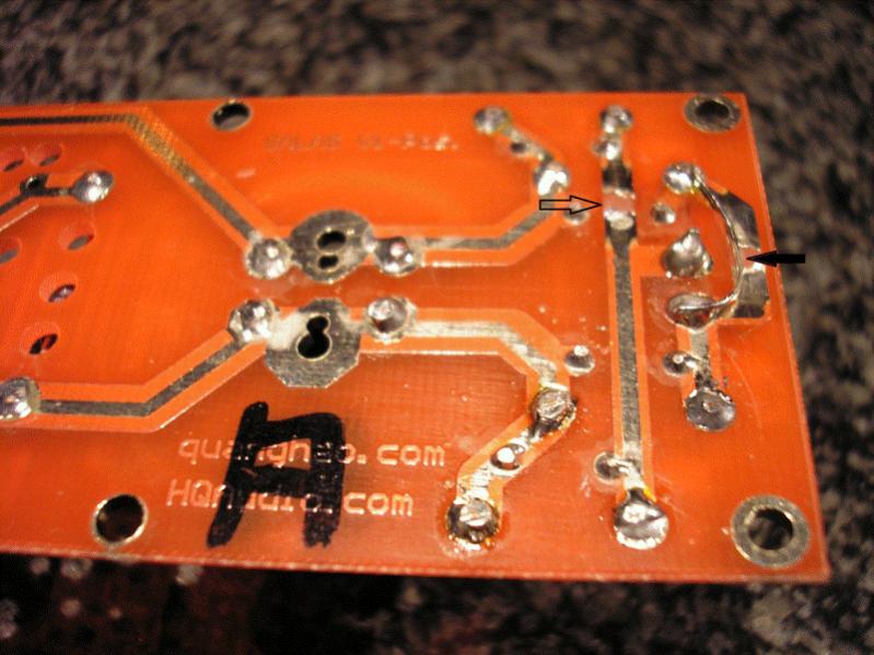

Last time you asked you said with 1N4004 was fine. What happened differently next? Does the bang happen when you connect the negative reg as third in a row, or any polarity?

Here you see the schema from receiver board.

First I would test with resistor dummy loads to each reg so to see how many can work in isolation of your supplied circuit. If it still blows a diode then I would see to use heavier diode. If nothing happens and blows only with the specific supplied circuit, I would use more transformers. Those are practical steps.
