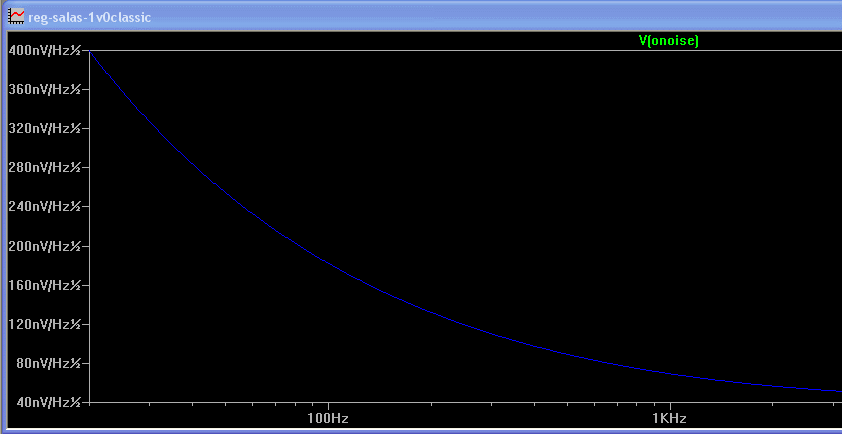

here is a picture, sorry it is not very sharp. This has the positive and negative regulator both on one PCB. In fact, the more I play with it the more I like it! It's a great regulator concept you came up with. All the LEDs should be about the same brightness, this is just my crappy camera misbehaving...
As mentioned over in the other thread, John Curl explained in a lot of detail the use of JFET current sources with resistors as voltage references, and why it matters to not put caps there, and I agree. Might have put a lowpass filter from the voltage reference, but then I didnt and it works just fine.
A current source for the LEDs would have made the thing more stable, no doubt, same for R6. But since I made it all adjustable it works that way just as well. (Honestly, I didnt think about that before you brought it up ;-)))
Actually, I didnt simulate but just built. And yes, I was surprised about these very low values and so we re-did the measurements and verified with other instruments, and yes, that little regulator does the job nicely! The output impedance is flat across the entire frequency range (we only tested up to 22kHz).

Pre filtering is good because those random very high frequency hashes that come in from mains and rectification usually find their way in the circuits loop areas no matter what PSRR, through many ways. Non the less the noise I showed is created in the regulator, its not something that it passes through, so its another concern. The input CCS is very useful for not reflecting current move outside, beyond what it can filter.
Your regulator is a good V1.0 type topologically with added considerations in being fast and having capable modern Mosfets. What it mostly lacks is remote sensing, especially in your case using long cables to the Riaa PCB's output side. That would ensure the nice 4mOhm flat through audio band Zo you measured its preserved at the delivery points. High gain is not good when not needed for no difficult load IMHO.

Hi, for this test the current source was set at 500mA and the output voltage at 12V. I then used a electronic load (selfmade) which was drawing 300mA, and overlaying an AC load current of 20mA. This load has a 1ohm resistor to measure the current so I could easily measure the AC current amplitude. I then used a soundcard with interface to change the frequency of that signal from 20Hz to 22kHz. At the same time, I measured the AC voltage at the output, and it was -50dBu or thereabouts, flat across the frequency span (with no signal, hovering around -90dBu).
And when you do the math, just like I redid just now, you'll find out that the output impedance of this regulator is -50dBu (=2.45mV)/20mA = 0.12ohm, quite lousy. Honestly, I do not know where I did that mistake in the first place - obviously the 4mOhm claimed earlier is false. Shame on me.....

30 times out of Spice prediction for the V1 topology? R.A.P was right to look for the garbage can when arguing simulators it seems.:D Anyway, I will be off to an island for a week or so, see ya guys, and if you confirm what is the best method and results it will be nice to see then. Maybe the cabling needs be sensed also.
