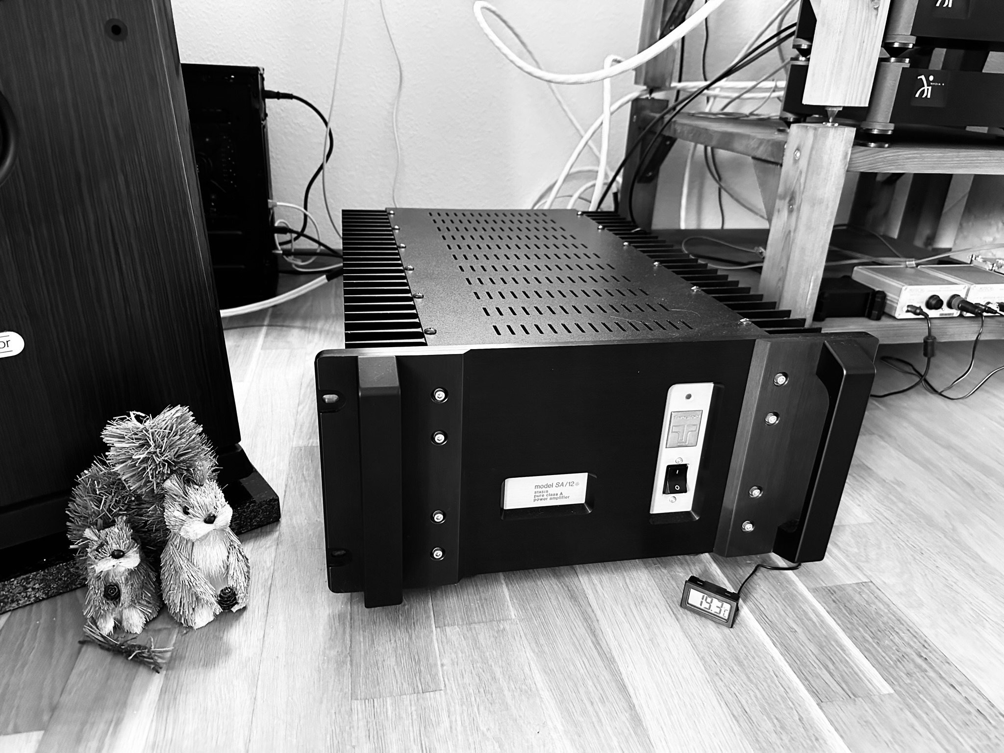

Is there somewhere a document explaining how to adjust the bias of SA12s?
Reactions: 1 user
No but I do have the schematic. I see one pot in the schematic. P1. I attached the PDF file. Let me know if it pulls up alright.

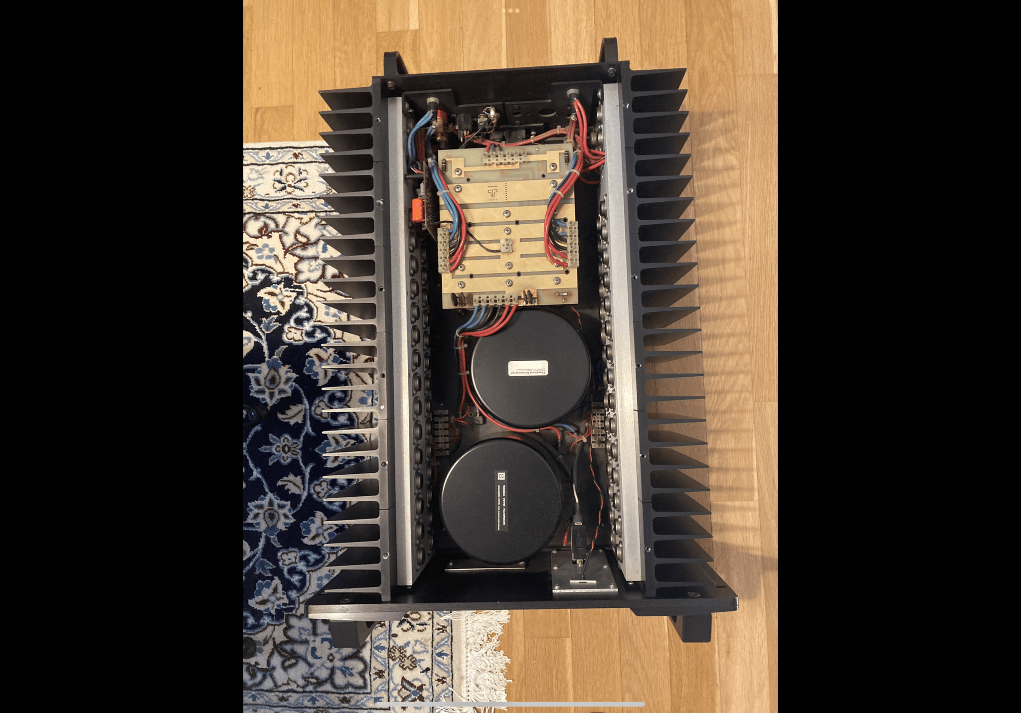

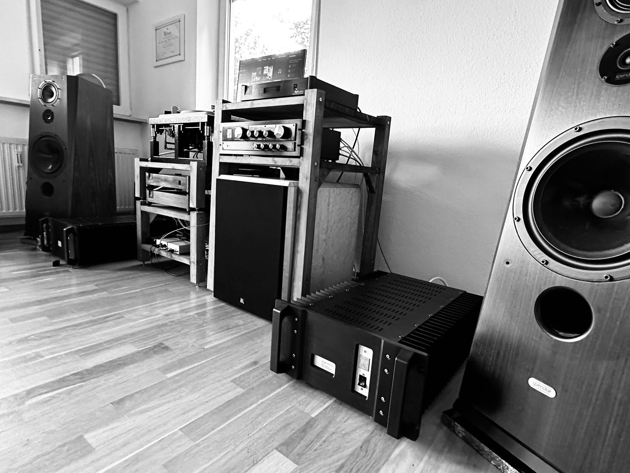

correct, that’s should be the one, I just opened the top cover, do you know where P1 could be hidden? Is the adjustment possible without opening the amp?

Joined 2014
Be cautious when turning the pot. I believe it is only a single turn.
Typically on these old threshold amps you just put the multimeter across a sorce resistor measuring DC.
You only want to do a little bit at a time. Place the temperature could settle. Put the top back on.
Reactions: 1 user
Joined 2014
Yes. You will see that the RCA XLR power ETC although accessible from the back is actually attached to the heatsinks. It is a really smart design. When you take the cover off, they stay put, yet all the guts are exposed. Take the 8 screws off of the back panel and you will see on the little board (the small one attached to the amplifier section on the left in your pic) there may be a trimmer pot facing towards the back. You will want a pretty small flathead screwdriver. I also put heat-shrink, electrical tape etc. on my screw driver shafts to minimize the conductive surface in case I bump into something.
You will want to put the multimeter across one of the source resistors. Take note of the reading. I suspect with that many outputs, it may be something around 40mv-80mv but that is an uneducated guess. I don't know the math required to figure it out and don't have the specs.
I use something like this to hook onto the source resistor:
clip leads
I also try to use the same source resistor each time. Maybe put a black dot next to it with a permanent marker or something.
You will also want to check your DC offset. I like to use two meters, one to keep an eye on the offset as well while I adjust the bias with the other. If the offset changes, then you know you have an offset pot as well or something isn't liking the bias adjustment... For the offset, one lead on the + & - binding posts (You ill want below 50mv).
Only do like say a 5mv increase in bias at a time since you are just starting out. You will want to put the cover on (if you have the clip leads, you can do so with them attached, just don't screw the cover on. Keep an eye on temp. When you are getting close, you can take the leads off and let things settle with the top screwed in to see where things are at.

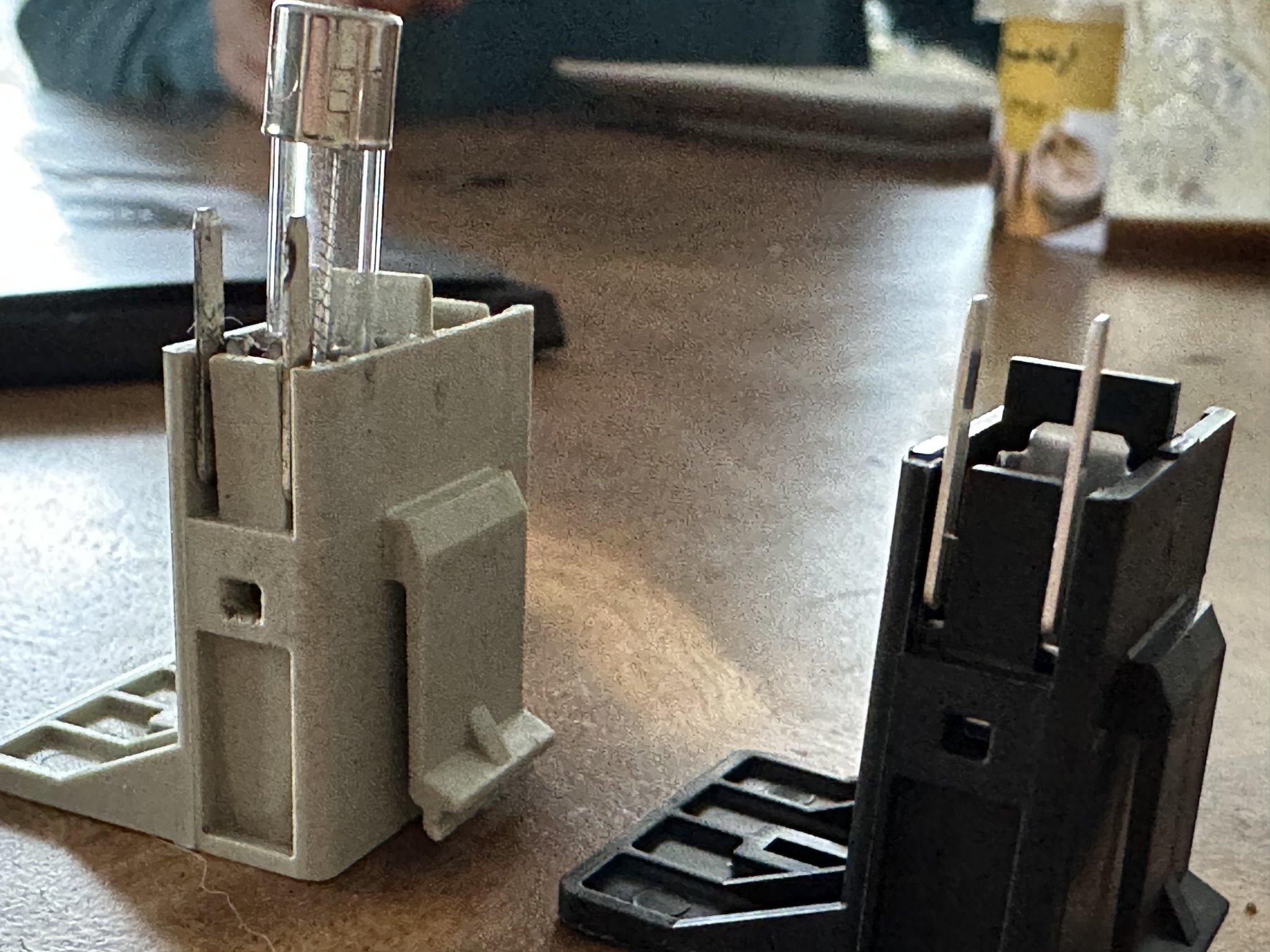

I still haven’t adjusted the SA12 bias, I kinda like their sound, at room temperature of about 16-17 C and about 2 hrs of playing, the temperature of the radiator blades reaches about 36-39 C. But I did chang the AC mains fuse drawer, I found the part in Digikey (Schurter). The old fuse drawer (the white one in the photo) had a lot of oxidation and some melted metal parts. After changing to a new part my first impression was some improvement in bass and lower frequencies. Might need some more burn in time but let’s see. Maybe the explanation for more bass, was more current (less resistance) in the path.

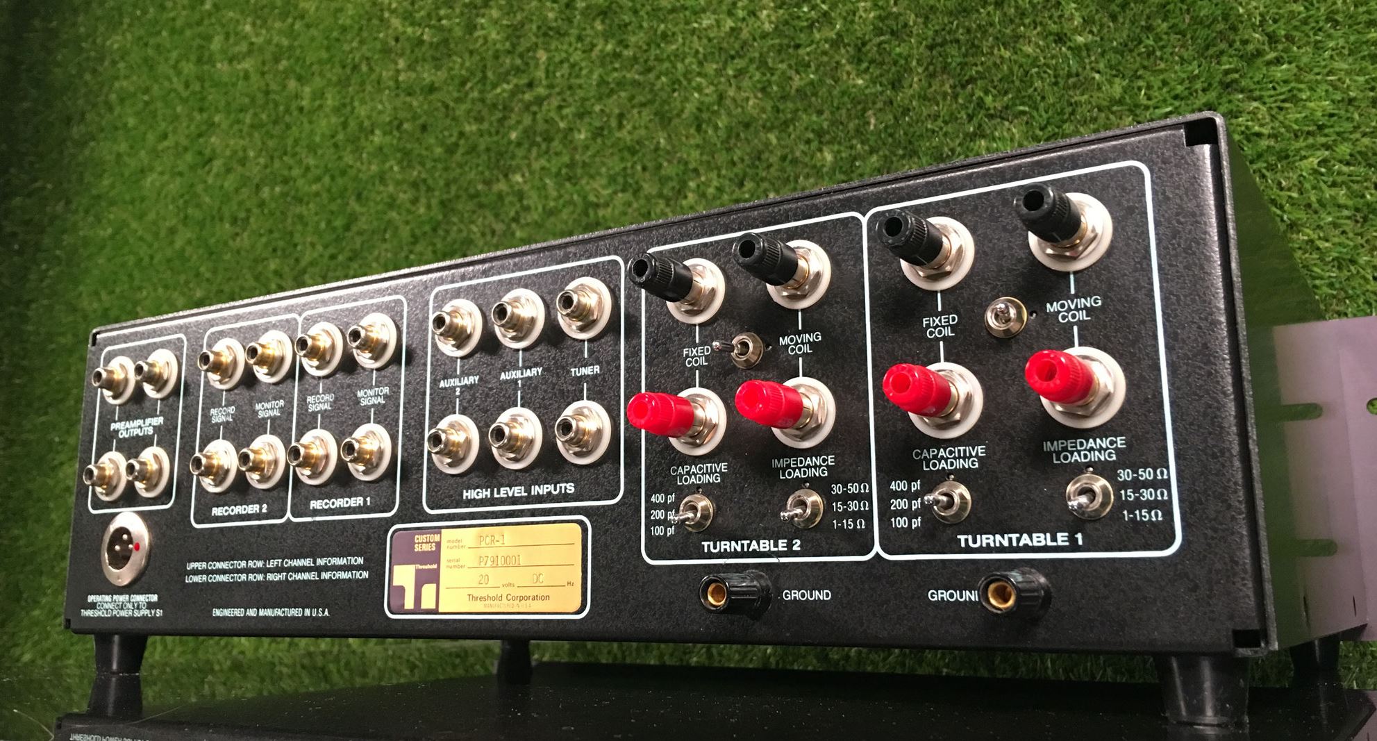

That’s the preamp which made me fall in love with the music, your Threshold PCR1 (Parallel Coherence Reference). As far as I know the only one in Germany.
Do you have the schematic of this amp? there exists basically no information about it..
regards,
Karl View attachment 1130094
That's the prototype PCR-1 from the late Wernher Baden the German Threshold/Pass Labs importer WBS. It has a serial ending beginning with 79 and ending with 002 designating: made in 1979 the second one. You probably bought it from CJM Audio.
It's a treasure now of course but the right thing todo is the give it back to NP...;-)
