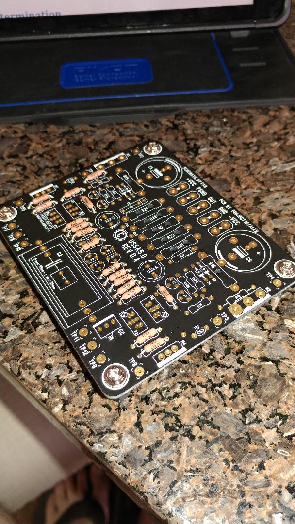

Amplifier Design/layout: Fab (The Great and Powerful Ape)
Amplifer PCB Layout: Alex

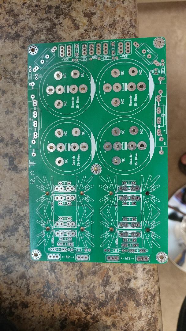

PSU Design/Layout: Project16
PSU PCB Production: Prasi

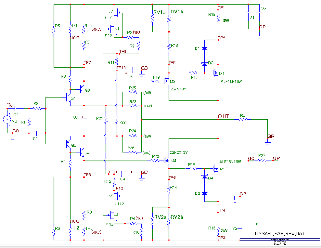

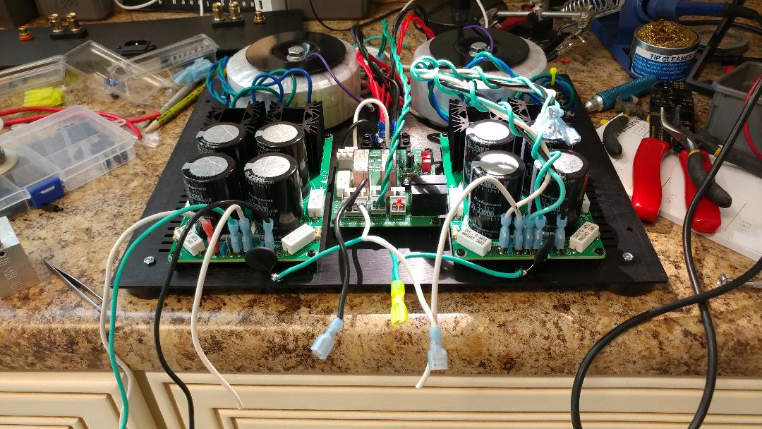

The schematic:

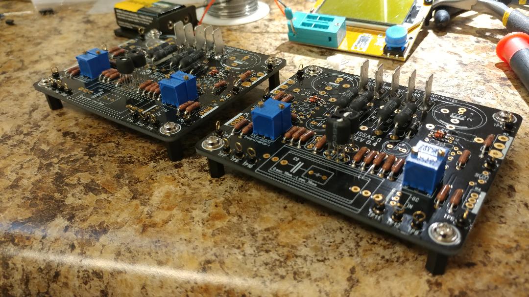

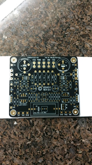

The boards:
Populating:

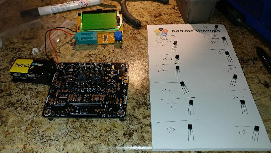

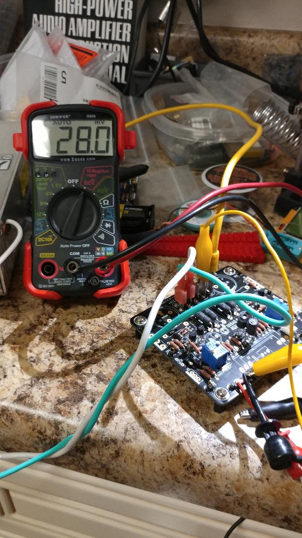

Matching the CCS fets:
Reactions: 1 user

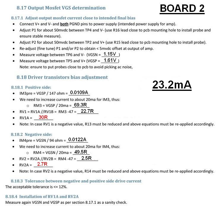

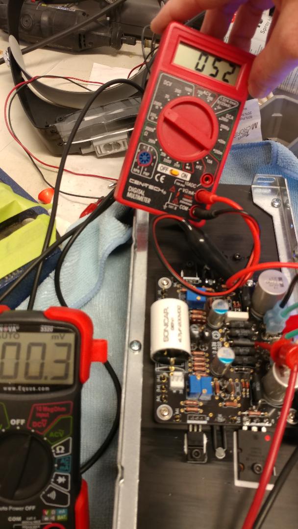

The last thing prior to listening and bias was to determine the output Mosfet VGS for each board.....both Fab (after a case of bananas sent and Project16 verified my numbers:
From Fab's amazing manual:

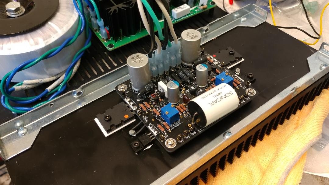

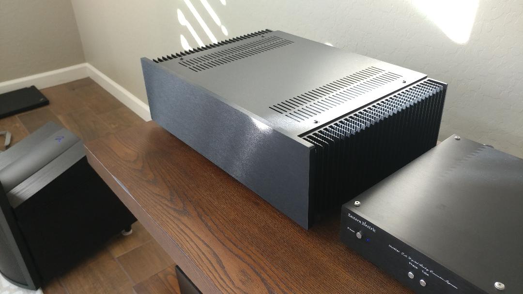

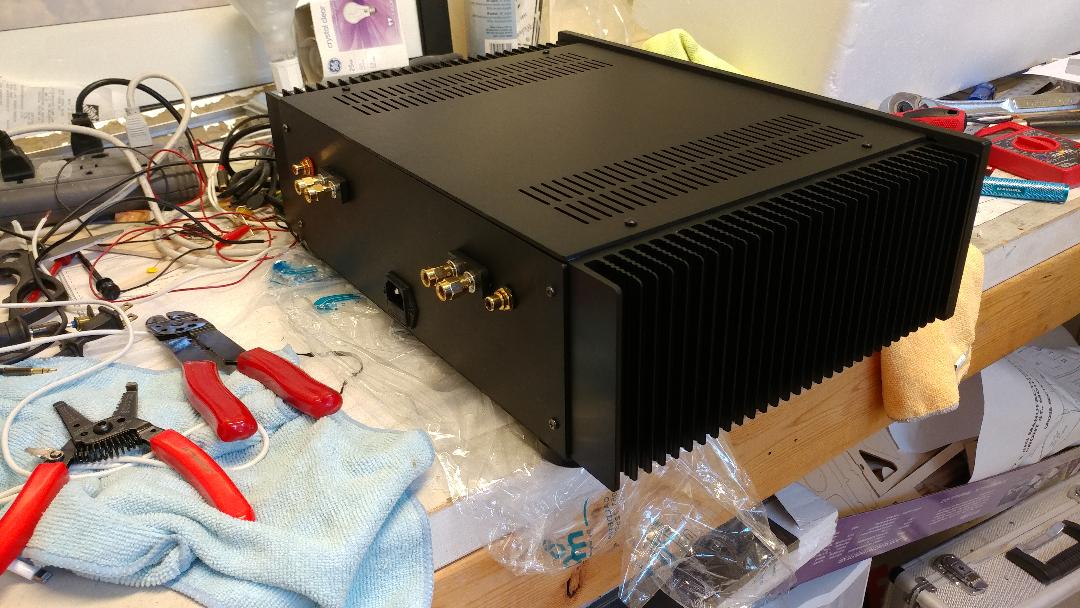

The amplifier now has some 50 hours of burn-in. Therefore I can now do the review:
Speaker used: Martin-Login Montis electrostatic loudspeaker with powered woofer
Pre-amp: DCB1 hot-rod (high-current, shunt-regulated buffer) with DACT 21 style shunt attenuator (I am now listening with just my attenuator)
DAC: Eastern Electric Mini-Max Supreme 12AU7 buffered ES9018
interconnects: pure-silver in PTFE insulator
Source: Tidal music accomplished via Roonlabs from a dedicated Windows 10 server.
Amplifiers compared: VHEX+ and Aleph J (both built by me)
I didn't really know what to expect with this amplifier. I had never owned a Class-A amplifier of this power rating. With my incredibly sensitive loudspeaker I knew that it would be enough power, but would it be different from others amps I've heard, such as the Aleph J that I built?

In closing, the USSA-5 is brilliant engineering: it is a triumph of both emotion and truth. Isn't that what we are looking for in life?
Is it the best amp I've ever heard? Emphatically, yes it is.
