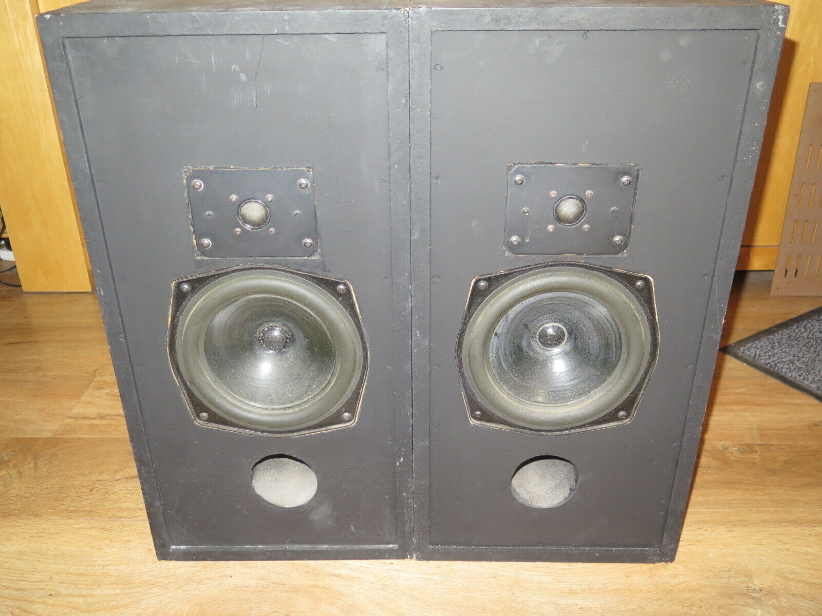

Czy ktoś wie, jakie są te głośniki? Waga 25 kilogramów głośników Audax

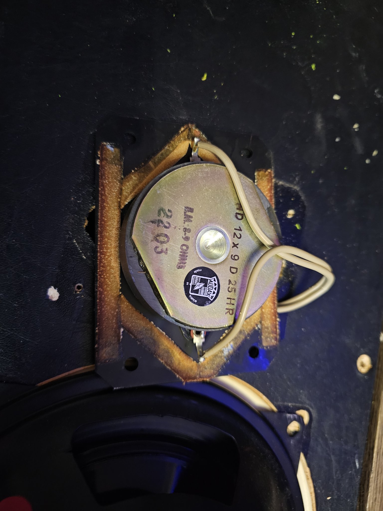

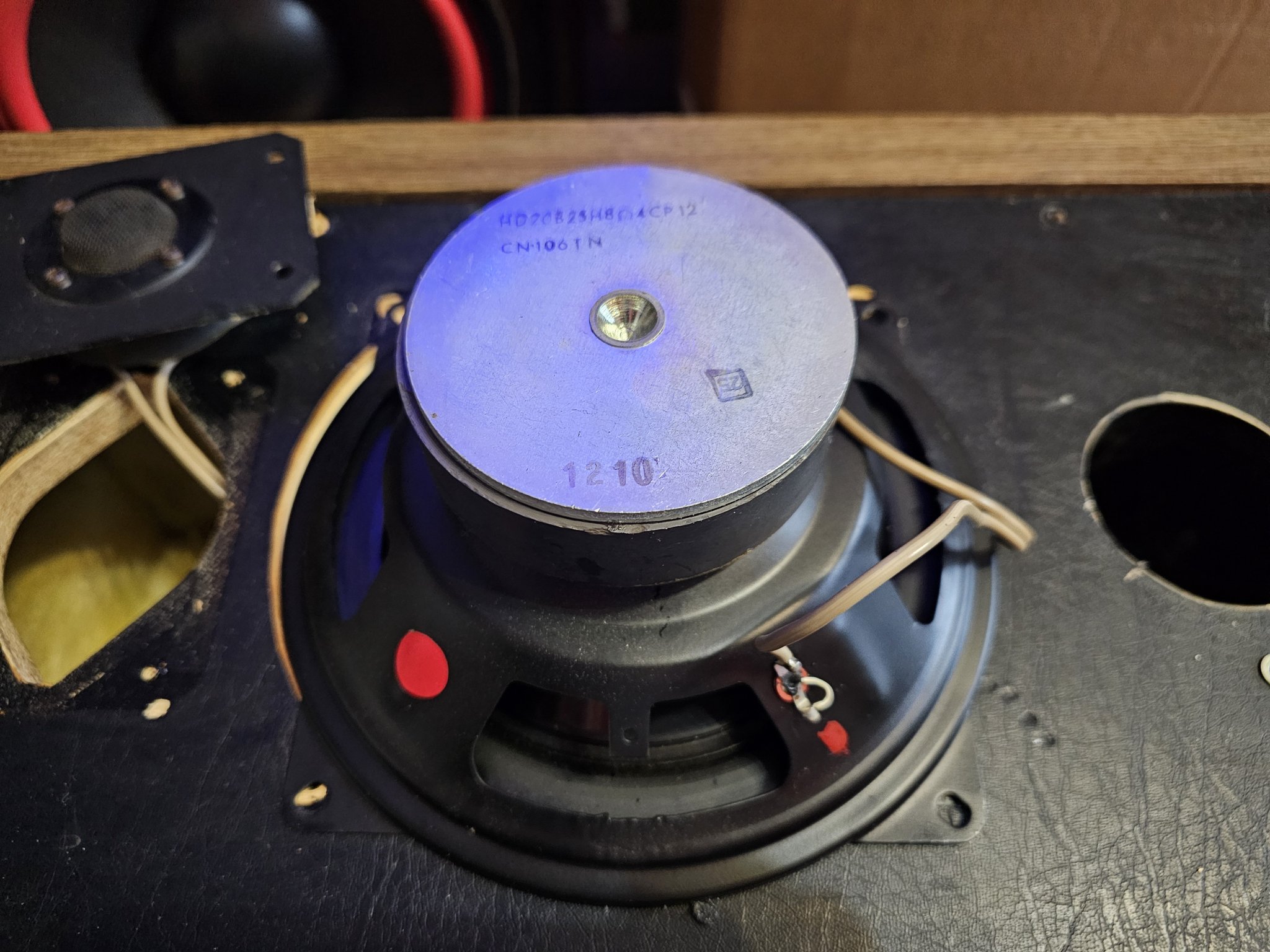

Does that say HD20? From the first photo they don’t look that big. This, or a variant (there were many) were used in the Tangents i was so fond of. And i have a set of wall-mount (give away) with the 6.5” woofer.
Do all the drivers work? If so i would suggest time to build a better enclosure. Better material, better alignment. I wonder if the woofers would work in Joan (bigger, lots more bass gain and extention)?
dave
It is a home-made box. Look at the slot head screws. I guess it was made in an East-European country, where this type of screw was common. Also the box wall thickness (which is a good point) suggests it is not factory made. Commercial boxes have less thickness.
I can imagine it sounds good. Once I also built from Audax speakers, they are pretty good for the price.

I´m quite shure, this is a fairly solidly built version of the DIY-speaker kit from Falcon Acoustics called "The Tabor". By myself I bought a pair of these kits around 1980. Alas, i don´t remember if the crossover came as a set of parts or already mounted on a circuit board.
The Tabor was designed by Malcolm Jones of Falcon Acoustics who, prior to joining that company, did most of the design and development of the legendary KEF drive units: the B139, B200, B110, T15 & T27.
The DIY kit incorporated drive units from Sonaudax, a British company that that no longer exists. The tweeter is a HD12-9D25 and the woofer is an HD20-B25.
The crossover came pre-constructed.
