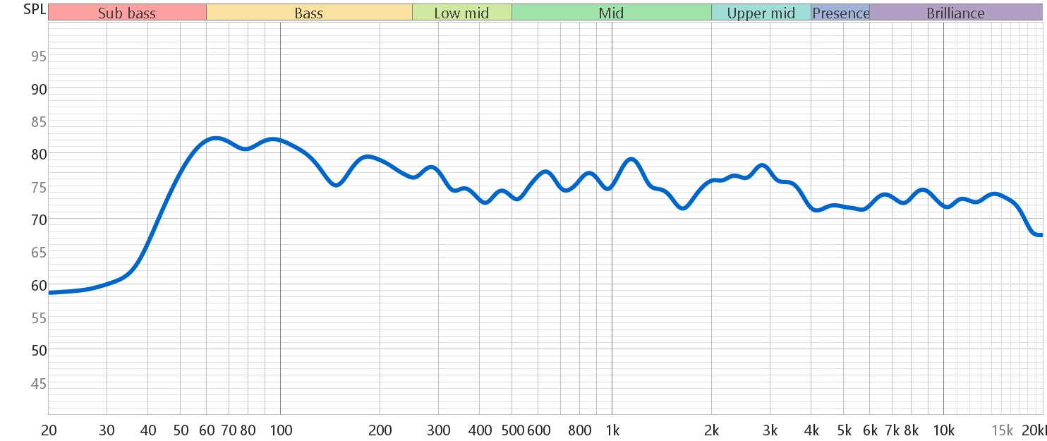

4 large dual woofer speakers
I just picked up 4 of these dual woofer 3 way speakers. They were probably custom built in the 1970, they big and heavy. I've have been fixing the crossovers that fell apart over time.
The midrange and tweeters appear to be good quality and are mounted on top with speaker cloth covering the front and sides. The rear ported cabinets are approximal 3.3 cf with 2 10" woofers that I guess are Eminence. The internals have some unique braces and a quasi labyrinth design.
Any suggestions on how to get a better response curve?

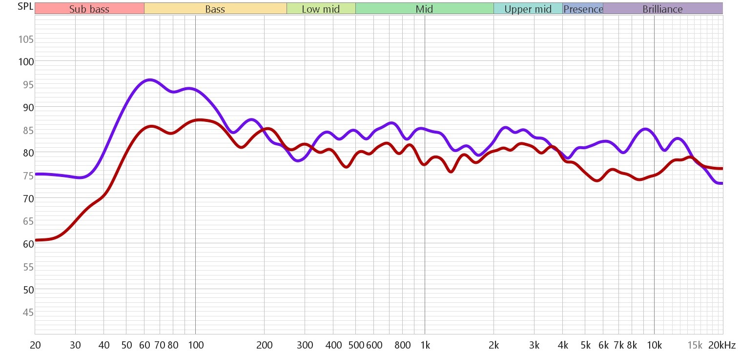

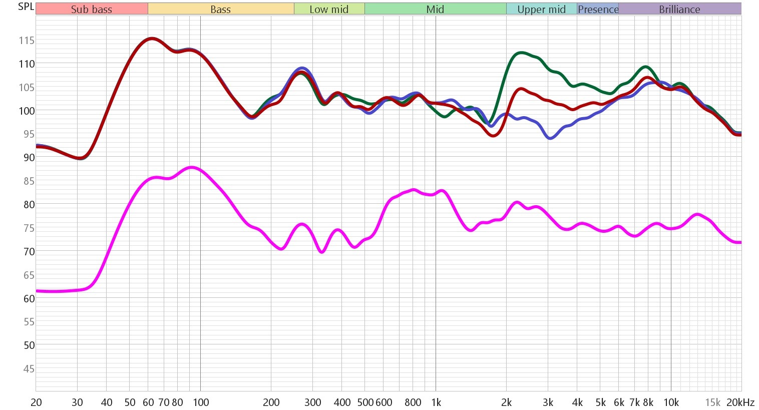

I bought 2 ten inch woofers after receiving advice from Simply Speakers. They are 4 Ohm rating that I wired in series so they should be 8 Ohm now. I ran the REW frequency test and not much difference below 300Hz. There is a L-Pad for the tweeter and I made some test with that. If I turn it down, the peak at 2000Hz flattens out significantly. But what is bugging me is the 10 db peak in the bass area. Below is the REW frequency response with the new woofers installed yesterday. Maybe I'll try plugging the 2 back ports and stuff the cabinet. The top 3 curves were at 3 different L-Pad settings. I can tweak it to make the 2000Hz peak less a problem. I'll try laying down some padding round the mid and tweeter to reduce the defraction.
The bottom one is with the old Eminence woofers.
Also, I worked on cleaning up the crossover. I was able to wind the inductors, zip tie, and coat them with polyurethane so they never unwind again. I hot glued them to the backing board. I will try and draw a schematic but I have no clue what value the inductors are. I tried one of the off-the-shelf 3 way cross over but the REW results were similar.

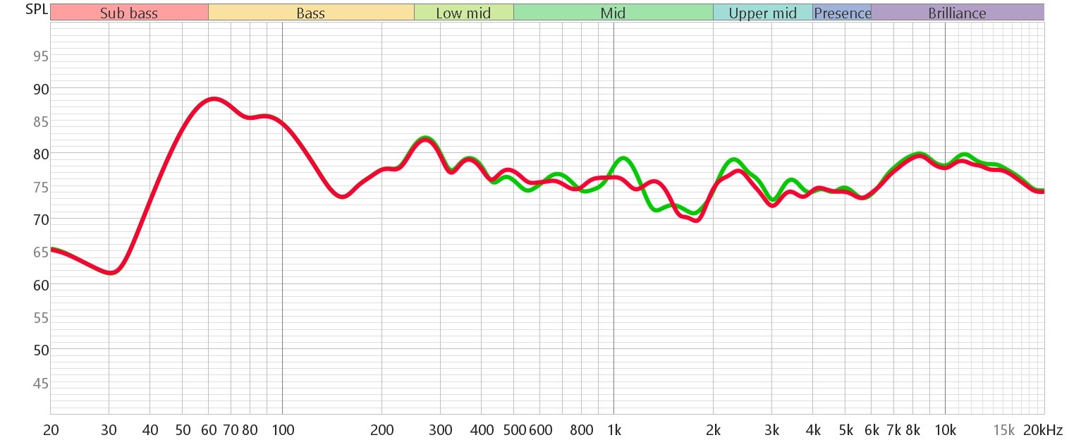

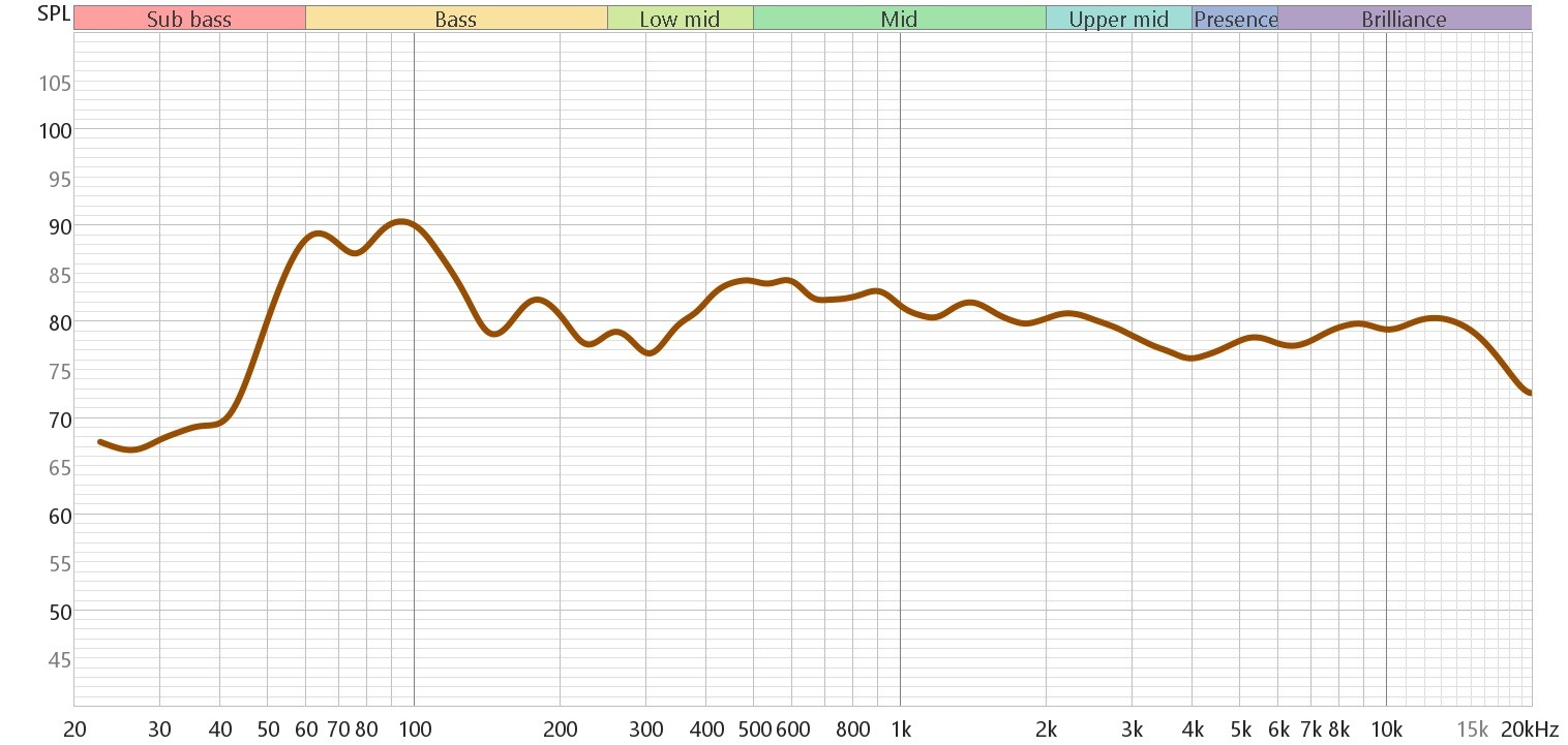

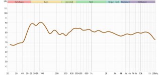

I added padding around the midrange and tweeters (RED is with pads) to see if the sound reflection and there was some improvement between 300 Hz and 1100Hz.. The slight decrease in the 2100Hz area is the result of an L-Pad change. There also is some flattening of the upper midrange 3000-6000Hz area. So changing how the midrange and tweeters are located should help. I suspect the dip at 1800 Hz is a bad crossover design I'll have to figure out what needs to change.
The bass area is not what I like. I expected with 2 10" woofers and 3.3 cu ft ported cabinet would yield deeper and flatter base.
The current cabinets has 2 round cardboard ports of approximately 2.5” wide by 15”. I haven’t measure them because they are covered by the diagonal internal panels. I suppose I could measure them somehow. How do I figure out how long they should be?
