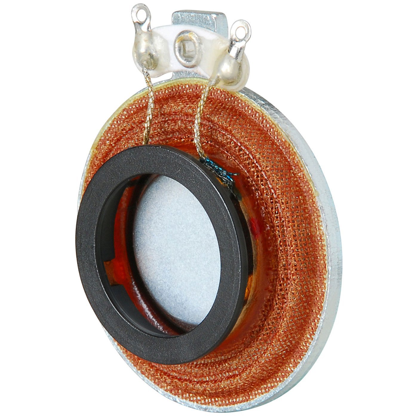

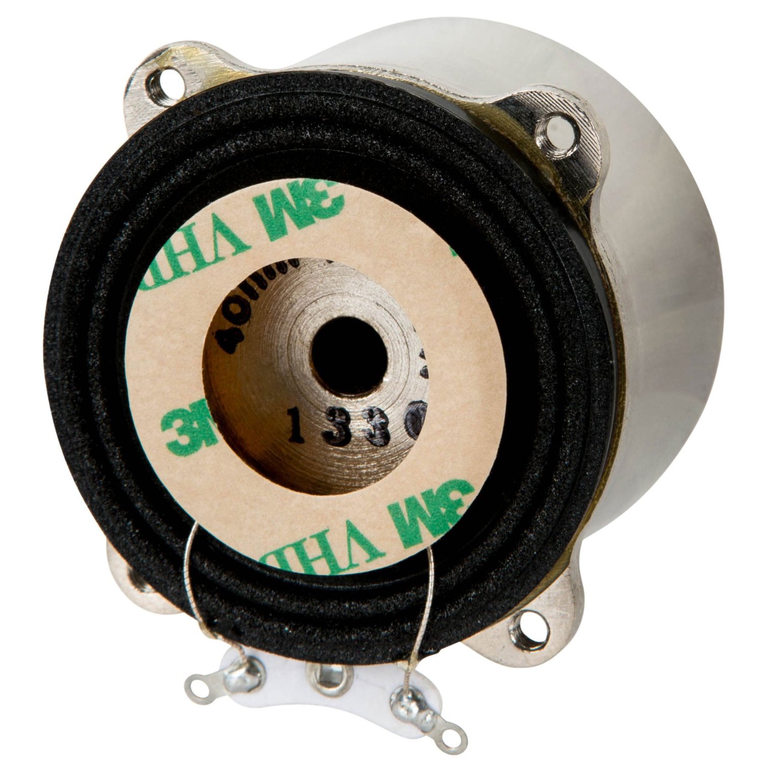

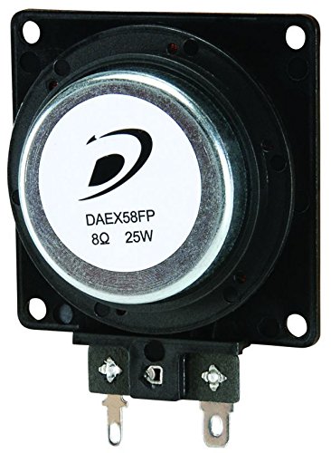

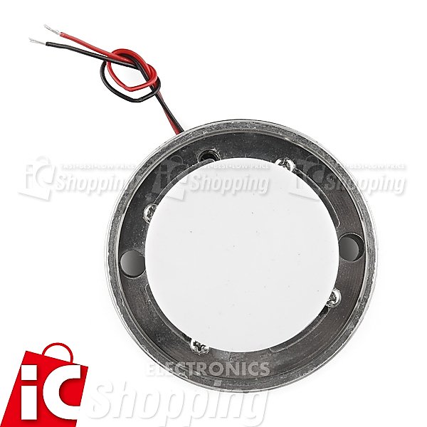

Woah! So many exciter to choose from! I'm a little lost here!
Here's a sample of the lot:
