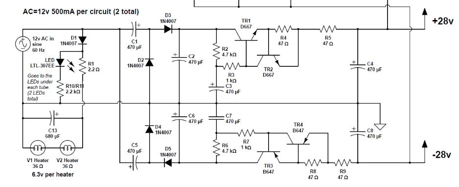

Anyway as to have dual voltage rails could be needed i have found this schematic attached that i like very much There is also filtering with bjts
( I dont understand well how to calculate the VDC out (here 28VDC) from VAC in (here 12VAC) But i will figure it out )
Any other usable arrangement to get dual rails from just one secondary ? thanks again

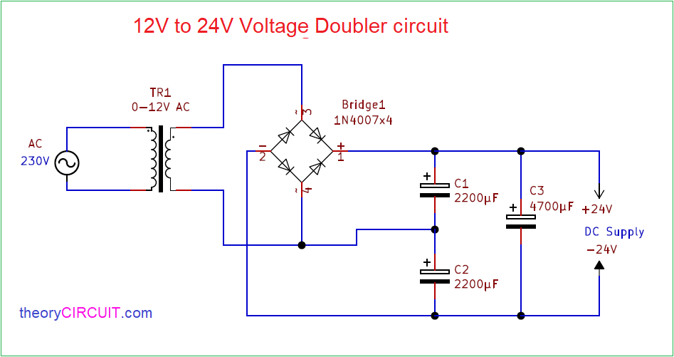

If i understand well to get a dual voltage suitable for +/-24VDC i should start from 12VAC
12VAC is a pretty common output for a mains transformer
I have found the case with a diode bridge even easier There will be a good filtering downstream

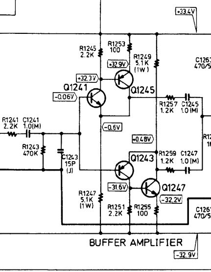

i have an old schematic that it could provide great performance wired as buffer or buffer with little gain ... are just two CFP made with complementary bjts
It was a TOTL preamp from Onkyo in the mid '70s .... i like its simplicity I will simulate it in the next days I think it could work also with reduced voltage

Your picture shows a complementary-transistors-pp-concept. (Important to distinguish from "classic" pp, which is a pp pairing with identical transistors (PNP/PNP or NPN/NPN). These sound less different than pairs of complementary transistors (PNP/NPN))
Your: One NPN and one PNP transistor per half-wave (+ and -). If you use two identical complementary pairs, both characters - these complementary transistors sound significantly different than identical transistors - can be found in each half-wave. This is more homogeneous.

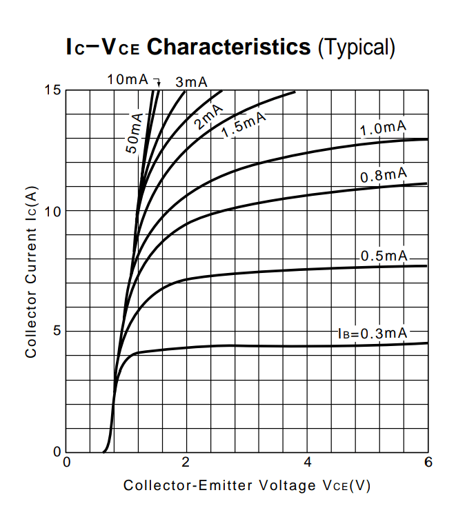

I would say not much Early Effect up to 5A.
Wouldn't you ?
Patrick
That graph is fairly useless for predicting the ripple rejection at an Amp or so, with constant Vbe, not Ib
LTSpice is also inaccurate for this sort of modelling.
Add to that, a Darlington is more temperature sensitive than a discrete pair as both transistors are at the same die temperature, so more thermal modulation.
