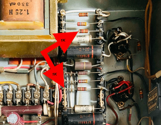

Originally I was looking to build something like the AirTight amp. I know the transformers wont be the same etc. I will look at the pictures and trace the schematic myself.

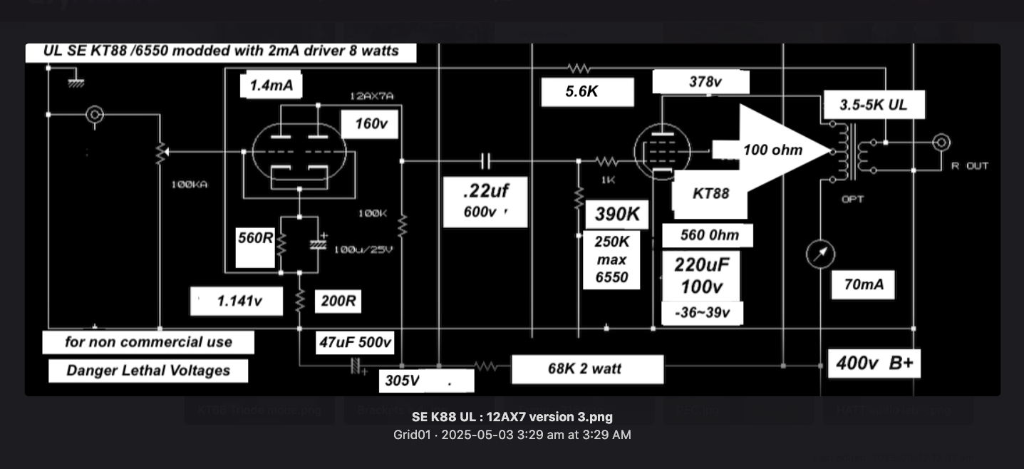

NO....... 12ax7 in parallel.

Brown Black Red Gold 1K 12AX7 x 2 SRPP very simple circuit and a 600 ohm cathode R on the KT88 and current is set , go look at the KT88 datasheet for Ultra Linear and from there you can determine the input voltage and operating point , ohms law will do the restJust wondering if there is a schematic of the Air Tight M101 floating around? I found some nice interior pics and could reverse engineer it if i had too.
Is it just a 12AX7 SRPP into a KT88 UL with some global feedback?
