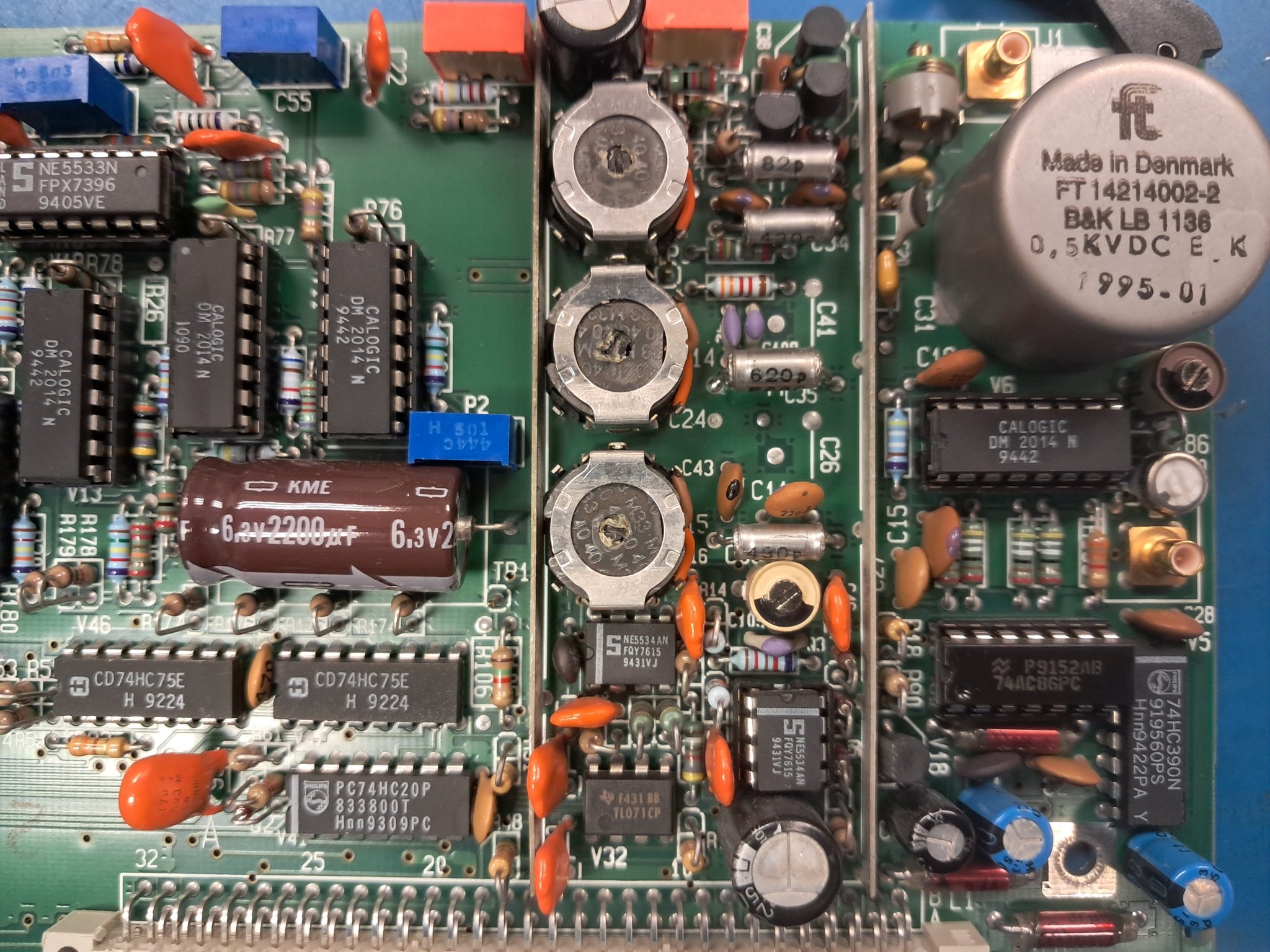

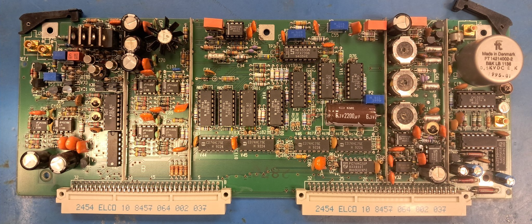

Here are the pictures. The first pic is of the whole Output Amplifier. The second one is the close up of the portion I am going to zoom in. The reason for this is because the output level changes only when I tweek the variac C3. I agree that the Calogic chip could be those you mentioned or transistor switches. I don't see any relays being used in the unit. I will look into the link you provided. And, no, I have not gone to the stage of looking for software/drivers yet.

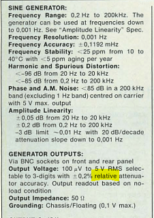

I just checked the specs on the 1051. The do not have an absolute spec. They have a relative spec which is pretty tight +/- .2% but no absolute spec. The silver cylinder is an output transformer. The section next to the output has 3 L/C low pass filters, probably to neet the harmonic spec. There are a handful of trimpots but without real documentation you could further degrade the calibration and accuracy. I suspect the instrument is in spec. (especially since they don't have one for output voltage). What is your application? Maybe this is not well suited to it.

Post 1 : I doubt the unit is "in need of repair". 0.981V is only 0.17dB down from the nominal 1V.
This small deviation can probably be explained by a damage of the 50 Ohms output resistor (OK,
this can be called a repair case). Instrument readout is "based on no-load condition". I am sure
you have the knowledge to check this.
My advice is not to touch any of the trimpots without having the full service manual.

I suspect the DM2014 is a Dmos switch. They are used a lot in that instrument. This is Calogic's current version of the same part I suspect: http://calogic.net/wp-content/uploads/2019/03/SD5501_Datasheet_Rev_A.pdf
I'm not sure what that transformer's function might be. A picture of the back side of the board and which connector goes to the main output will illuminate a lot.
