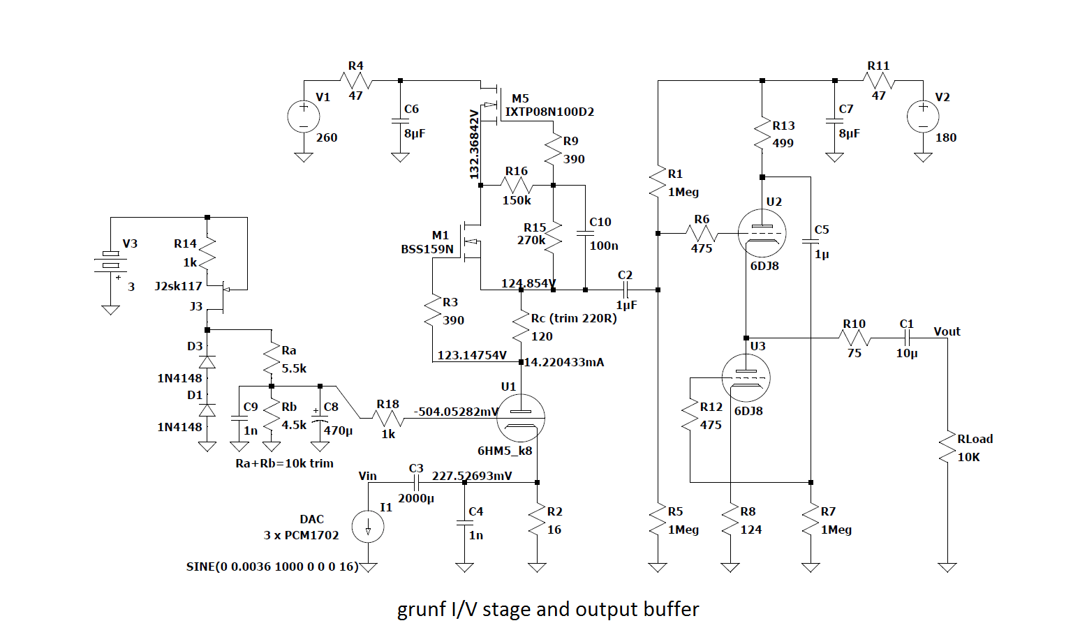

@nopants, as for the tube I/V stage , this is my last work and I think it's the best I've been able to get from tubes after many years of development.
After this I went back to semiconductors again but I think it can still be improved especially if the coupling capacitor between the DAC and the cathode is removed.
Sonically, it was by far the best tube I/V I've made. It is important that the signal is brought to the cathode, which makes a huge difference compared to all other tube solutions.
Reactions: 1 user
So in this case R_bias is just zeroing out whatever voltage the jfet settles at?
Yes, you have 2mA offset from TDA1541, R-Bias dials the J-Fet source with the DAC attached to 0V.
A servo CCS here may be a better choice for reliable operation, thermal drift etc.

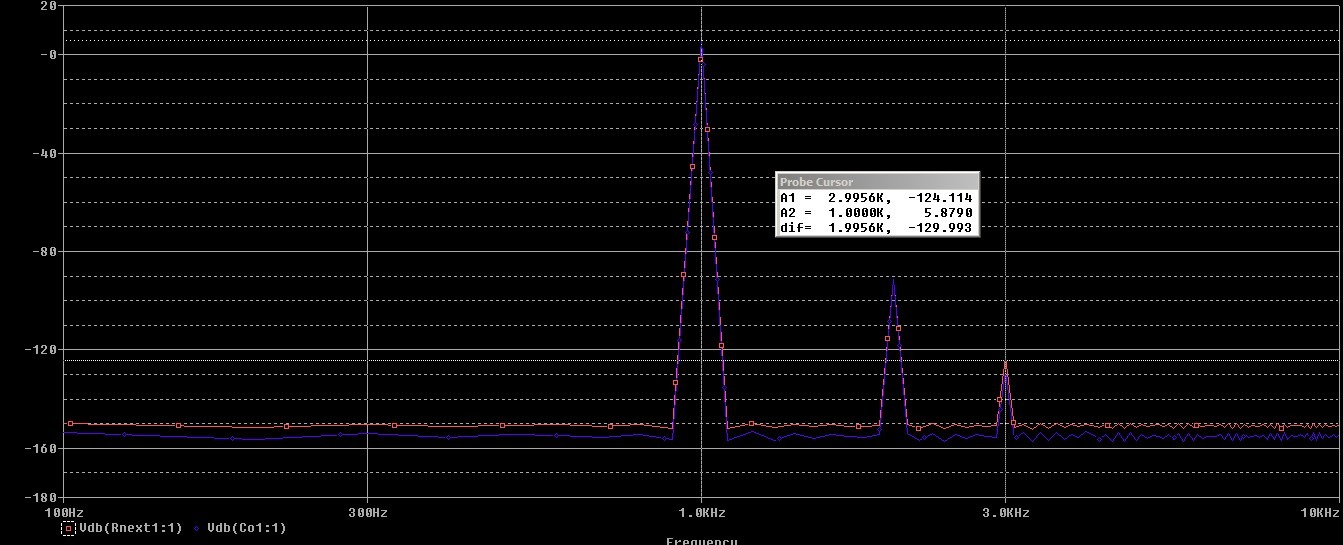

This is what is happening:
Green is coupling at the output with 10K Rin next
other are C between tube anode and high Rin of JFET buffer.
Schematic is in PDF
  • MV ground grid IV_compare.pdf

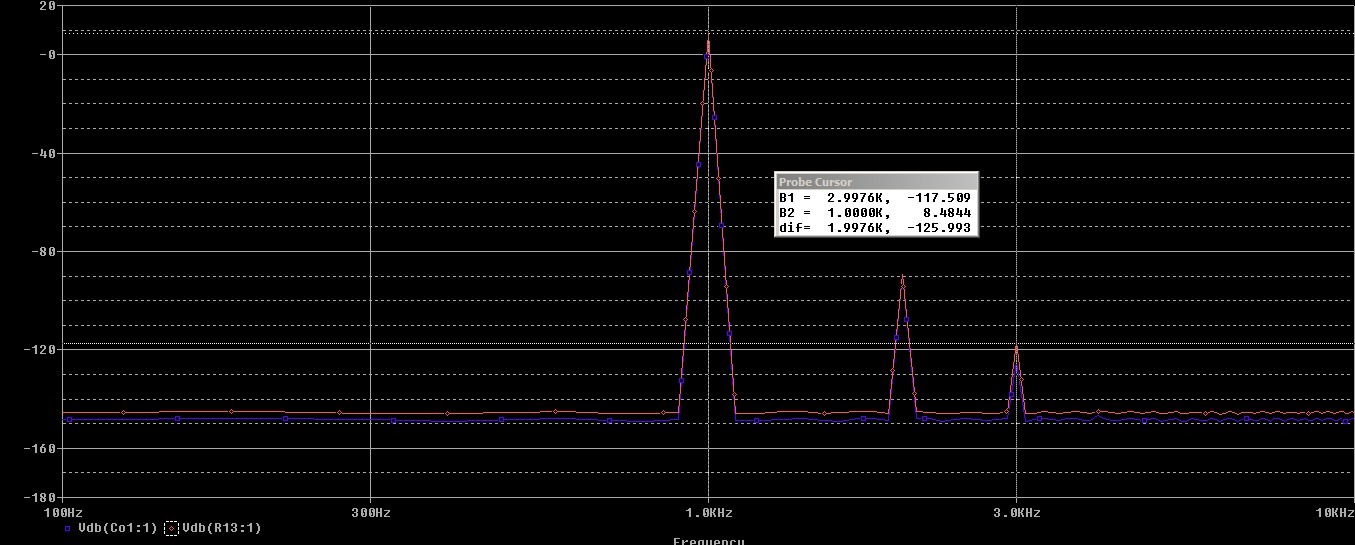

Also I tried 4 sections of ECC88 (2 tubes) as tube part. Russian equivalent is also good. This is about 50mA/V of transconductance because in parallel of 12.5mA/V typical ECC88 per section.
Result is not bad at all?
I just take a look at the prices on e-bay for EC8020 (S=60mA/V) high transconductance tubes - I was pretty shockedo_O. Please check...
So the 50mA/V for 4 x ECC88 sections are pretty afordable...
Maybe the 1.5V for the 2SK2394 JFET is just a bit from the knee? Should be better that not so close to the knee curves...
Very low THD. Consumption is about 53mA.
  • MV Zoran modif ECC88.pdf
