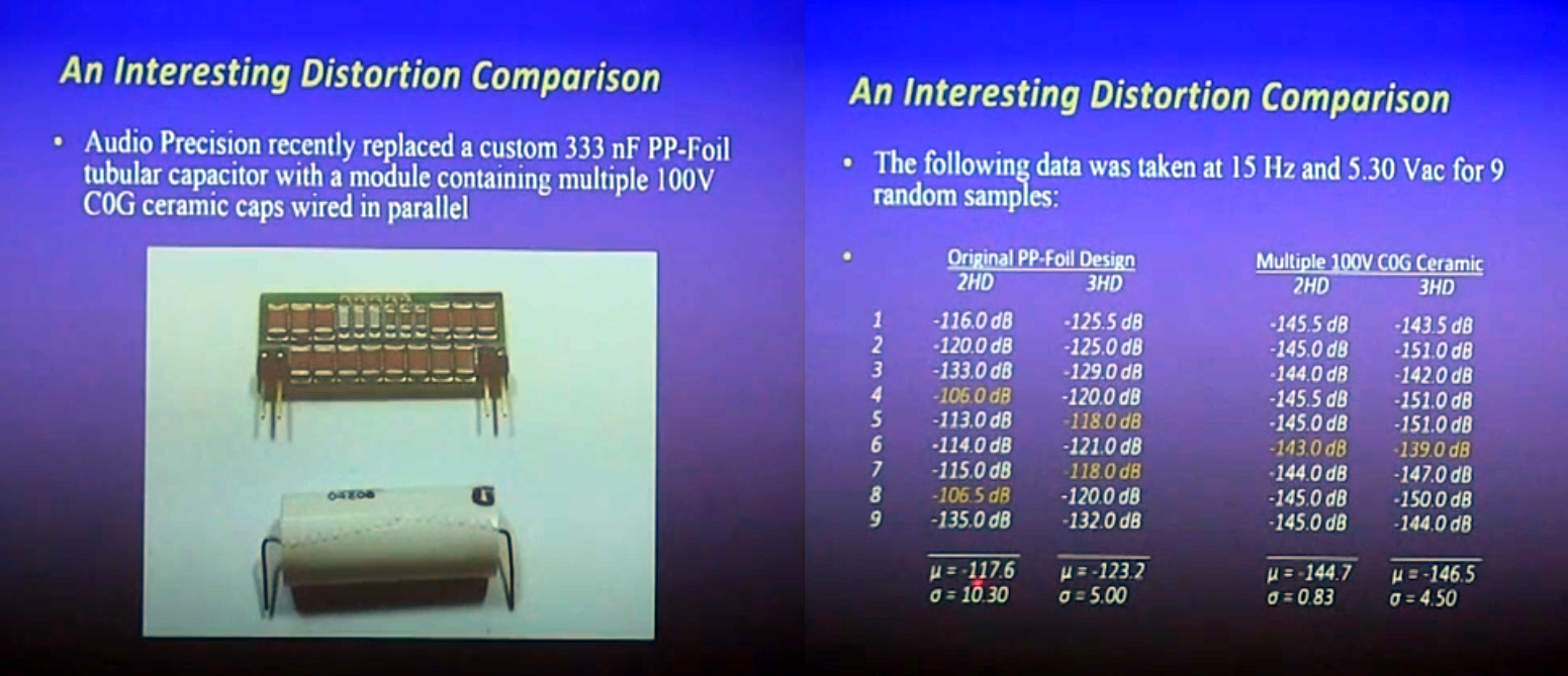

yet another interesting comparison : Measured Differences Between Capacitors for Audio Applications

Not knowing if other PE caps suffer the same fate, it looks like that cap might have some damage.
I also thought it interesting that Mr Hoffman was expecting the Teflon cap to be perfect: while Teflon itself is a fantastic dielectric, assembling it in a cap highlights some of the mechanical weaknesses of Teflon film, so tension is less and is more likely to have defects. There's more than meets the eye going from bulk properties to an assembled part.
