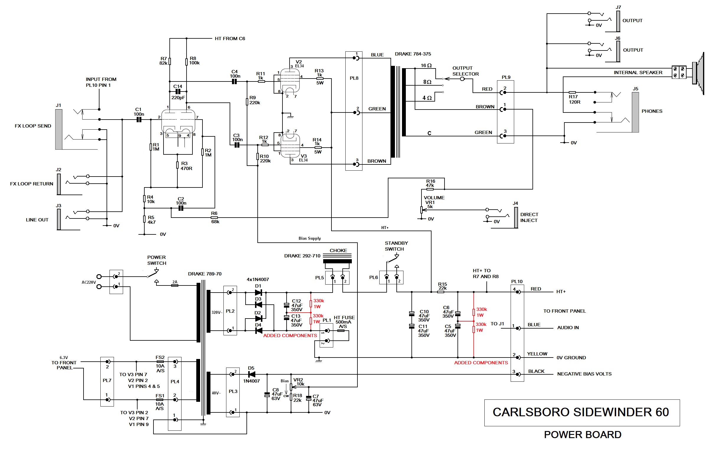

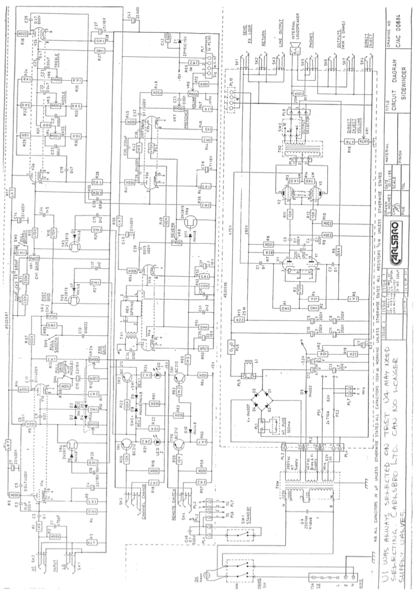

Carlsboro Sidewinder 60Watt All Tube Amplifier.
From my service manual. I suspect copyright is out of date now.😁
That's the hybrid one, the one I have to repair is all tube.
I have managed to reverse engineer the power board, I will tackle the front end circuitry when I have completed testing the power board.
Thanks for the reply, someone with the hybrid will be very grateful.

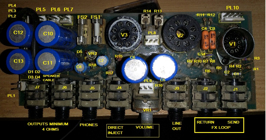

That said, the schematic posted by Jon Snell is not hybrid at all, signal parth is all tube end to end; Fets are used as audio switches,basically grounding not needed signal to allow selective 2 channel operation.
I bet you will find them once you get to the preamp.
That said, beutiful pictures and step by step troubleshooting :)
Apologies to Jon, the name of the amp fooled me, I can see valves at the front end but yet to remove it and get involved there. At least I won't have to spend time reverse engineering it and can get on with the servicing. Many Thanks Jon, I did receive an e-mail from Carlsboro today stating they have no circuit diagrams for any early equipment.
