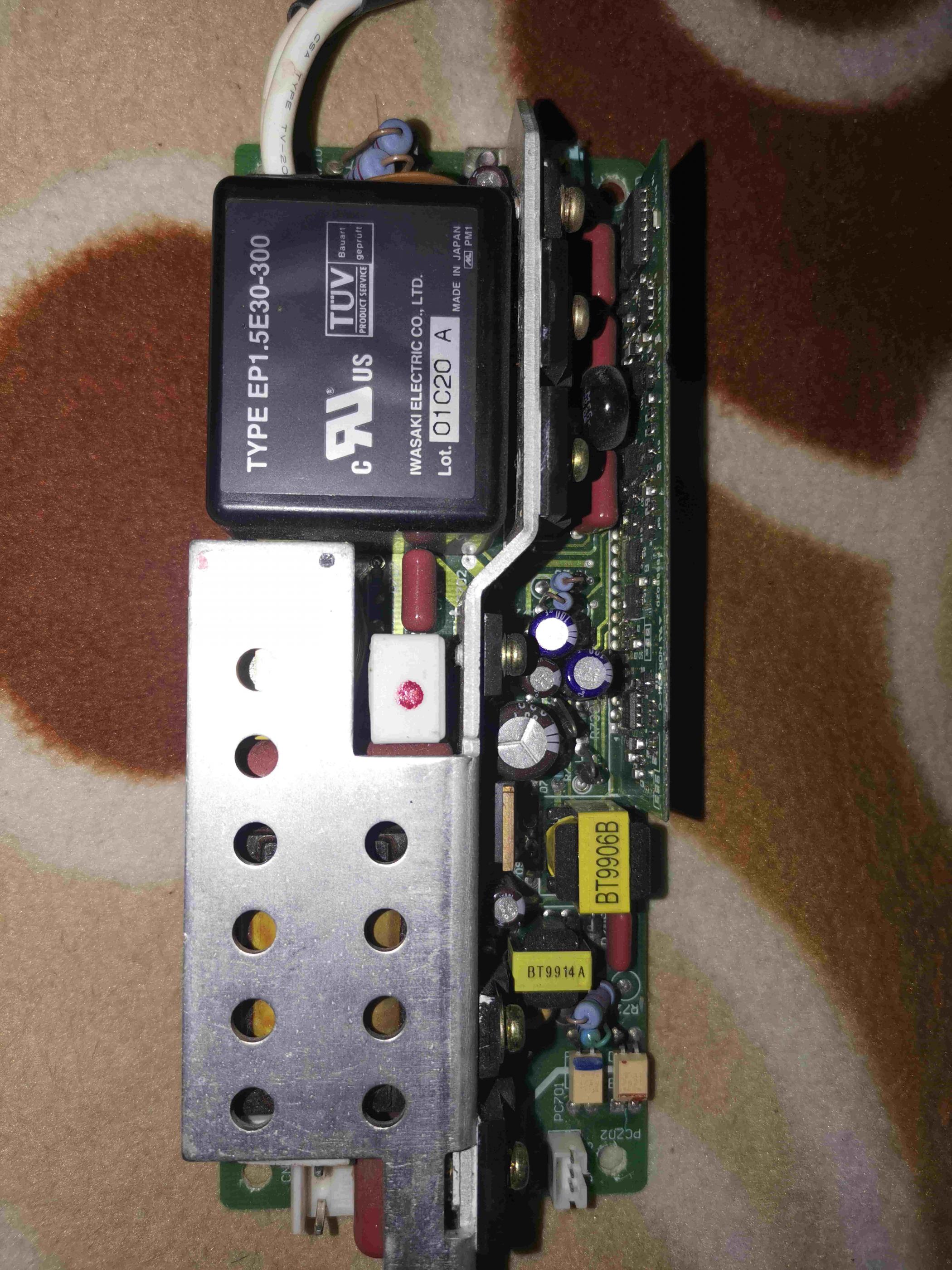

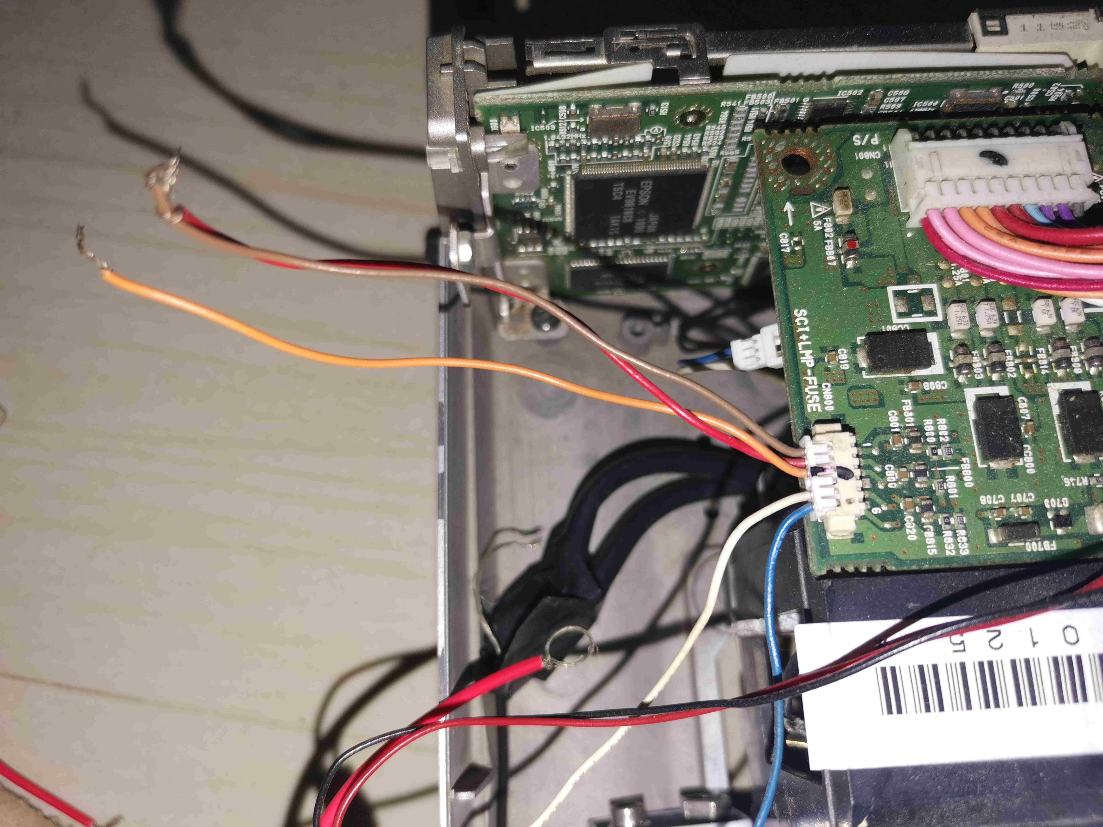

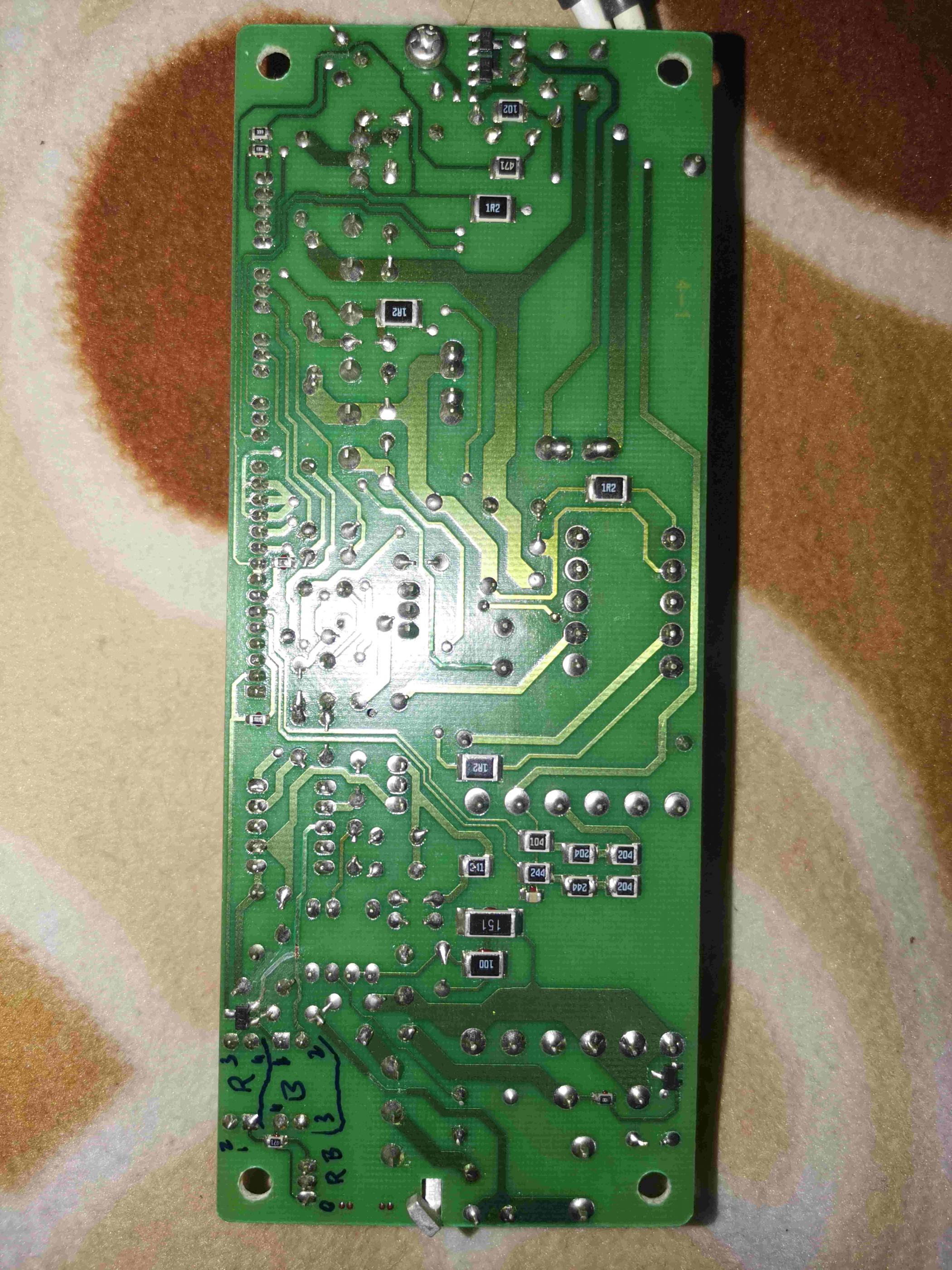

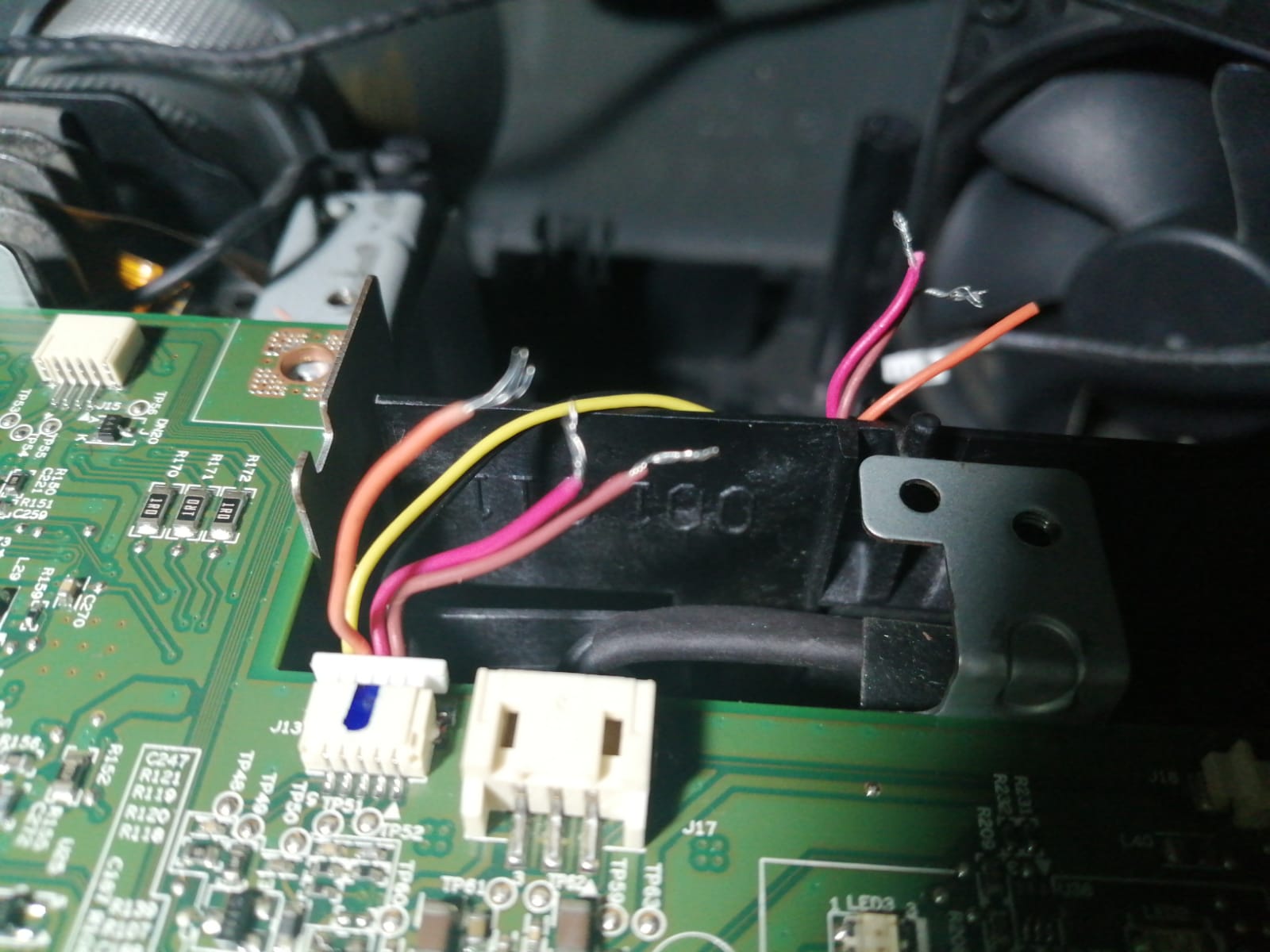

Require help in Bypassing Epson EMP 505 ballast
Hello Everyone,
I'm trying to replace the OEM UHE 120W Lamp(ELPLP14) with 100W LED for my EPSON EMP 505 projector. I am facing the problem in bypassing the ballast. I have read a lot of posts and watched a lot of videos in which bypassing was done by shorting wires that go from mother board to ballast(This didn't work) and in others OSRAM bypassing was done (I haven't tried this one, as my projector doesn't seem to fit into these models).
All the information I have is:
1. 5 wires come out of the motherboard in which two are connected to FUSE Circuit of the Lamp and 3 go into Ballast Board.
2. Three wires that go to Ballast:
- Brown = 5V ( it gets applied thrice for 2 seconds having the time interval of 30 seconds. Then lamp error occurs, If there is no Lamp)
- Red = 0V looks like ground
- Orange = 2.71V (This seems to be the input to the motherboard from ballast)
3. I have taken out ballast and then shorted Brown & Red wires, then tapped the Orange wire to the Ground/Red when the 5V voltage showed up in Brown wire. This made the 5V supply in the Brown wire stay on for 20 seconds(which normally stays ON for 2 seconds). After 20 seconds, Power light and Temp light were blink in red color (According to manual it means "Circuit Malfunction").
At present I don't have the original lamp to check how it ideally works. It will be a great if anyone can help me solve this problem.
Photos of Ballast, Mother board and other related are attached.
